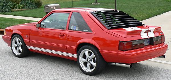

I have the Cobra brake kit (part# 2300K) on my '89 with 17x8 Bullitt wheels. They fit perfectly.

Very nice looking car. That is the look and response I want. Are your Bullitts 17X8 or are the 17X9? Just wondering. I'm in the process stripping and refinishing mine. Gonna take out a few small scratches and polish lip and repaint then clear it all.

Mine are 17x8. They are the same wheel used on the '01 Bullitt except the spokes are silver and the lips are polished. They were from Ford, but they no longer make them.
