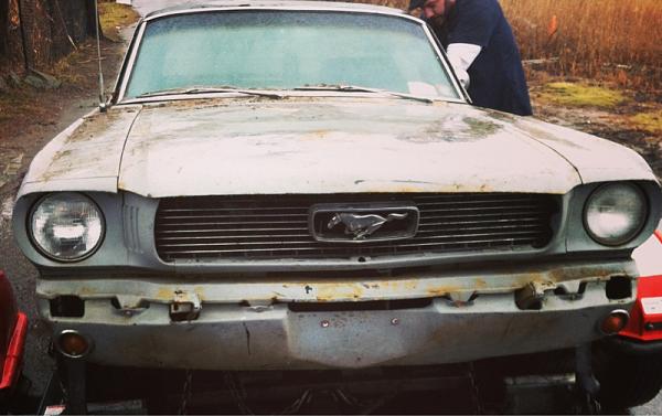

UPDATE: bought the '66. Motor was not seized and turned by hand, which is great news. Quarter panels need to be replaced (rust and bondo), interior needs to be fully restored, not sure what condition the tranny is in, etc. And so it begins....
