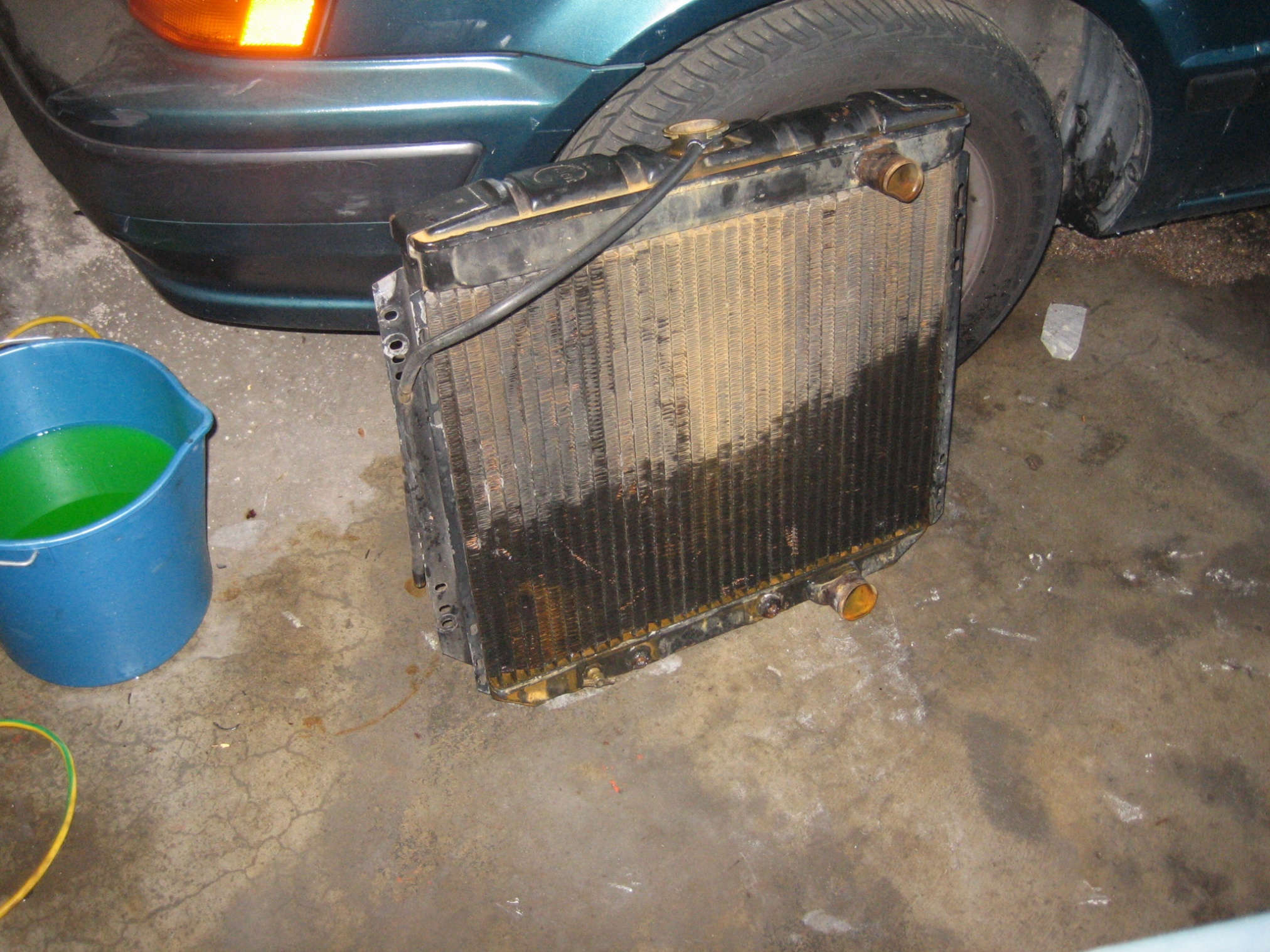

Ok so the radiator has finally arrived and I am preparing to put it in. So here are the pics of the original radiator out of the car and the engine bay. Also on a side note can anyone chime in if that's a clutch fan in the picture?

Hmm, that looks like a 24 inch radiator? The link from CJ Pony parts showed a 20 inch radiator. Did you get the right one?
CJ Pony parts has good prices on their radiators. Do you like the one you got from them?
I'm thinking about putting a 24 inch radiator in mine since the summers down here are so hot. I need to be able to drive this car in the summer.
That does look like a clutch fan to me.
No it's a 20 inch. I already put the new one in and it fit perfectly. The kit I bought from CJ's was great had everything I needed minus a few parts which I bought at a local auto parts store.

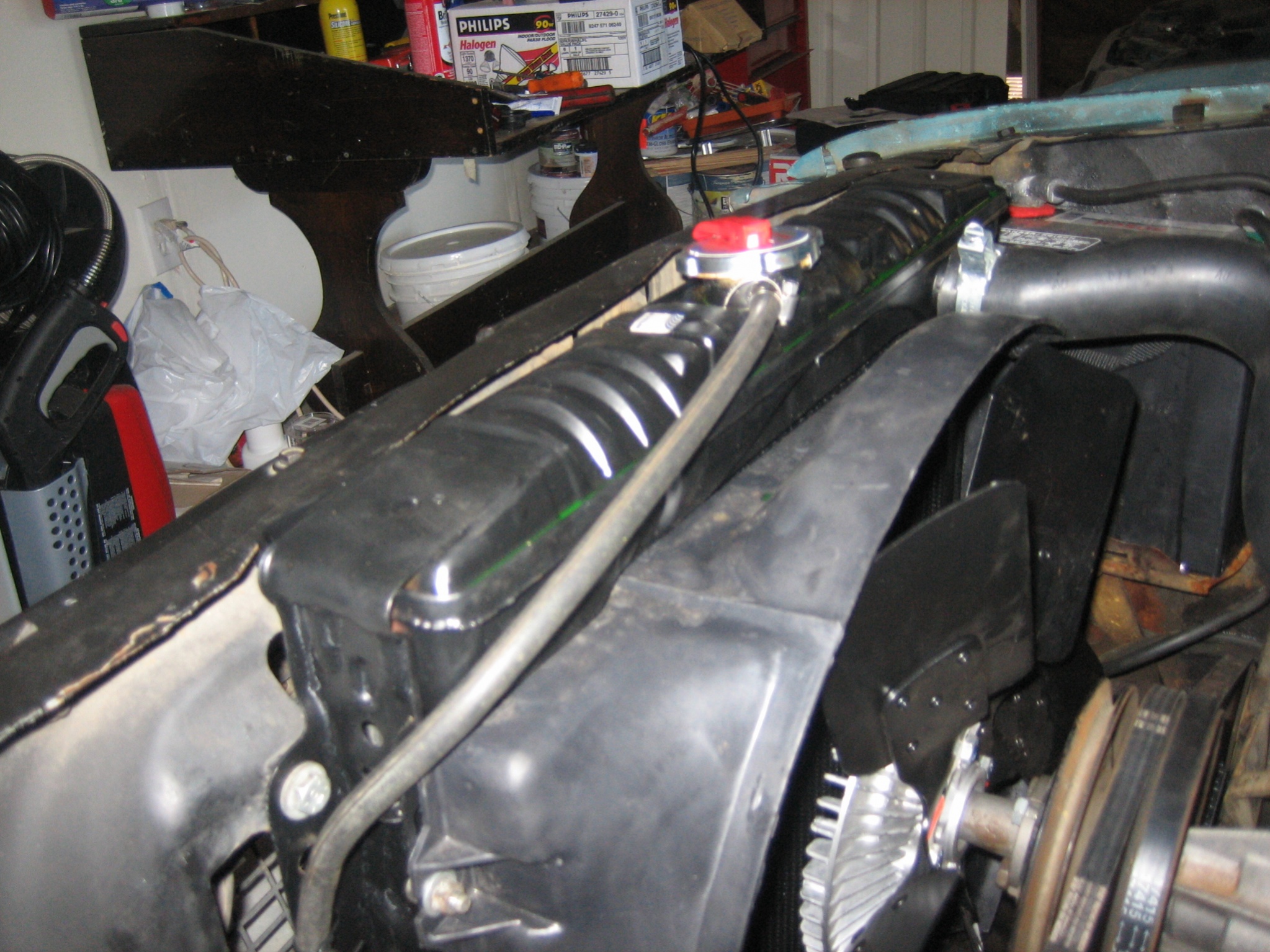

Here are the pics please excuse the coolant around the base of the radiator, apparently I missed the hole
Attached Thumbnails Radiator-radiator-finished.jpg   Radiator-radiator-new.jpg

Looks good! How does it cool? Is the fan new as well?

As for the fan it is new it came with the car when I bought it and was already installed. Also already had a new water pump as well. So every cooling component is new as of now .
