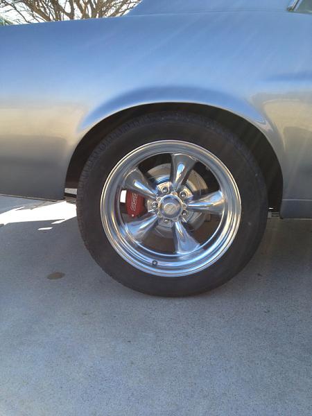

I just got my SSBC kit put on my 67 and I love it, got them all the way around with red calippers ( front ones are huge) I'm not gonna lie they are a bit expensive but upgrades like this are definitely worth it, now I'm not afraid to brake on the highway @ 70 mph. And wonder what direction my car will divert

Those calipers look cool. I fully understand the importance of the braking with discs. Until I can afford it it will be drums for now. A project after she is running i expect. I allowed extra length on the replaced brake lines especially for that reason in case I had to move them.
