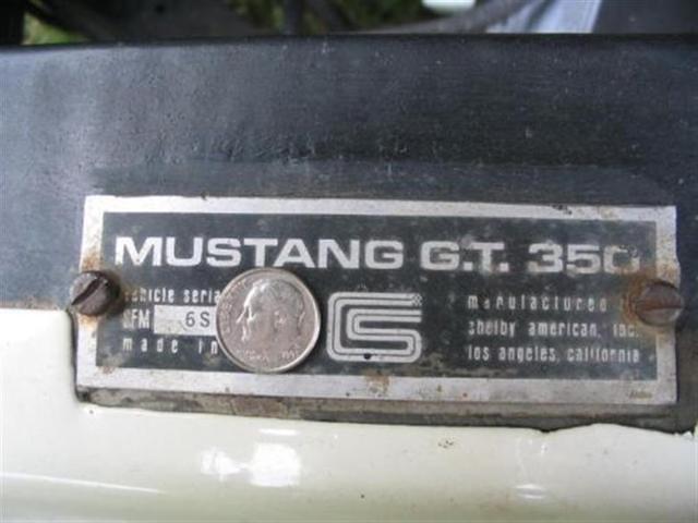

This isn't a good sign. The VIN plate should be riveted. Red flag and a turn-off.

This does not look good. If it a one-owner car, where is the original engine??

FAKE

Seems like a rough cutout where the vin is screwed in, the vin plate on all the Shelby's I've seen we're on the driver door above the door latch and riveted (just like regular mustangs) not in the engine bay. I mean yea there's a vin on the passenger side but not an actual vin plate like shown, it's stamped... Idk I'd go look at it to make sure and ask the seller for full vin number and search it up, lots of money to loose if faked like it seems.

There is supposed to be Shelby American VIN plate located on the top of the left side inner fender lip, so the photo provided is indeed correct. The rough cut-out is fairly typical, but usually they're more sharp edged. The one pictured seems like it's been bondo'd.
The screwed on VIN plate is the red flag. VIN plates on all cars are riveted for obvious reasons.
