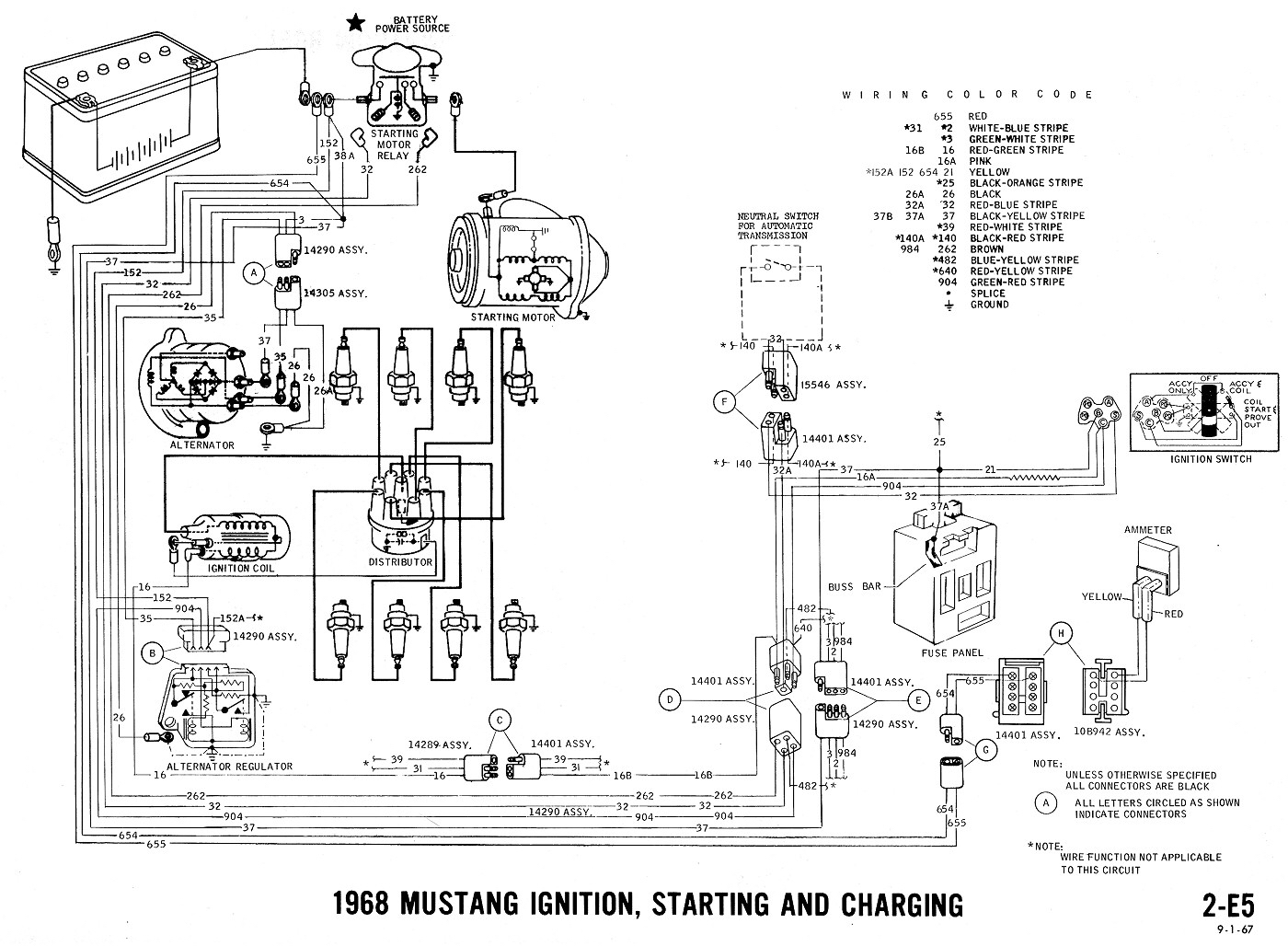

Hmm trace all your ignition wires make sure they are intact and not shorting out looks like 4 wires

Is it auto?
Old Jun 27, 2015 | 11:06 PM
68fastbackhansen's Avatar
Joined: June 23, 2015
Posts: 7
Yes it's auto
Old Jun 27, 2015 | 11:25 PM
YepItsGreen's Avatar
Joined: May 25, 2015
Posts: 317
From: Alabama
No power to ignition
Could be the safety switch try putting it in neutral
Old Jun 27, 2015 | 11:55 PM
Posts: 317
From: Alabama
One way to check would be wiggle the shifter a little as your turning the ignition while its in park I don't know if you can bypass it with a fuse like on a manual to diagnose the issue
