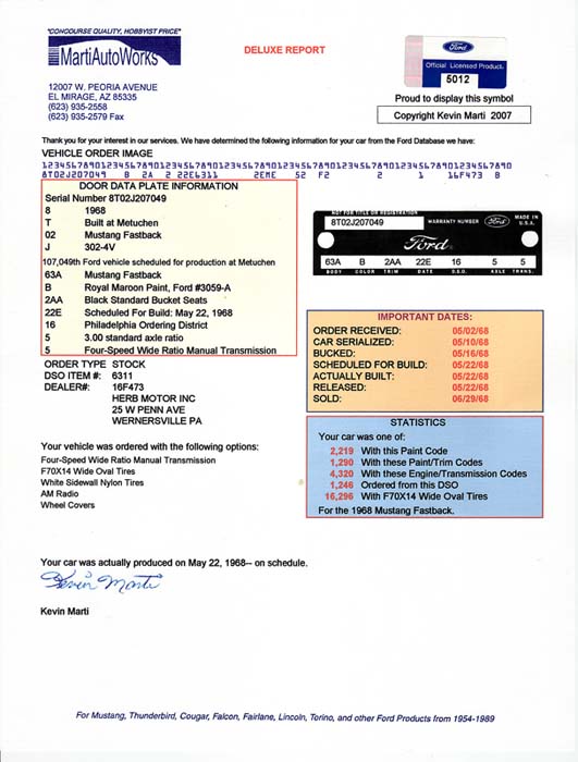

I have a copy of my Marti Report, if my car is in fact a true GT car, would that say on the Report?

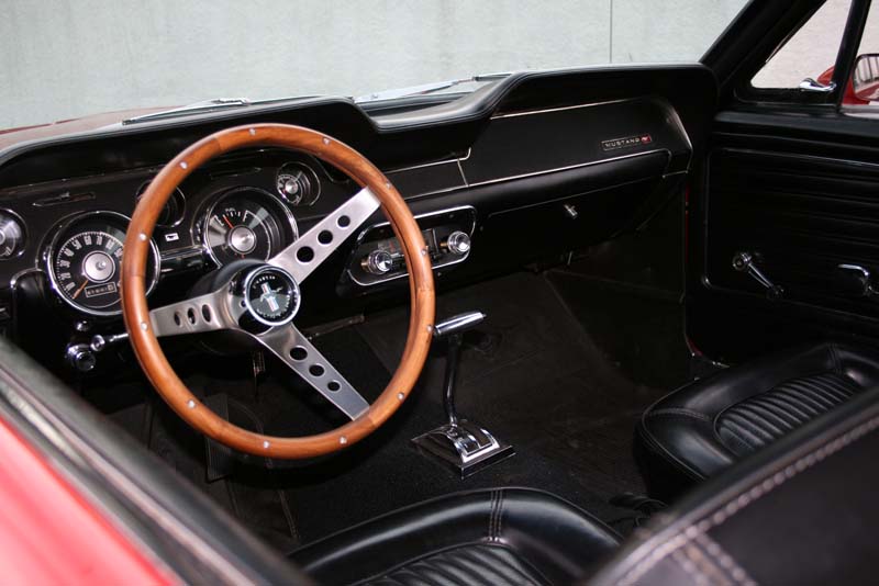

I looked at your exterior pics. It looks correct to me with the exception of the wheels which I assume were replacements for the originals. Do you have any interior pics?

Not all GT's came with disc brakes,,,,but the marti report would say "GT Equipment Group" if it was a real GT Sorry

Your car per the Marti Report is not a GT....and not all GT's came with Disc Brakes. I have a '68 GT Coupe and have the marti report for it....it reads "GT Equipment Group" but was a manual drum brake car...if it had Disc brakes then it would show "Power Front disc brakes" on the report.
Yes, when I bought the car it had the styled wheels with GT hubcaps.
Interior picture taken this summer...
I´m getting the feeling that my car isn´t a real GT

Your Marti Report also states that the car came with wheel covers.....if it had been a GT then it would have listed Styled Steel wheels....Wheel covers are standard hubcaps and did not come on the GT models.

ahhh... ok, ofcourse didn´t think of that, thanks!

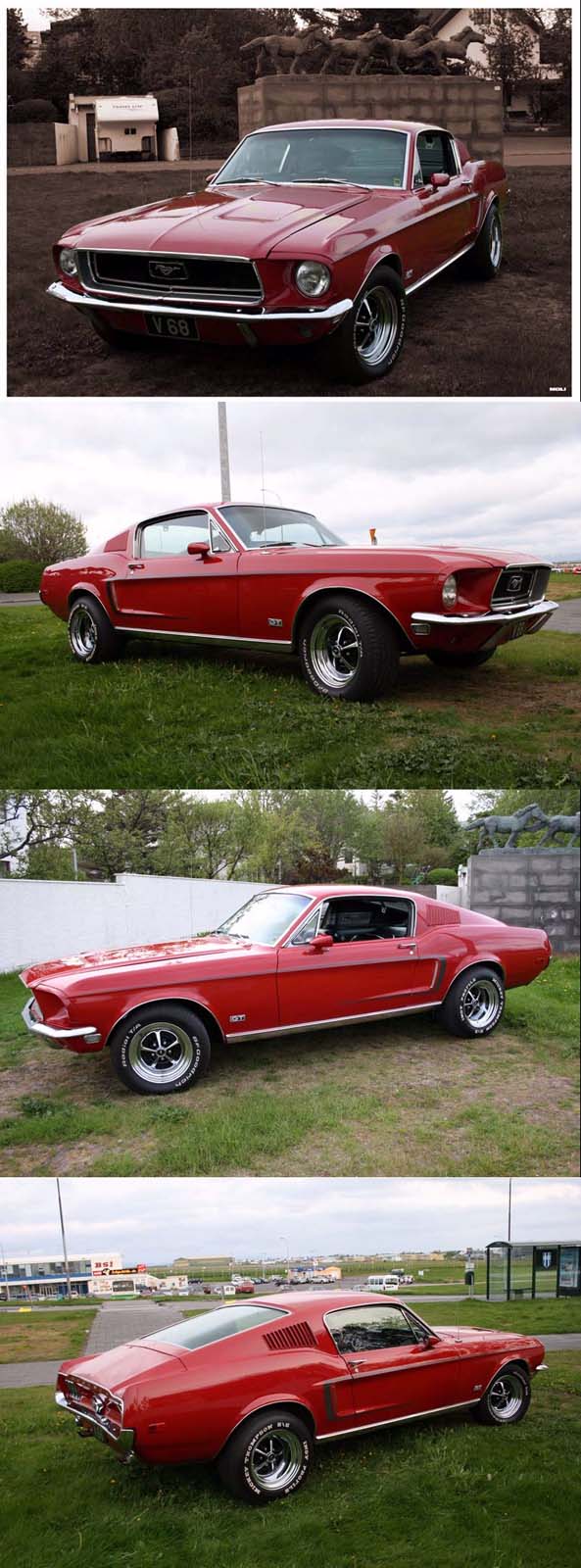

Anyway.. here are some new pics of the car, just wanted to share.

nice car.

It is a nice car....don't let the non GT factor disappoint you though....Fastbacks are tough to find and that is a nice one. This is a good example though of why it is good to have the Marti Reports...so many cars end up changed over the years that it's nice to have a historical record of what they came with from the factory.
