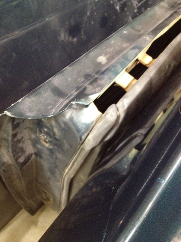

Also be 100% sure you have them on right. Here is a pic of my original. The elongated end goes to the front near the hinges. They also have to face the right direction.
