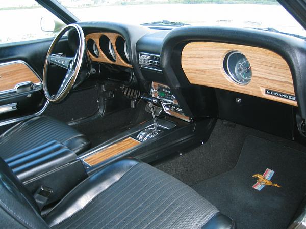

Stock in-dash AC was available in '69 and was designed to fit correctly behind the dash, glove box and clock. I've included a pic from a past '69 of mine that shows what a true AC interior looks like.

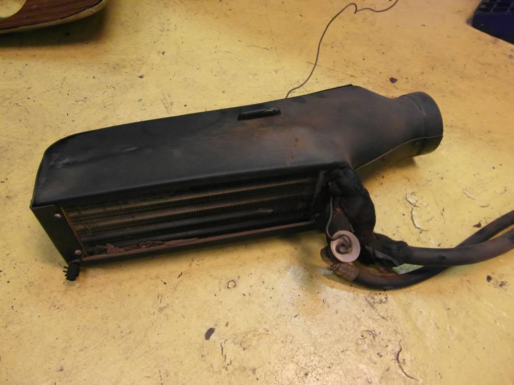

started working on the car today, took out the engine, and interior, including the dash pad, the compartment behind the clock was indeed filled with the condensor!
because it was a later addon I decided to keep the A/C out, and put the clock back where it belongs!
