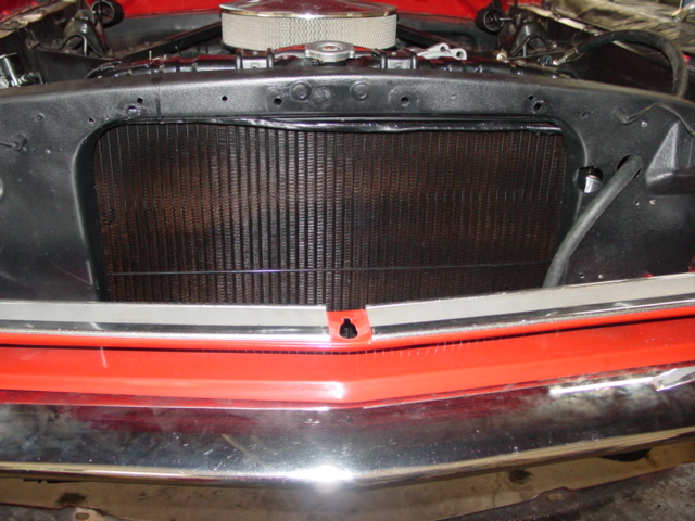

I'm having a 24 inch radiator put into my 65 Mustang in the place of the orginal 17 inch wide one. The car gets hot in traffic since it isn't getting enough air flow through the AC condenser, and the radiator. I'm hoping that going to the wider radiator will help with that. I'll post some more pics when I get the car back next week. (Bottom two pics)
Here's what one called by the name of "Mustang Steve" did to his 65 Mustang. I think it looks really good!
Attached Thumbnails 24 inch radiator in a 65 Mustang-65-mustang-24-inchradiator-3.jpg   24 inch radiator in a 65 Mustang-65-mustang-24-inchradiator-2.jpg

OK, I got my 65 Coupe back with the 24 inch radiator in it. They did a good job over at Mid Cities Mustangs, it looks dead stock if you didn't already know your way around the engine bay of a 65.
It wasn't very hot today so I wasn't able to give it a good test, but if it doesn't work I don't know what else to do.
Anyways, here's some pics!

Just back from a test drive. The car still gets hot! It's not as bad as it was was, but with the AC on the temp still creeps up at a stop light.....
It was doing pretty well at first. I took it to the car wash and it didn't get over 190 even at a stop light. But, I think the heat gets built up in the engine compartment because it has no place to go.
Not sure what else to do. I have a different shroud on order that should fit tighter around the fan, but other then that I'm not sure what else to do.
