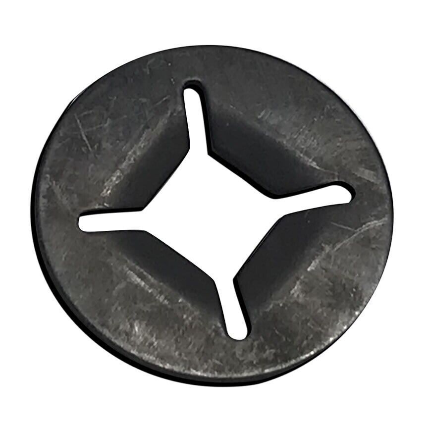

just in case: when you got the new tires, did you also get new wheels? or did you put the new tires on the OEM wheels?
Asking because: some aftermarket wheels do not have the recess around the lugs, that provide clearance for the washer-clips that are used on the assembly line to hold the rotors on. Then the wheels sit up on top of those washers and can cause the wobble that you describe. If you do have aftermarket wheels, remove the washer clips from the studs. If you have the Ford OEM wheels, then this is not the issue.

I Learned About Tinnerman Clips Back in The Mag Wheel Days! Yep They Can Cause Issues!

Yeah, OEM wheels... what's weird is that three different shops haven't done this right.
So true. I had this issue with my very first aftermarket wheels....removed the darn washer-clip and problem solved.
