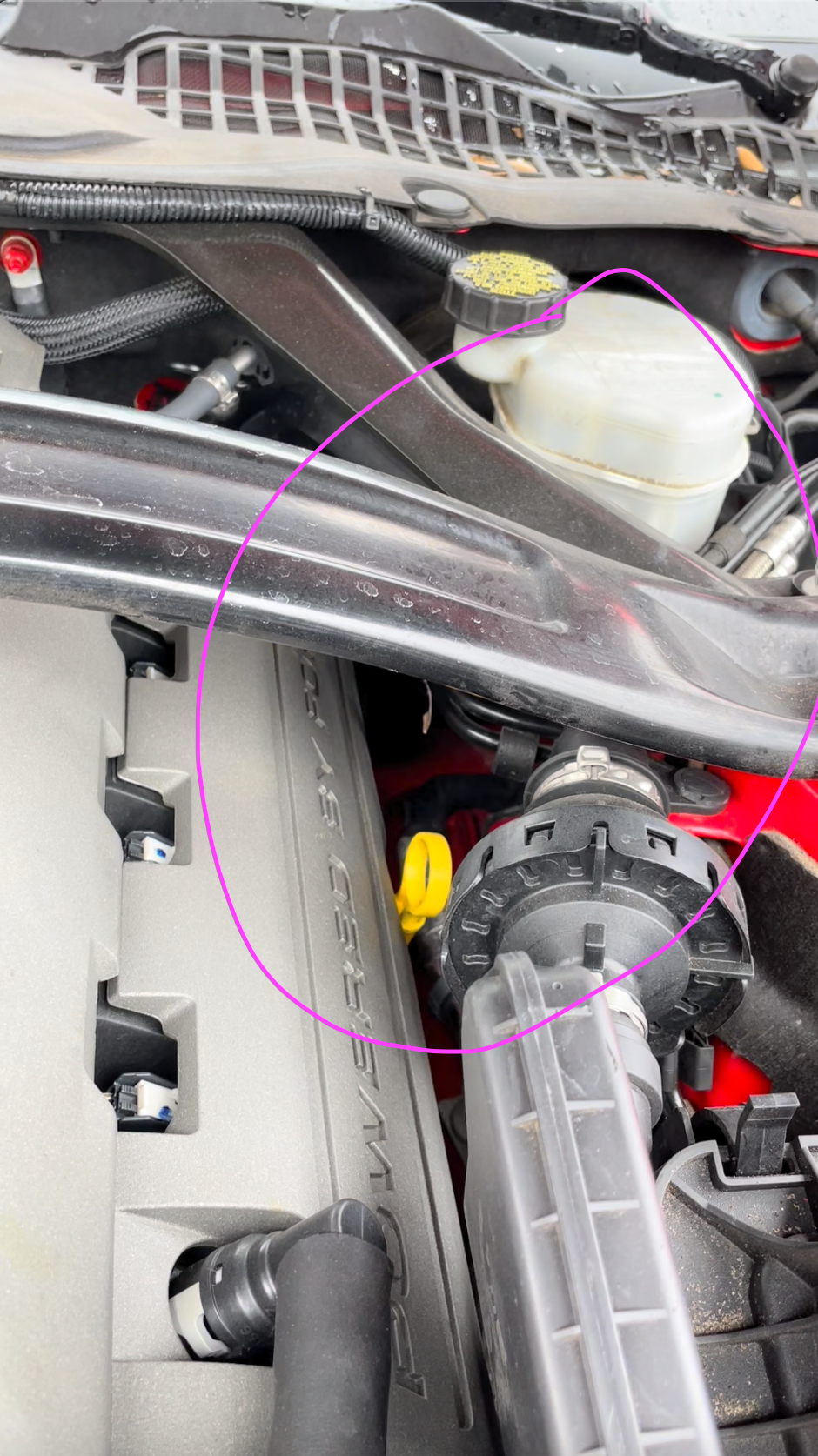

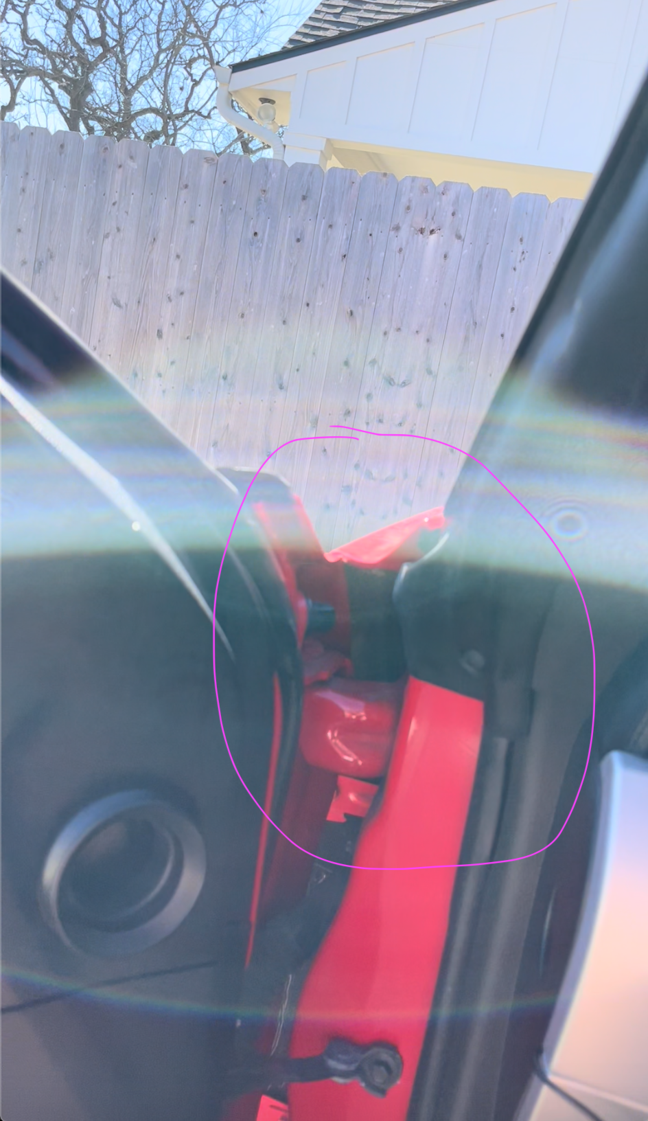

Here's where the smoke is coming from looking from inside the car. It's hard to see the smoke in this picture, but it's there. This smoke also comes out of my AC vents as well.
Here's another picture of where the smoke is coming from with the hood open. It is coming from the driver seat side of the hood. It's hard to see in the picture as well, but it's there.

Could it be coming from a leak in the brake(clutch) fluid?
Check to see if there is anything on the bottom of the white container in your circle. Check the hose as well. Possibly a small crack, split, pin hole or something like that only leaks when under pressure. I had that happen on my 2004 Jeep Grand Cherokee's power steering, Pin hole in the hose, it was a tough one to find. Did not leak enough to notice much change in the levels. It would send a small shot of fluid across the engine when under pressure. Just happened to check with a pressure test and wa- lah, there it was.

could have something to do with the sound piping to the cabin?
