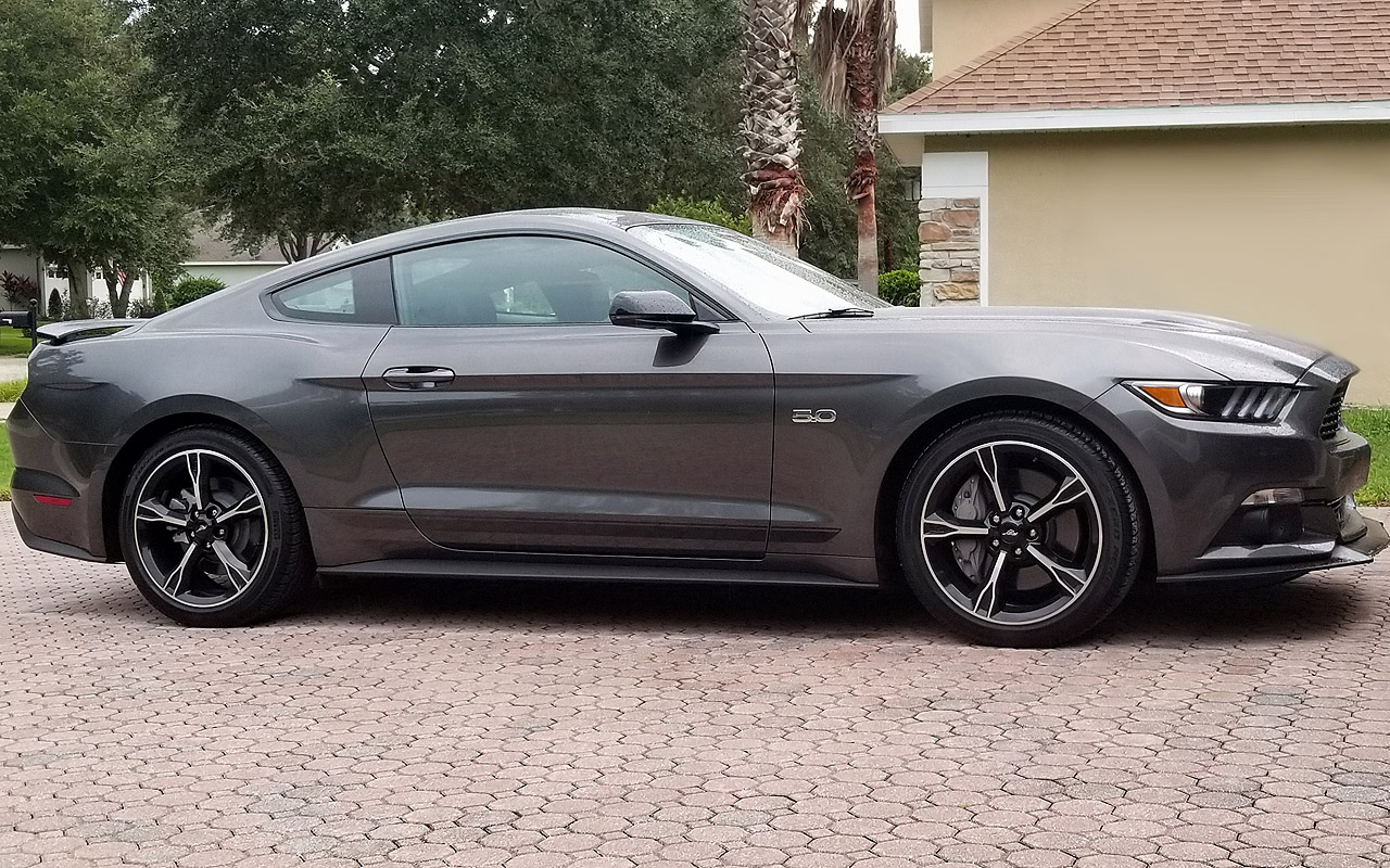

I purchased a 2016 GT California Special last week. The car had 5k miles and I think I stole it for the price I paid. It came with a few mods that I wasn't able to get any information on during the purchase, but learned afterwards. It has a Livernois Motorsports Windstorm CAI. Today, I put the car on the lift to find out what was going on with the exhaust and found it has the American Racing Pure Thunder cat back exhaust, but without the H pipe. The H pipe was replaced with straight pipes.
My questions relate to the warranty. The dealer I bought the car from "guaranteed" me that the warranty is fully intact. Does this combination require a tune? If so, would a tune for these mods void the factory warranty? Lastly, anyone familiar with this combination know if there are any hp gains? My son says the car feels really strong compared to his 2014 GT. He has 3.31 gears and this car has 3.55, but the CAI and the exhaust might be making it even better. Thanks for your help.

Just an update...I ended up returning this car to the selling dealer because I found it had body/paint work. I also tried removing the CAI to install in the new car I was going to get, but couldn't. I removed it, installed the factory air assembly, and took the car for a drive. It stalled 3x trying to pull out of the garage. At the end of the driveway, it stalled when putting it in gear. Tried accelerating and the car stumbled and seemed like it was in limp home mode. It drove REALLY bad. So, I went home and put the Livernois CAI back in. The car ran fine. That tells me the car has a tune and couldn't run with the airflow from the factory box. This was my concern when buying the car.
I told the dealer I was returning the car because of the paint and body work and the tune. By not knowing what tune the car had, was 87 octane hurting the car? Who knows? I bought a 2017 GT with 50 miles on it. I now know that this car is under full warranty and any changes done to it are done by me!
