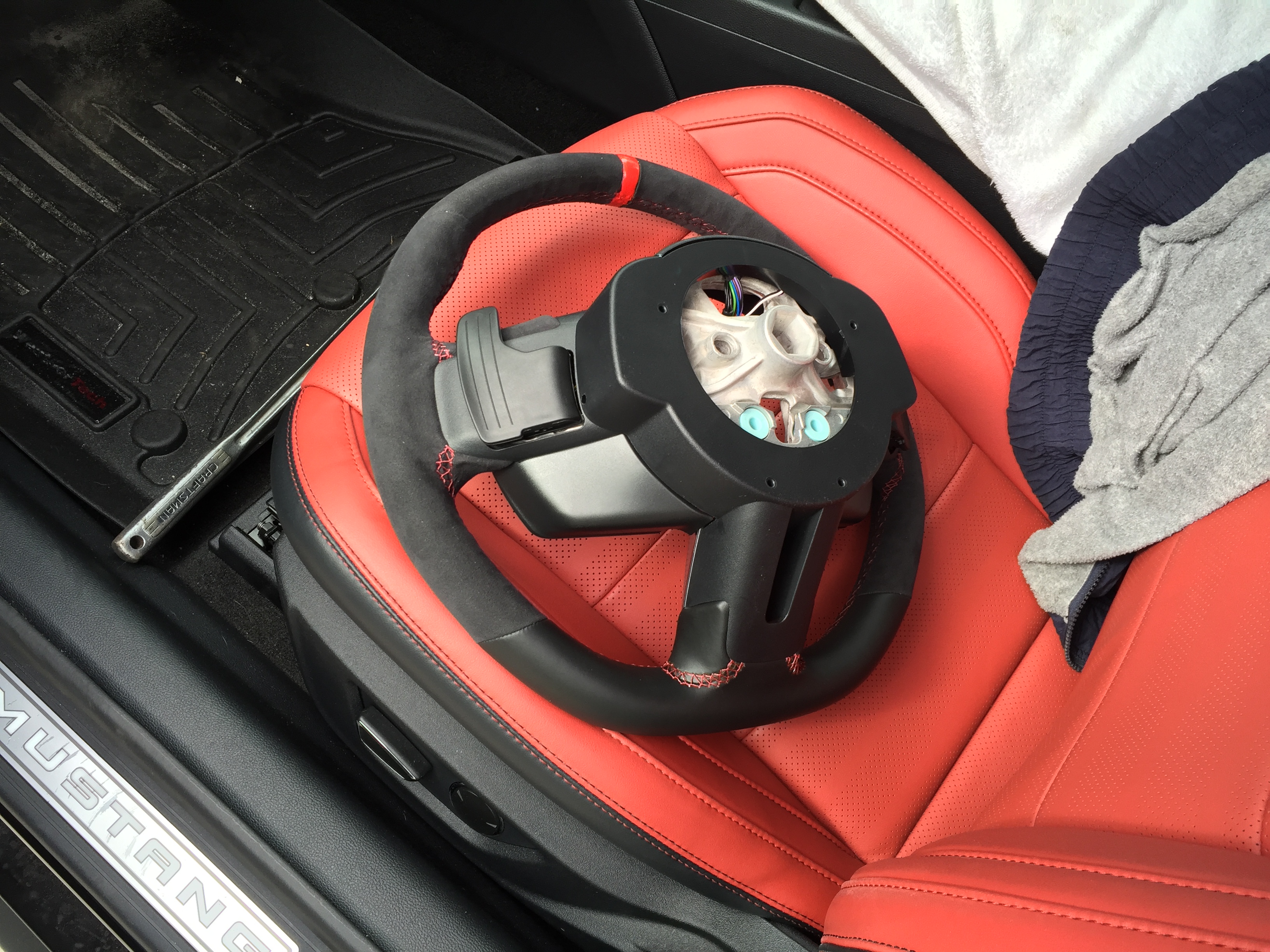

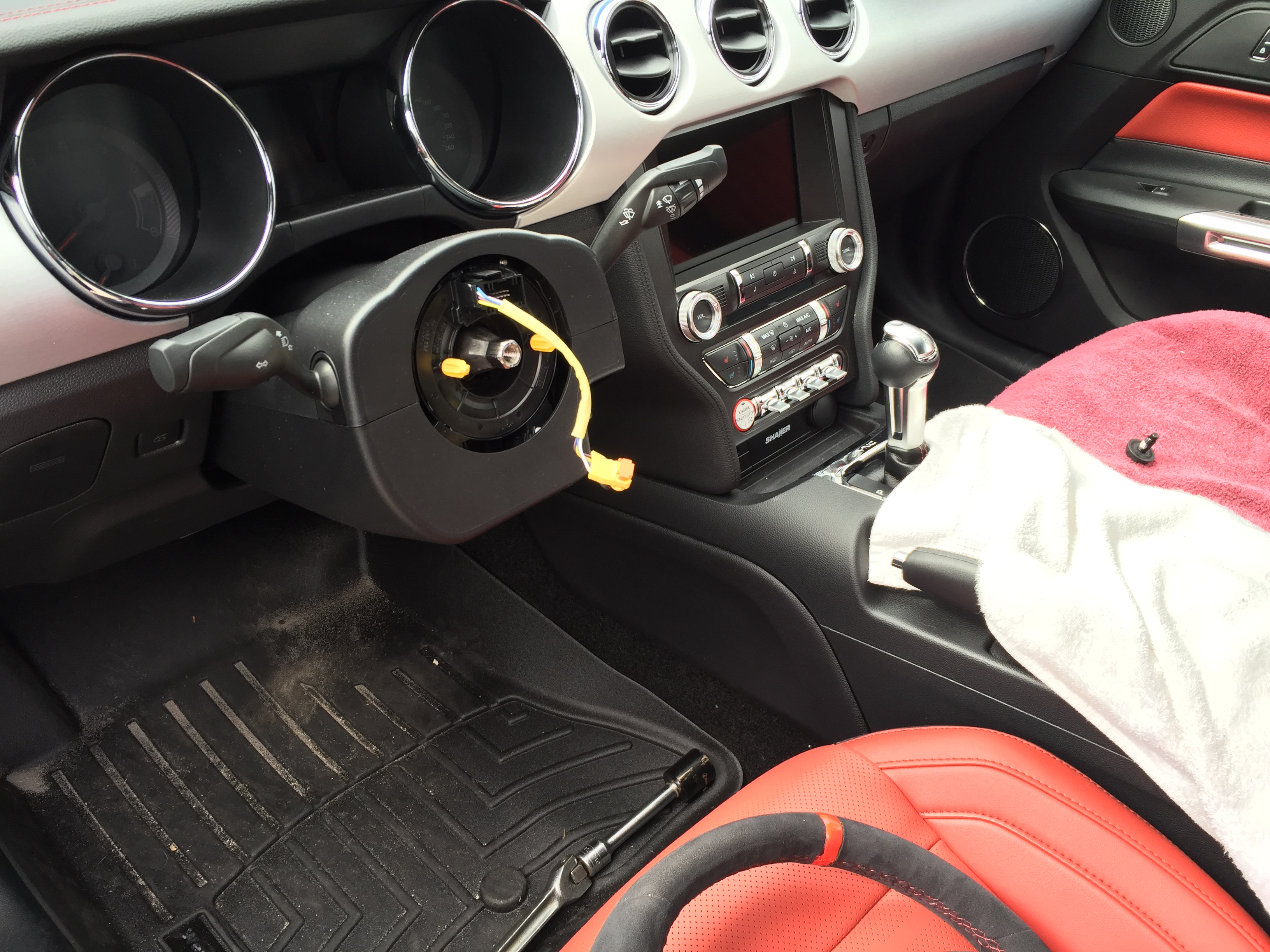

Got the Shelby on
Did the steering wheel swap this week. It was easier than I thought but I did have to be careful with the plastic covers. both removing and replacing. The Paddles were easy because they are installed in the shroud. I just swapped between the stock and the Shelby wheel.

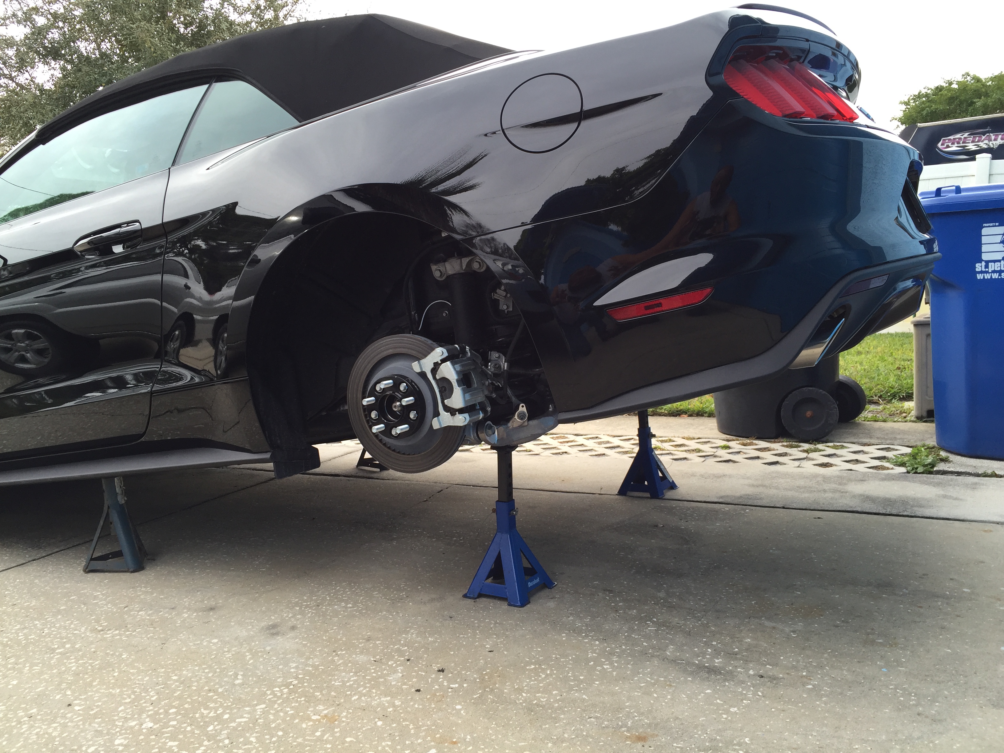

Weather has warmed up...
so it's time to tackle the things that have accumulated since taking delivery. First I need to put the Curt trailer hitch on. That is a big job, mostly because the hitch is heavy and has eight bolts but also because you first have to remove the extra bracing that comes on a convertible. Then you have to drop the exhaust enough to get clearance. I got the car up and the bracing off tonight. While it's up on the stands I have three more items to do. Install the Coyote 1" wheel spacers, install the Goodridge Stainless steel brake lines, and paint the calipers with G2 then apply the decals and clear coat. I don't have any help so this might take a few days.

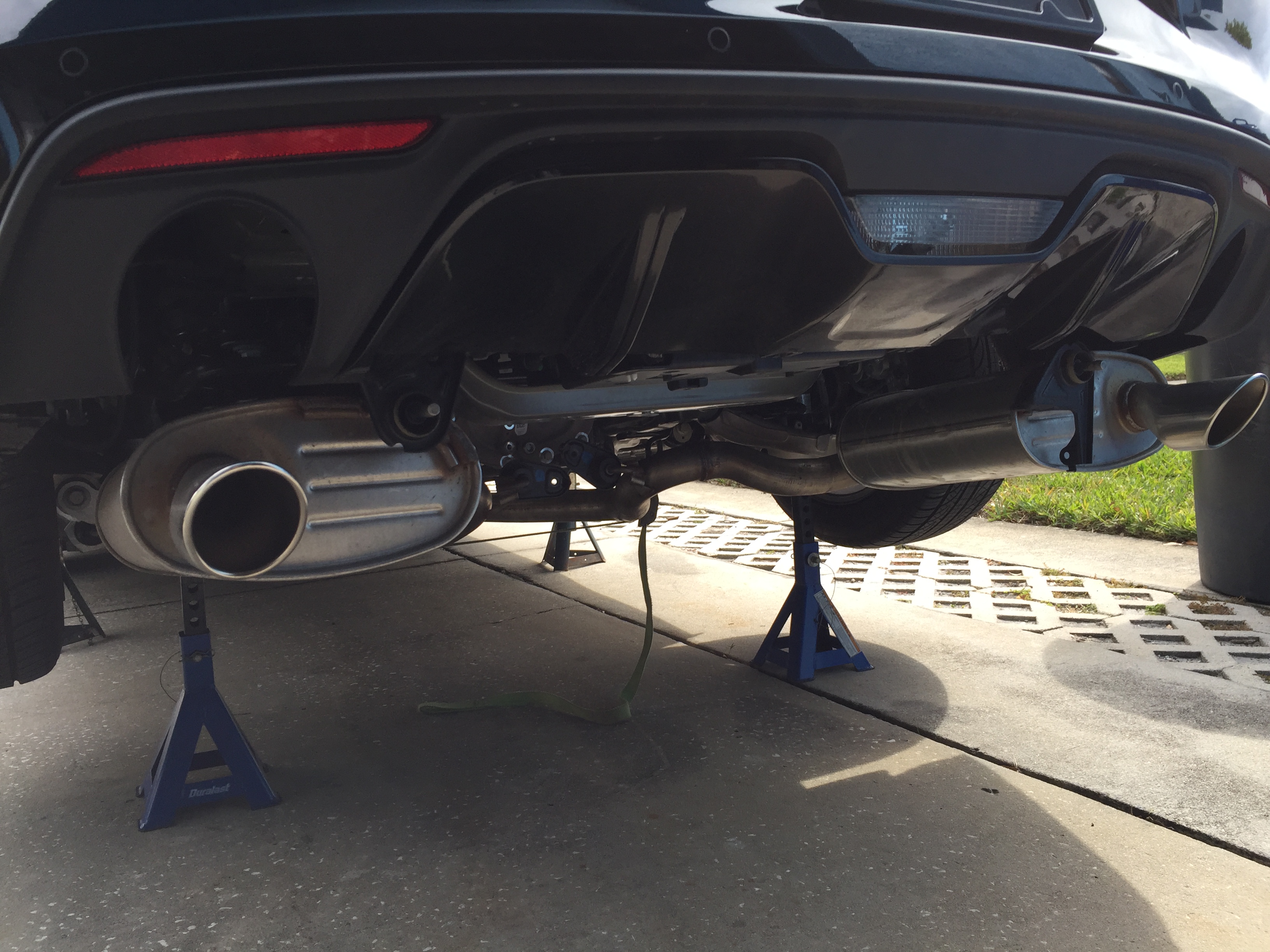

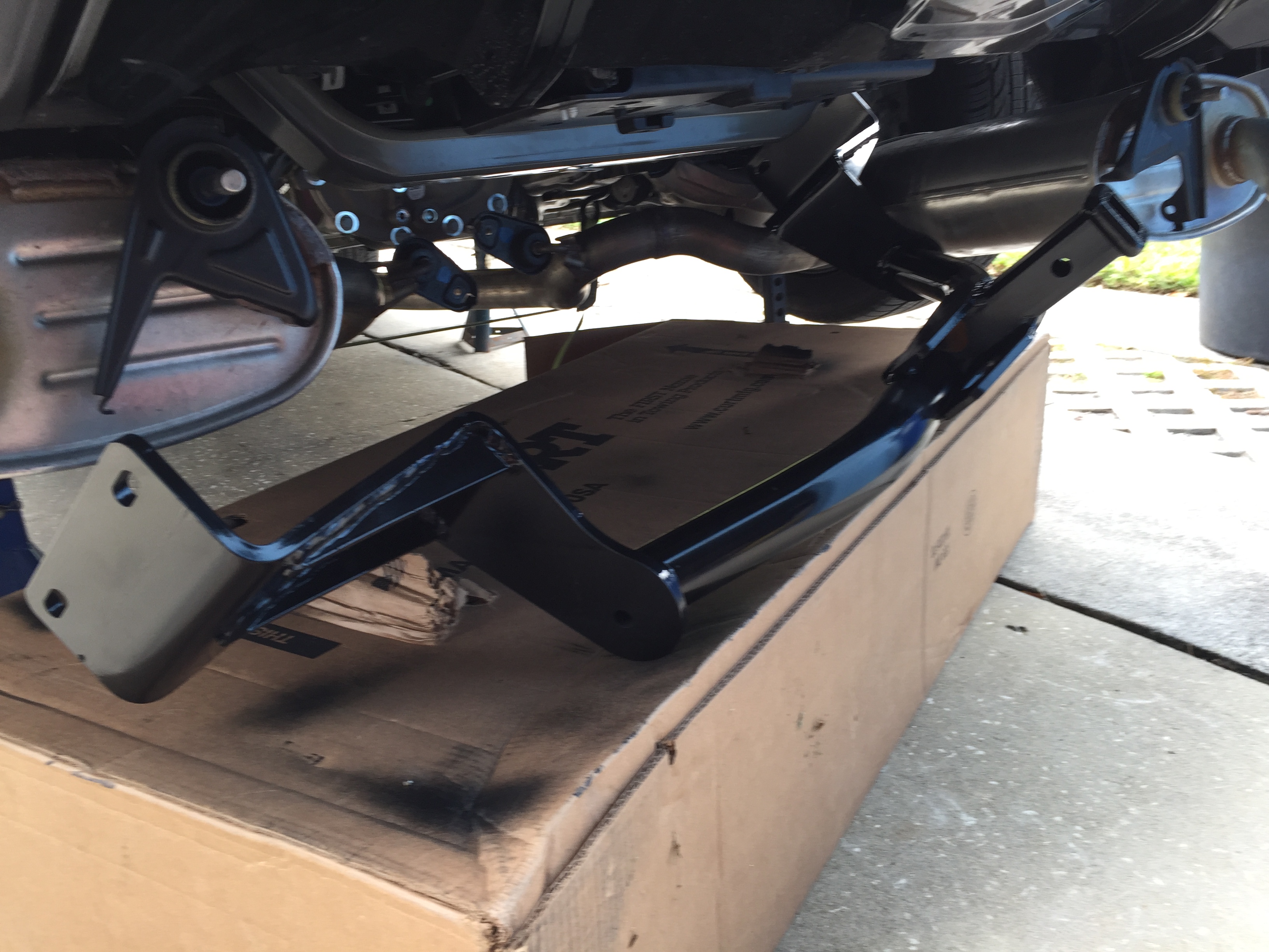

Spacers are easy but Hitches!!!!
I got the Curt hitch installed, by myself in the driveway. It was a real pain in the butt. The first issue is I have a Vert and it comes with extra chassis braces. They have to come off before you can lower the exhaust. So to install the hitch there are two other jobs to get done first and then after the hitch.
Attached Thumbnails 2016 Black Vert-img_9384.jpg   2016 Black Vert-img_9385.jpg   2016 Black Vert-img_9386.jpg   2016 Black Vert-img_9387.jpg

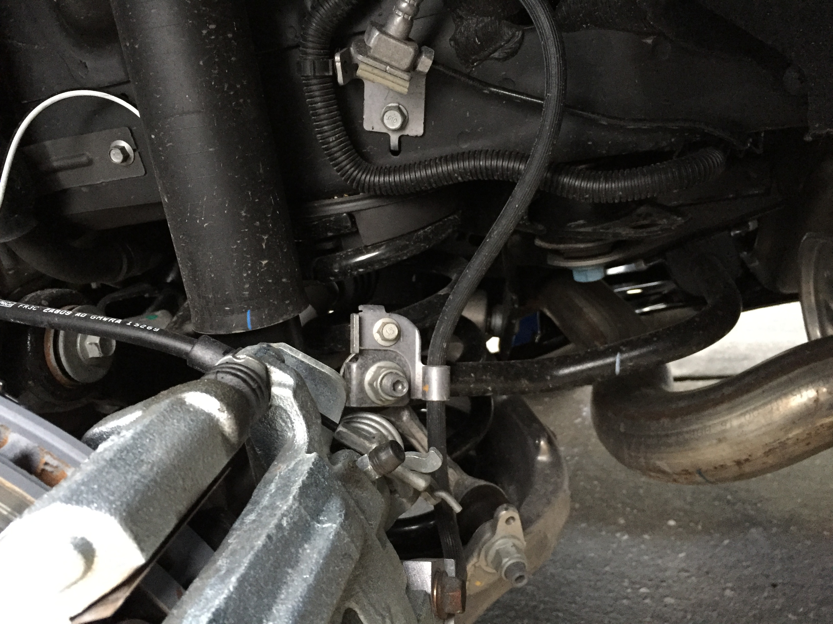

I planned to install the Goodridge stainless brake lines today, but I got a late start. The brake lines went on easy enough but I tried to use a MityVac hand vacuum to bleed them. After several hours I still didn't think I had done a good job. I wasn't going to risk my car so I fell back to the one man jar and hose method. Surprisingly there was no air left in the lines, the MityVac did work it just doesn't look like it works.
Anyway the brakes are done but I have no energy left to paint the calipers. I'm leaving that for a later day, I want to drive.
Brake line before:
And after:
Attached Thumbnails 2016 Black Vert-img_9388.jpg   2016 Black Vert-img_9393.jpg

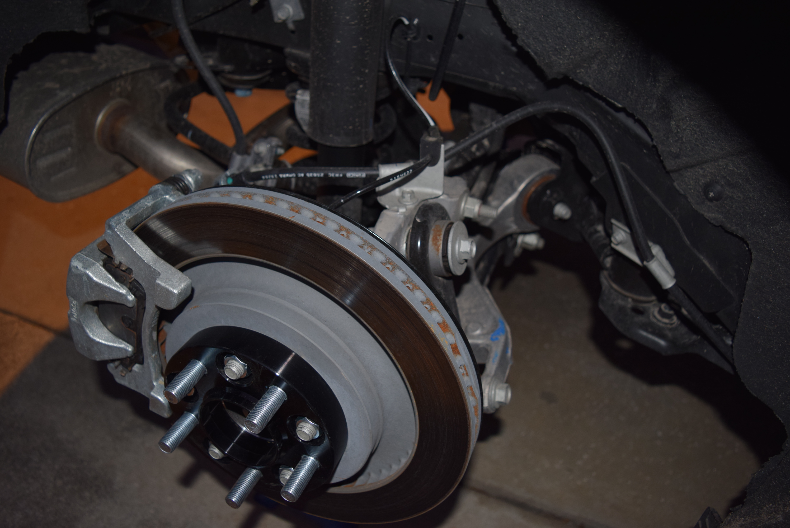

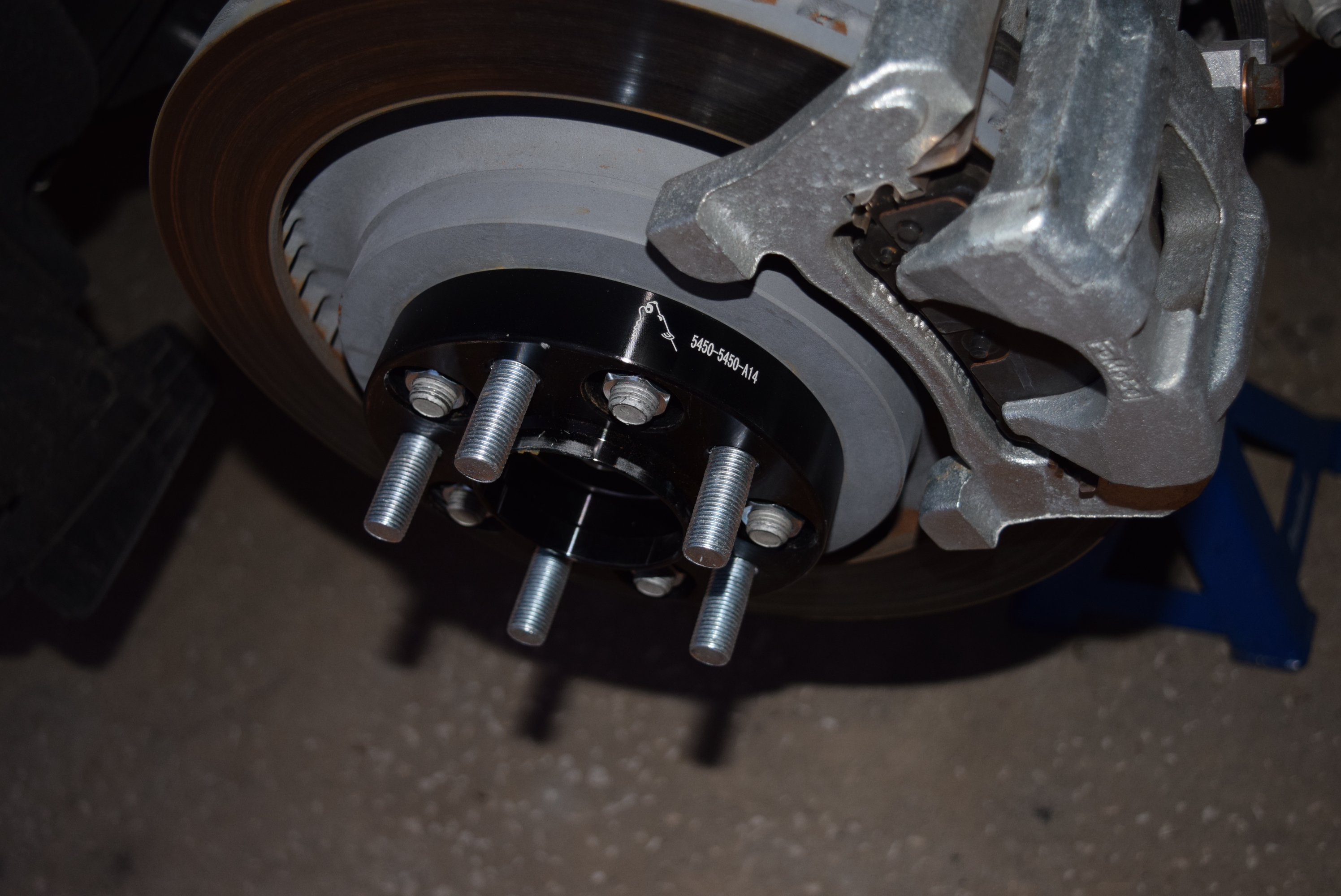

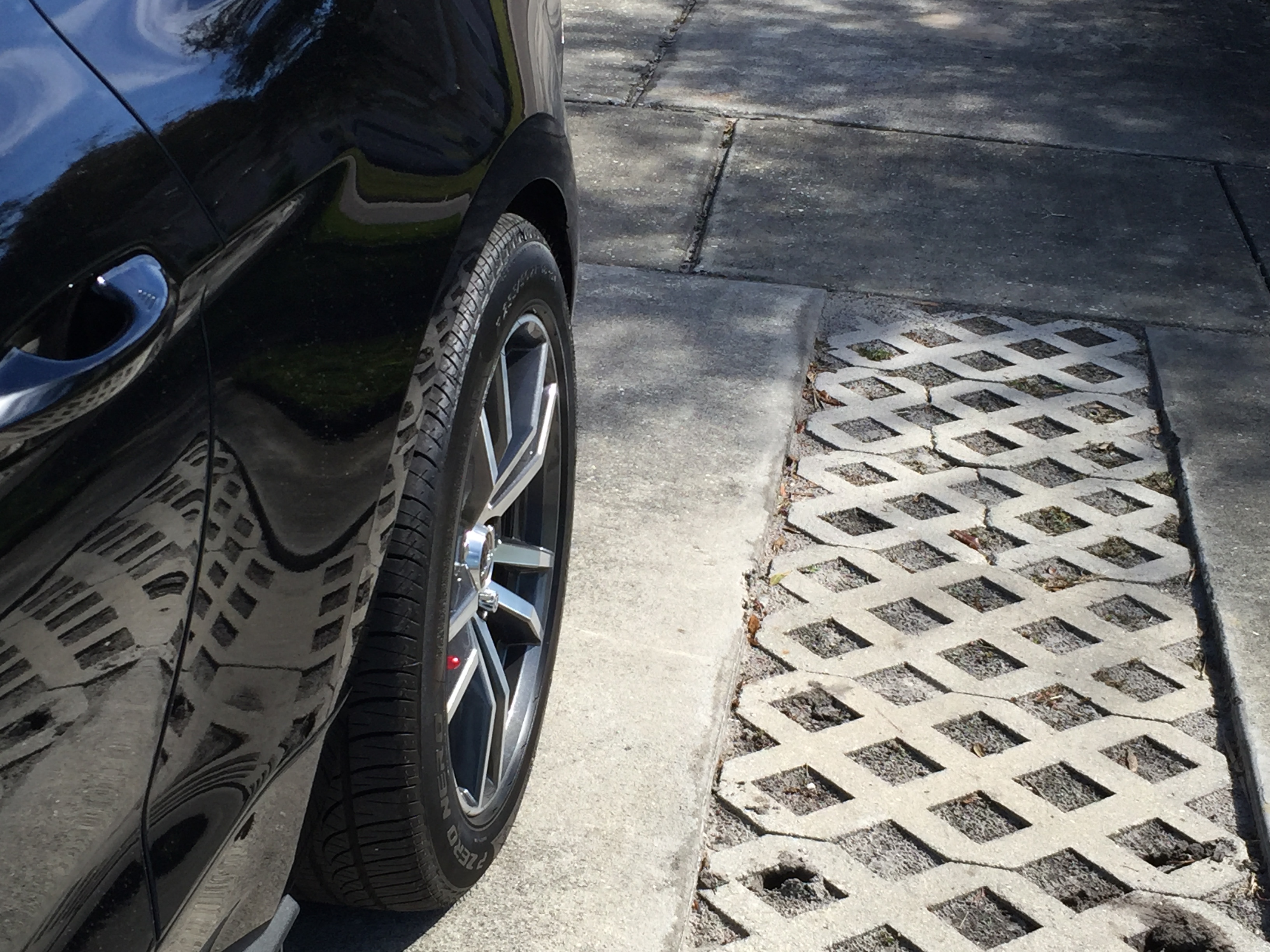

Coyote 1" spacers
on the rear with the stock 18 x 8 wheels looks like this.
Attached Thumbnails 2016 Black Vert-dsc_0003.jpg   2016 Black Vert-img_9409.jpg   2016 Black Vert-img_9410.jpg

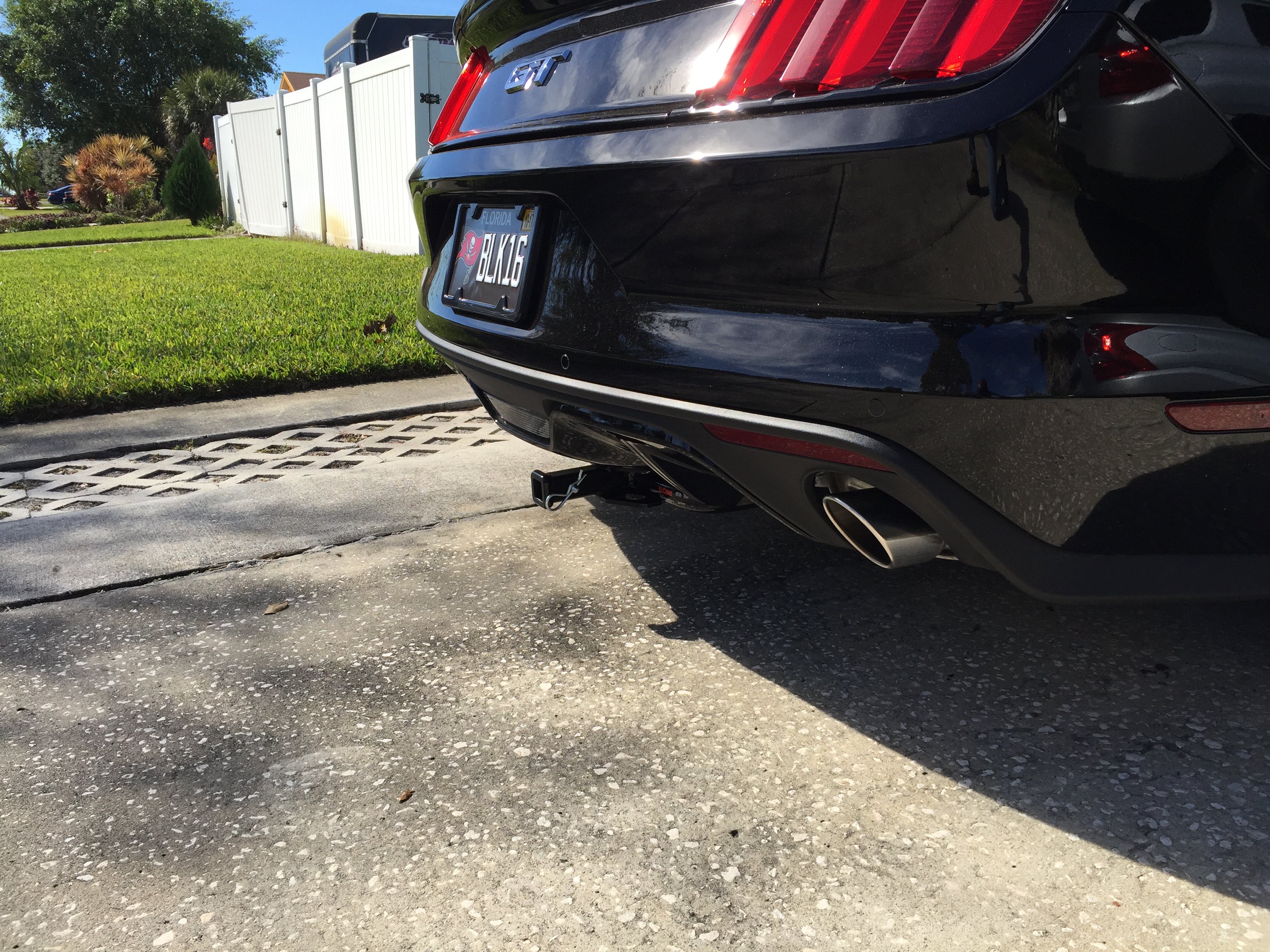

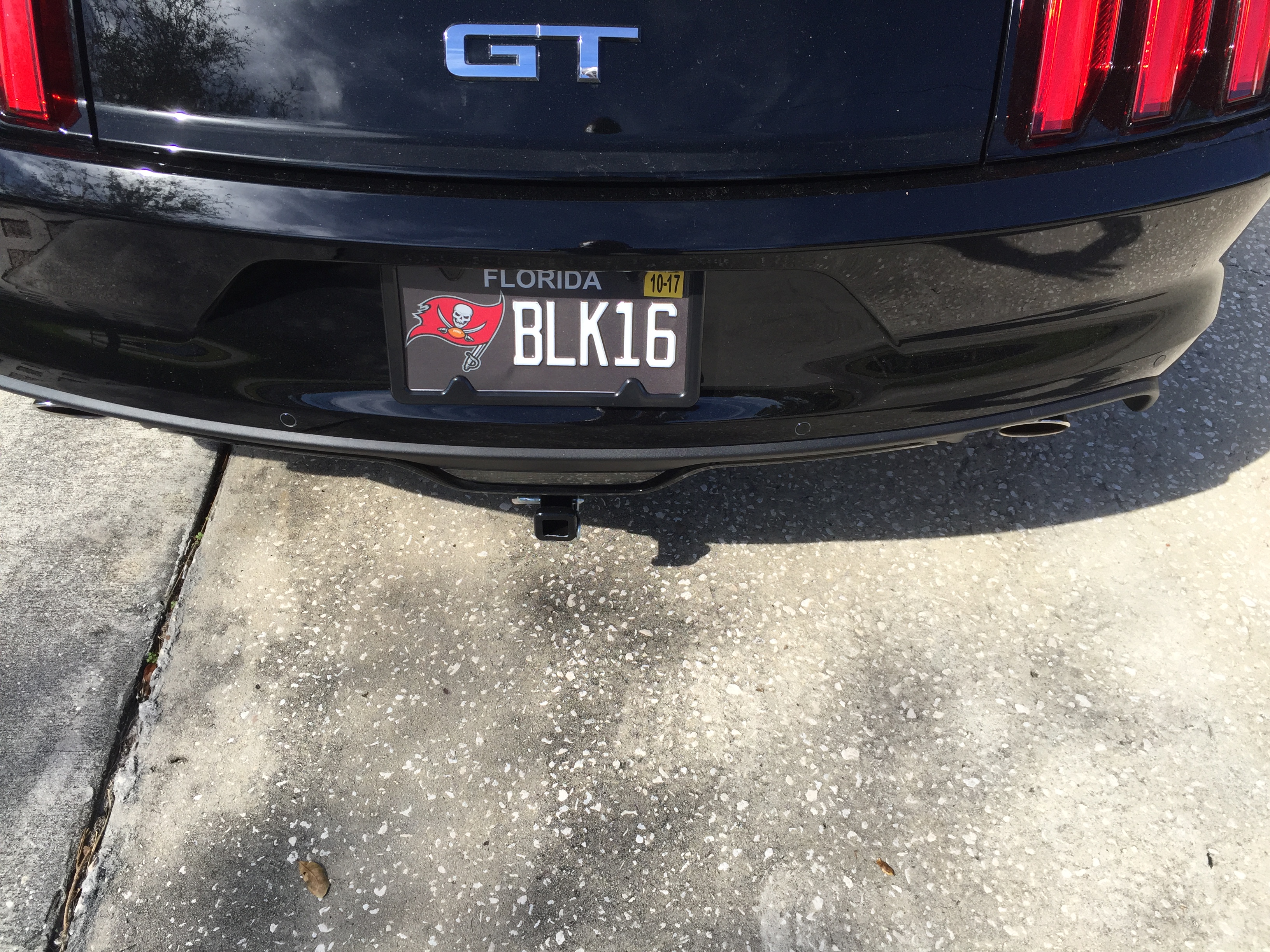

Curt Trailer hitch
While I know some would say it ruins the look of the car I added the hitch. Not planning to tow anything but I like to take my bike with me when I go visit the Grandkids for weeks at a time. So its on there.
Attached Thumbnails 2016 Black Vert-img_9386.jpg   2016 Black Vert-img_9411.jpg   2016 Black Vert-img_9412.jpg   2016 Black Vert-img_9413.jpg
