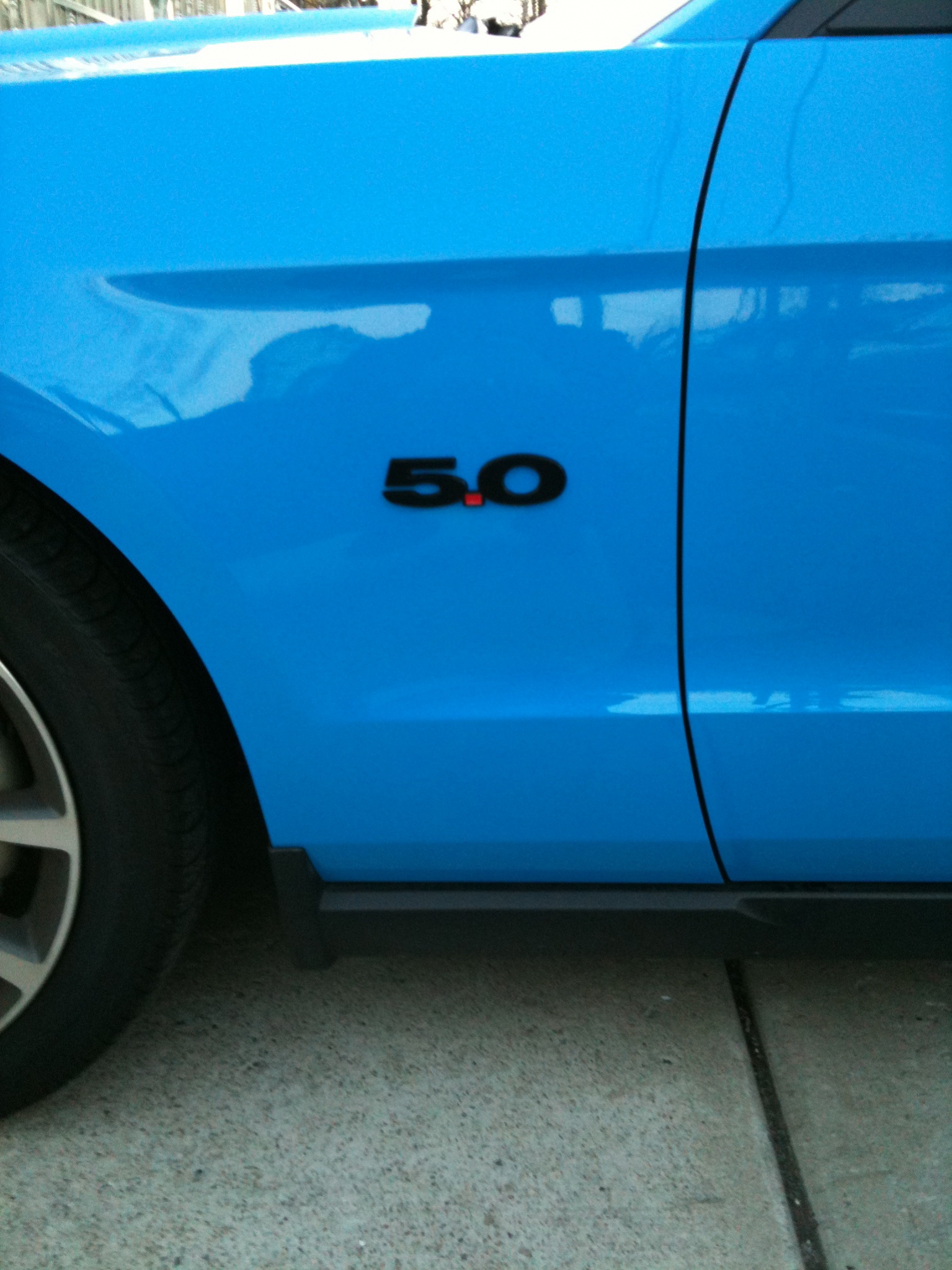

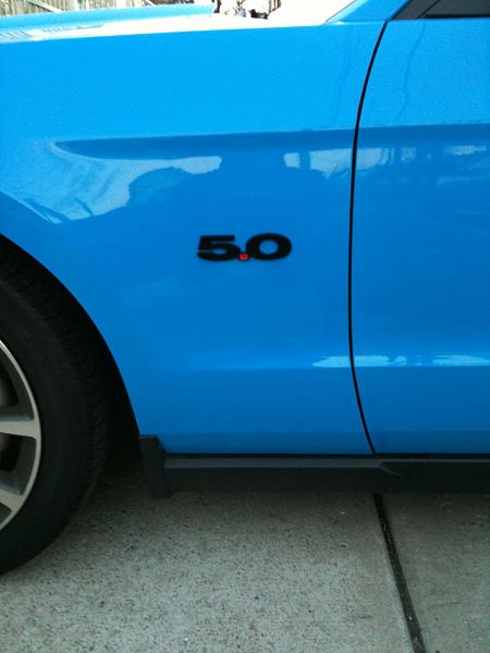

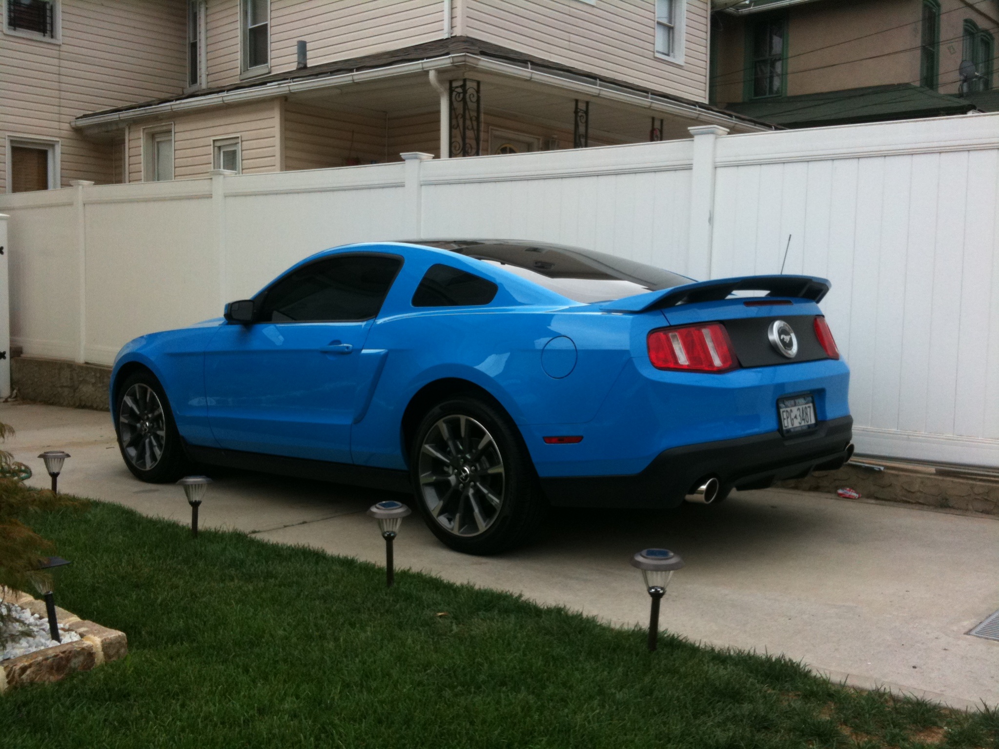

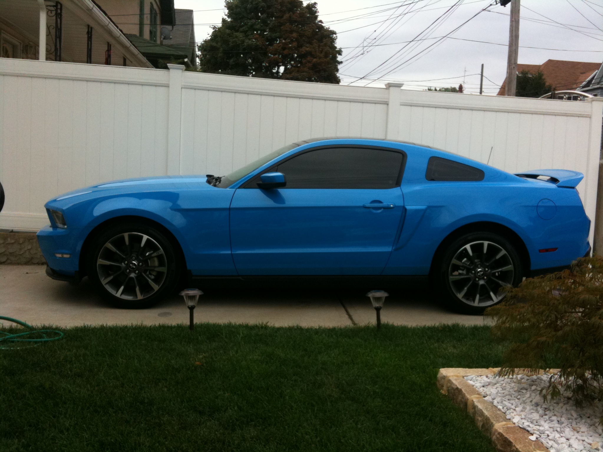

BTW here's some pics of my stang.

Where did you get the black 5.0 badge?
On ebay from blue oval.
I like that black 5.0 badge that's freaking slick, I wish I had the ***** to do that, but I don't, I'd be too worried I'd screw it up.
Trust I was scared to put it on as well. It's prob a lil off but whatever I tried my best and it doesn't look to bad.
It looks like yours was a CS, so you didn't have to take the emblem off? That's the part I'd be most worried about... If you did have to take your old ones off how did that go?
Also if it is crooked I can't tell, it looks great.
You're right I didn't have an emblem to remove but I removed the stripe. My fear was putting the badges on crooked or not having them even on bothe side which they prob not exact.

From: Naples, Fl
what tint % did you get? i like
Old Feb 6, 2011 | 07:37 PM
COYOTEHP's Avatar
Joined: February 5, 2011
Posts: 100
From: Staten Island
5% limo tint and I love it.
