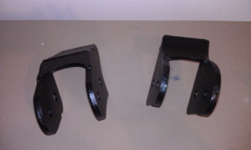

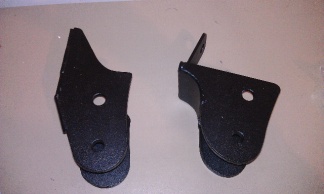

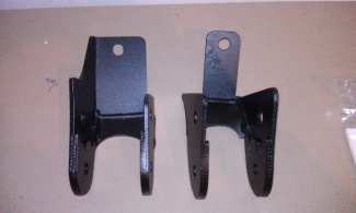

Just got my CHE brackets. They're pretty hefty.
Not sure why they're a bit crooked, but I'm sure they're formed like that for a reason. I'll find out this weekend when I install them. I'll be trying them with stock lca's first to see how they improve traction. Then I'll add upgraded lca's later.

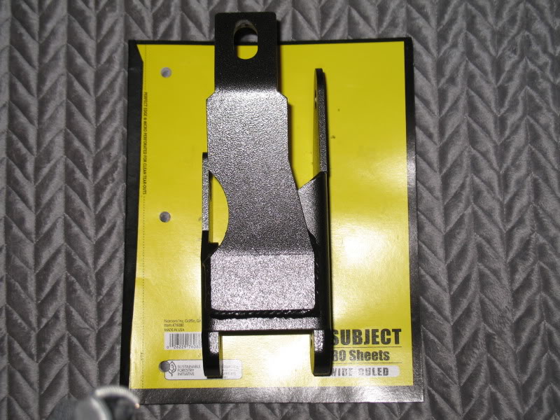

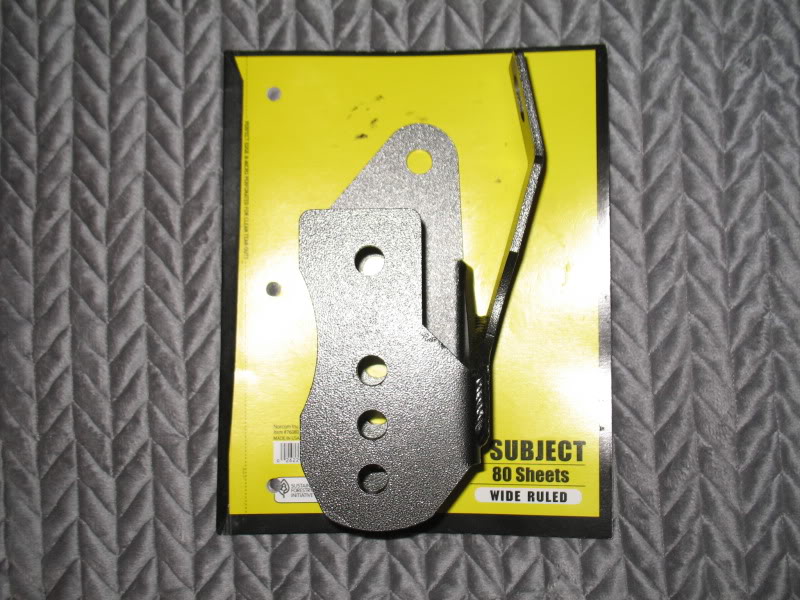

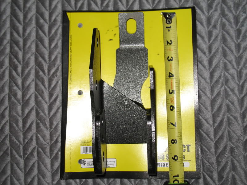

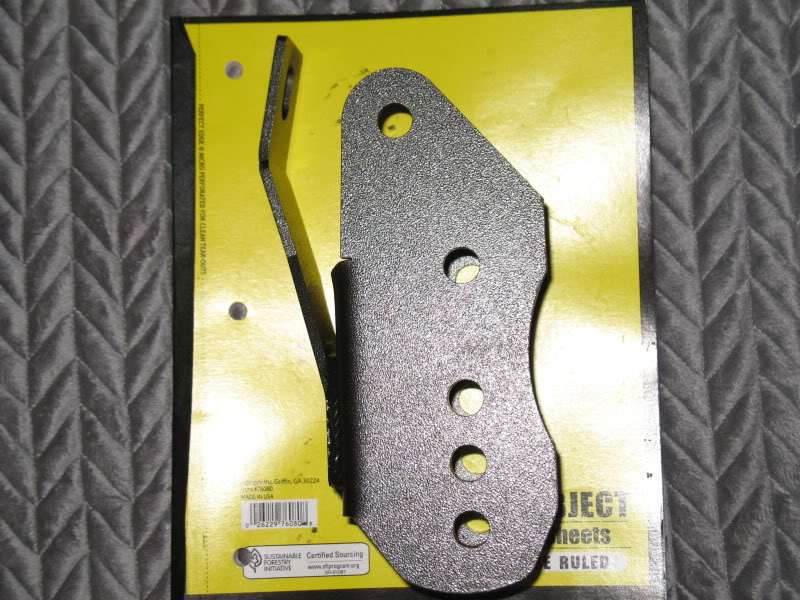

These are the one's you want, BMR.
I almost bought those. Do they have an odd curve to their shape? I've never seen brackets up close but mine just don't look right.
Edit: Holy crap they're the size of a notebook!!

There's only three points that tie in rear to car and i went with these after seeing how they were built on a coworkers Boss.

CHE brackets are finally in along with J&M extreme lca's. I can finally say, yes, brackets are a necessity if you're lowered. The car just dead hooks on my Nitto's now. I can't believe I've went this long without them. If you get the CHE'S, you may need to grind out one of the mounting holes on the passenger side. I had to but it wasn't bad. With my k springs the brackets gave back the correct position to the lca's. Total install took around 3 hours on jack stands with help from my buddy.
