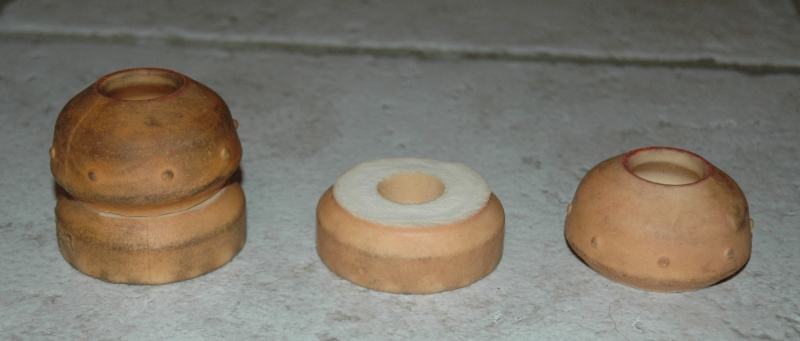

Bumpstops cut :
The question now is : which part will better ? The smaller one with more density or the top one with less density in its curved part ?

The 2 curved parts have been installed this afternoon.
Everything seems fine.
