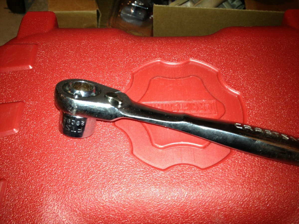

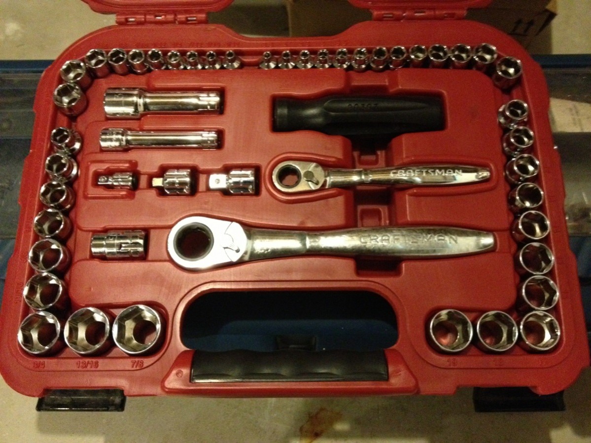

I picked up this set of Craftsman sockets. These allow you to torque down the top nut while holding the spindle steady with a smaller socket through the opening.

http://www.harborfreight.com/3-8-eig...nch-97177.html
Cheapest option I know, worked like charm for me.
