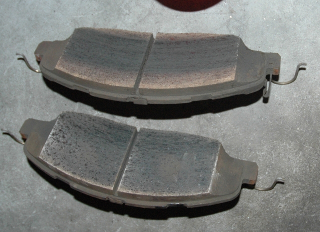

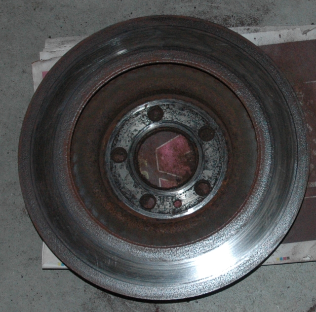

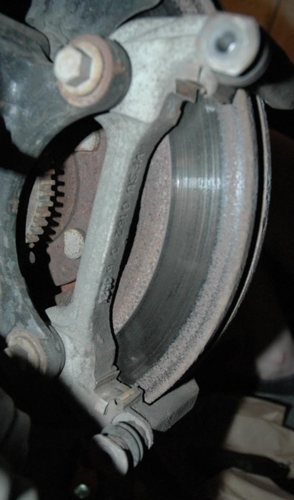

I was changing the front pads of my 2011 GT (32000km) and i have discovered this on the right front rotor :
A manufacturing defect ?
The brake fluid was changed for a DOT 5.1 in april before a track day.
And i remember that this rotor was smoking after a session in the afternoon for some minutes. But the car has kept the same braking performance all the day.
Serge.

wow. Are you going to replace it or just have it turned

Did you just change fluid and not pads? I had something similar happen to my rear brakes on one side because some grease got on the rotor after the pad change. Also change from 5.1 to DOT 4, something like Motul 660 or Stoptech 600.

Wow, at the very least you should get your rotors turned!

I have the car since one year so i hope it is its first set of pads.

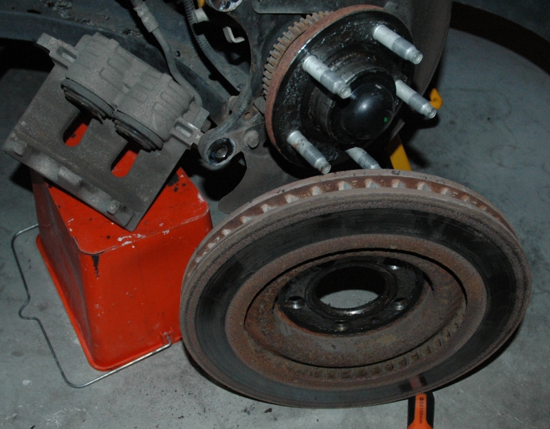

This afternoon, disassembly of the 2 front rotors.
Same rotor after using sand paper and a dremel finish with a metal brush :
No more brown tracks, but the rotor is not slick where the brown parts were.
I think it was some rust. It was so hard, it did 2 steps in the pads.
Left rotor was showing the same problem :

Its rust

All the cars me and my coworkers have seen that look like this have come from either the cost or up north. Salt water doing it.Don't know exactly why they rust that way. We had an explorer come in today with all 4 like that. Lady told us she bought it in Canada.

The sliders are stuck. Move the slider boots and clean them with wd40. Let them dry and pack them with synthetic grease, make sure they are not bent or stuck. This is the reason I hate sliding calipers. They can start dragging and then ruin a set of rotors and pads.

either replace those or have them turned. they still look pretty sad after the sanding

The calipers are moving on the sliders axles with no effort.
