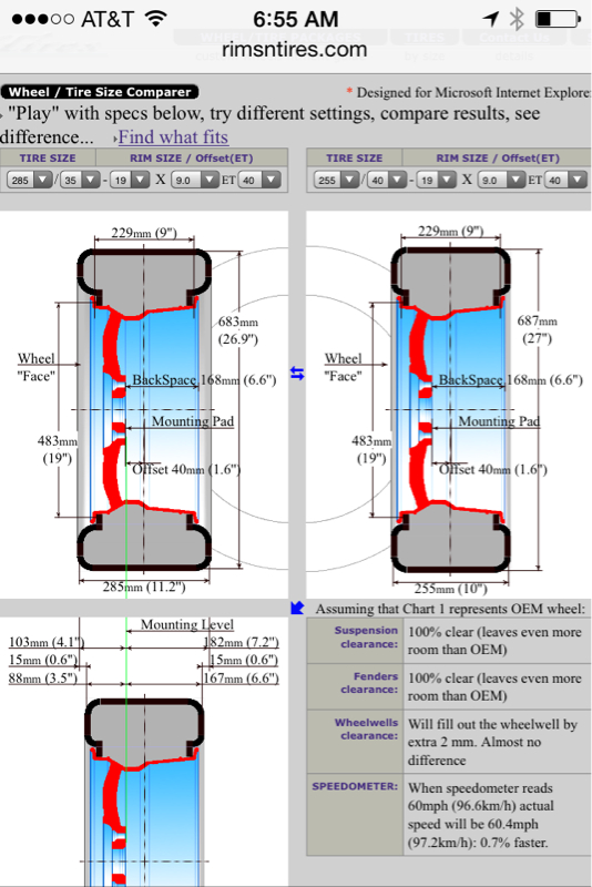

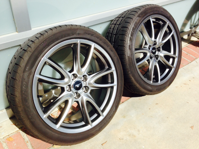

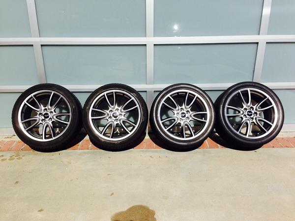

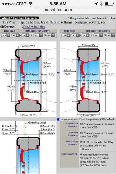

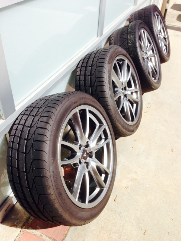

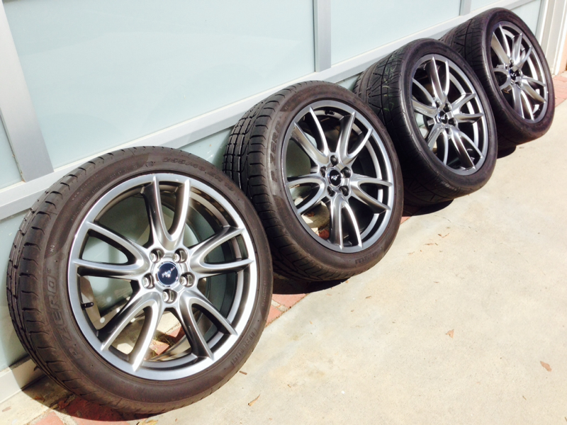

Awhile ago, I had a set of 19" Brembo rims with stock tires 255/40/19. For the rears, I got some Nitto Invos 285/35/19 to get as close to the same 27" diameter. The sidewalls on the rears bulge out a little bit compared to the fronts. But with the wider rears, you'd get better traction. I don't have 19"s anymore and currently using 20"s.
