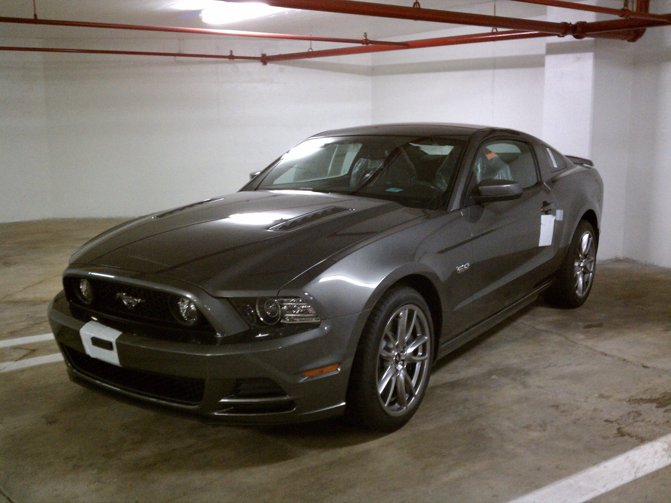

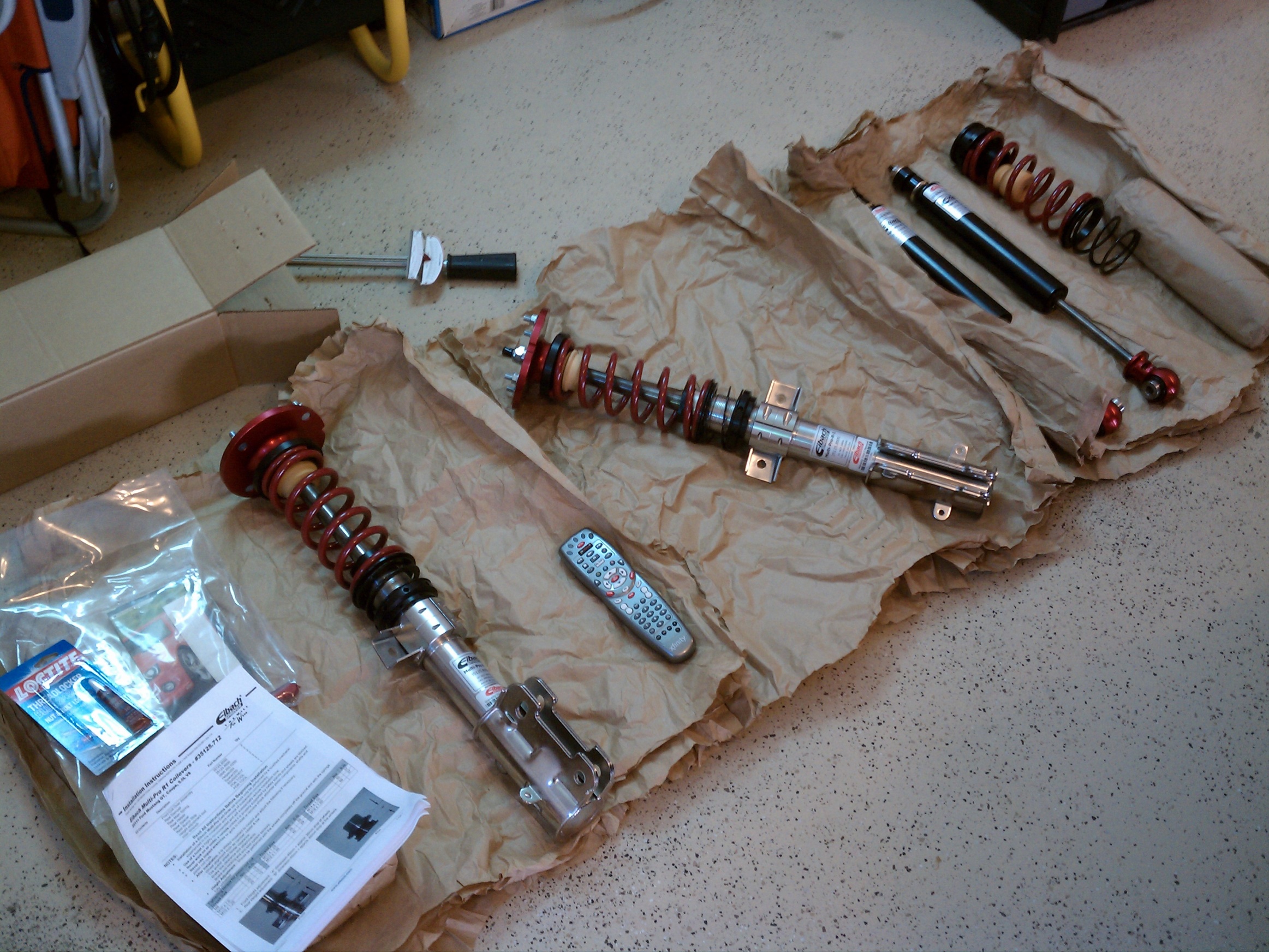

Before pic and pic of the kit unpackaged. The parts are gorgeous with stainless and anodized...

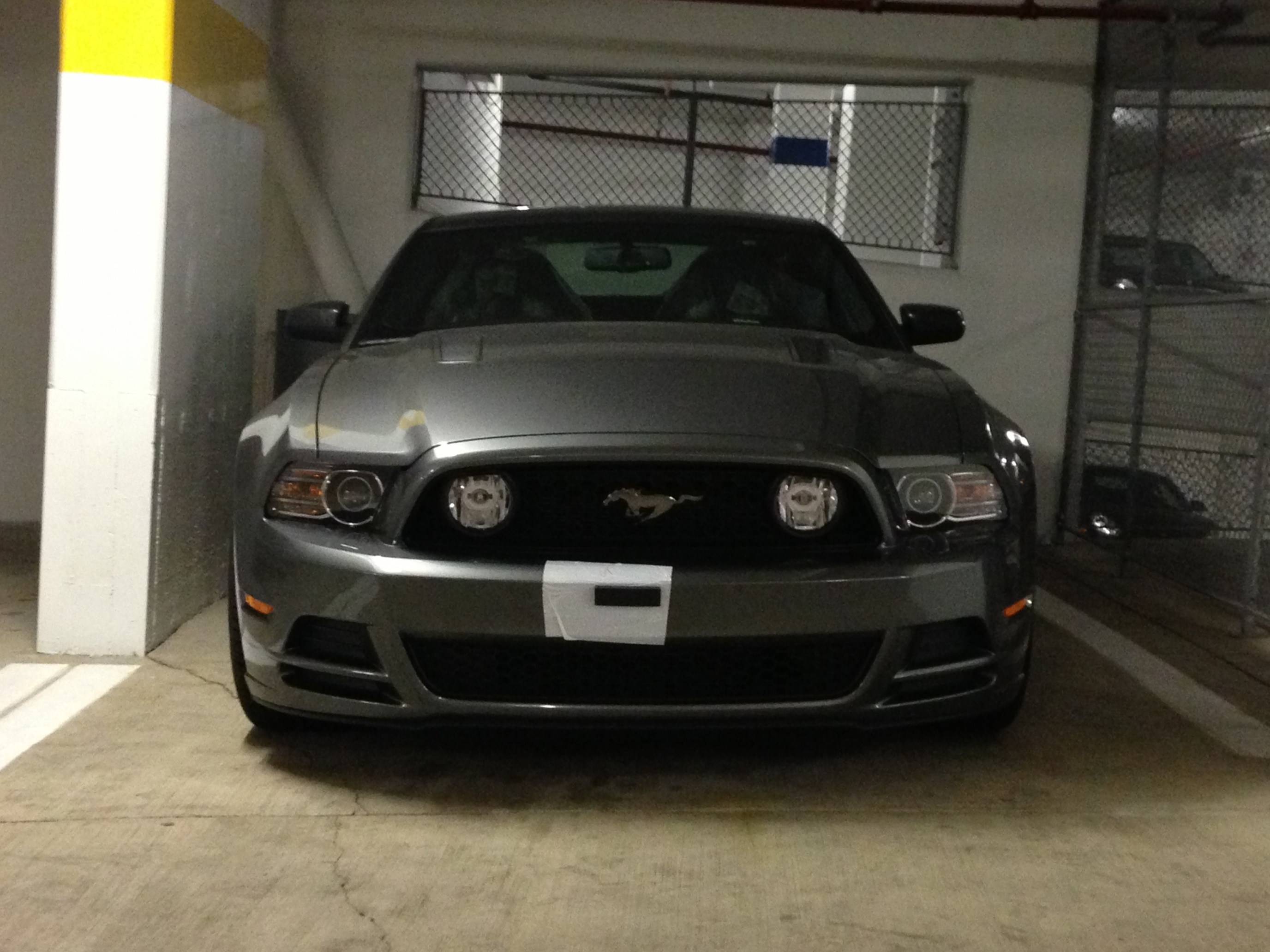

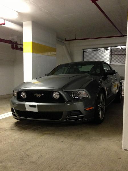

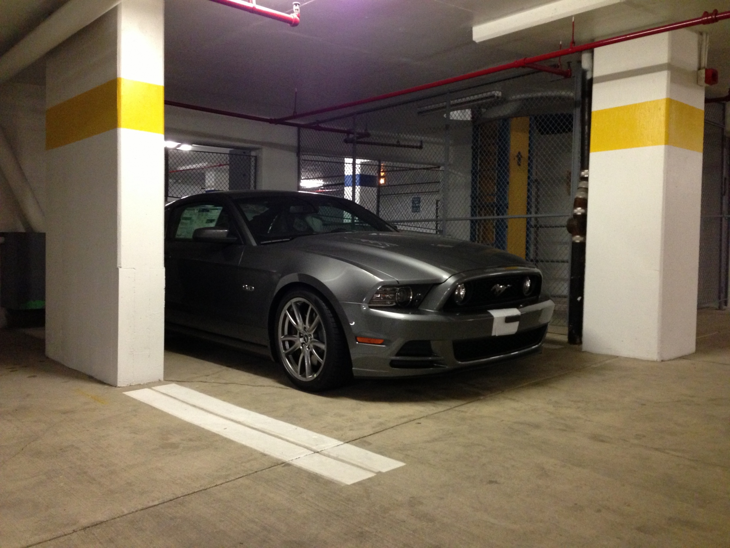

After...
Pics aren't that great; I'll try to do better and post back when I have a chance.
Also installed is a Ford Racing adjustable panhard bar - but I've yet to do my alignment.
