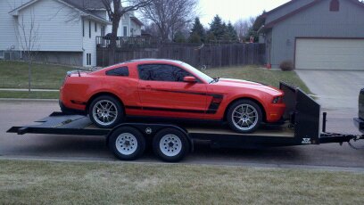

Nice! Boss already on the trailer heading to the track or was that while bringing it home??

Thanks for the info. That was her getting dropped of at her new home last night.

Better posts up some pic's of that car quick!
I see the stripes are black now.......what did they do with the roof? Or did you buy a different car? What number is it? etc. etc. etc.

Its 0004. The dealer finally realized it was painted and swapped cars with another dealer. I'm glad it worked out.
