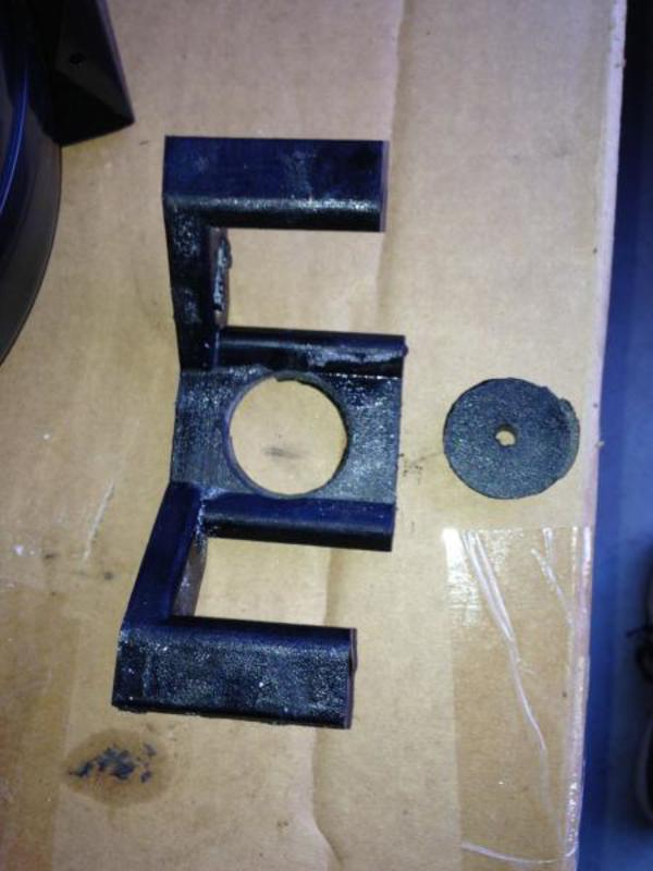

During my research, I came across added NVH when WL bushing is installed. What do you guys make of this mod:

Attachment 154357
Also what do we gain out of replacing the braided clutch-line?
If you search further you will see that some people completely cut out that center prong with the 2" hole in it, others made the 2" hole and others are happy with the stock unit. I am going to cut out the hole as there seems to be no downside to doing it and once I install this bushing I will be too lazy to take it back out and make the modification unless the NVH is completely unbearable! So, I think I'll cut the hole and do the install and see how that is.
Exactly how bad is the NVH anyways that people are forced to do such mods. I mean, I had my rear-view mirror replaced under Warranty because of rattle. As long as its not annoying I can probably live with it?
Arousing question is that will the piece last/hold long enough since it just got a big hole in the middle (or cut out the center for that matter)...?

Other than a very slight extra vibration in neutral when blipping the gas, I haven't noticed any additional NVH. And even that might be all in my head!

The people who seemed to have issues were complaining of vibration through the floorboards at worst.
I'm not too worried about the part holding up. If it fails I'll be willing to spend another $30 (and this time maybe not cut the hole) and replace it. Or, you could fill in the holes on the stock bushing with a product (cant recall what it is right now) and it does the same thing although you "ruin" the stock bushing in that scenario.
