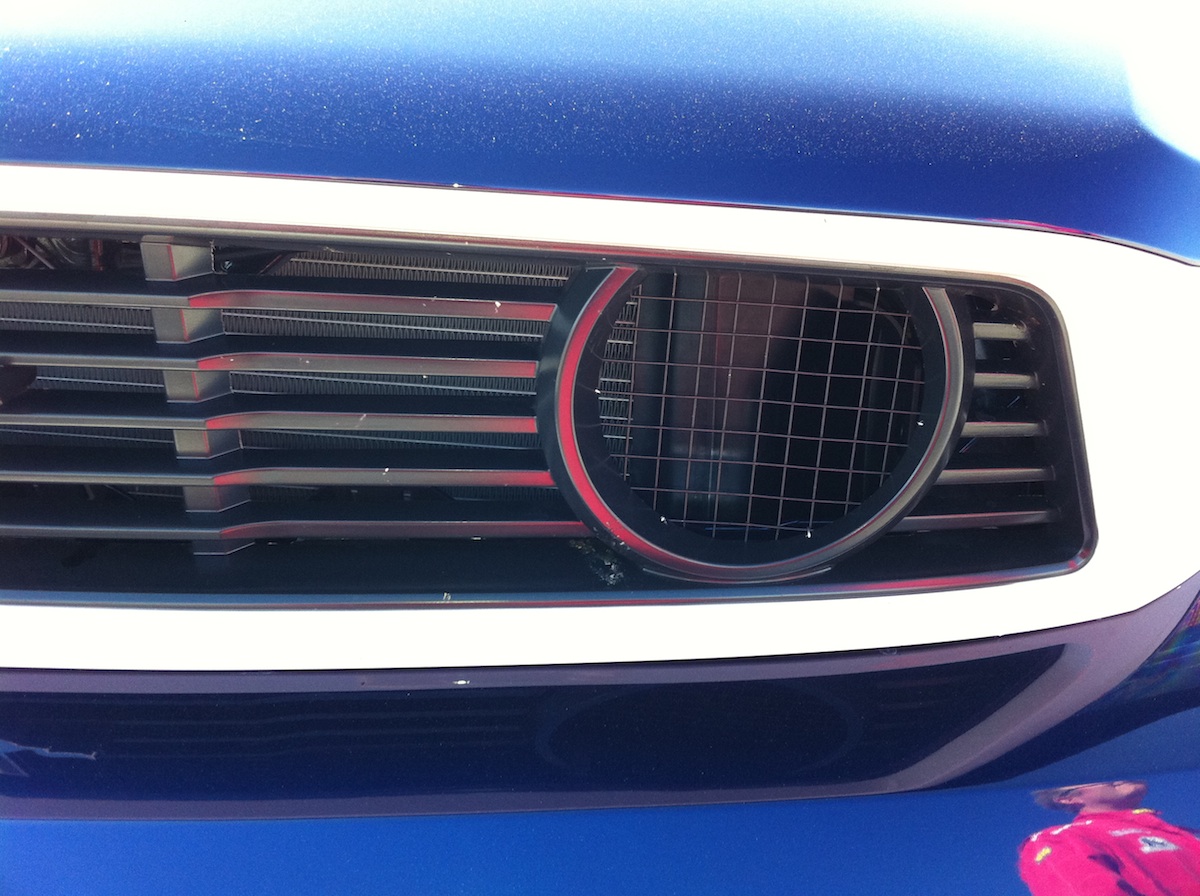

Here's the photo of the grill on the car I drove. The passenger side was not cutout between the fog lamp hole and the side.

Seriously who cares about the blue car? Here is a better pic

Originally Posted by 2012YellowBoss
I gotta say guys, everyone should be smacking themselves in the head, in hindsight of course.
I'd not seen the backside before, but this grille is even more closed off than my 09 GT one -- even the 'open' areas are rather choked down, and I believe the RoadRunner may generate just a bit more heat than my little 4.6L
It really should have occurred to someone earlier to try without the grille, or at least with a high-flow version, as opposed to just opening the fogs. These cars are apparently not the bottom-feeders the lower bumper openings might imply.
I've seen definite improvement in temps from my Agent47 one, and it looks better than stock.

The honeycomb screen looks a lot better than square screen. Hopefully they come up with something by next Spring. Or better yet maybe Ford gives us all 302S grills with everything cut out and screen across the fog openings.
