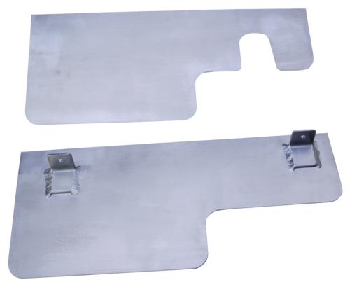

This weekend I upgraded my radiator (bit of a pain in the butt), installed a coolant temp sender (hopefully will get the gauge it goes to in soon, too, as well), and an oil-filter spacer with NPTs for oil pressure and temp senders. Have the Aeroforce to go in soon as well. And fronting it with the Agent47 grille.
Anybody else done this here? I was having overheating/hot running issues at several tracks, especially with the long straights, here at altitude, though a lap or two of easy going would generally remedy it quickly. We don't have humidity here, but at 5400 ft, the cooling's not the most efficient when it's 90 degrees plus.
When I had my '06 Mustang I followed Ford Racing's lead, they "boxed" the FR500S radiator.
This forces the air to be channeled/forced through the radiator rather than following the path of least resistance and going around it.
Look here for the part FR500S RADIATOR AIR DEFLECTOR KIT M-8310-A.
Much easier that fabing up your own……
If you still have overheating issues you might look at an oil cooler………..

So where do these things mount? On the sides? Hope it wouldn't involve removing the radiator, as it was a pain (gouged up the AC radiator with the stupid lower screws).
