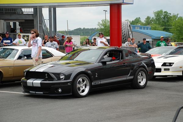

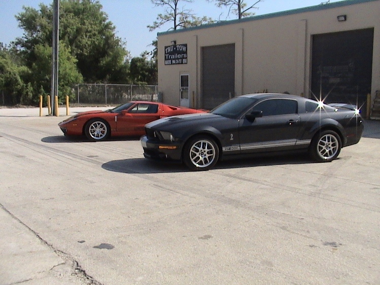

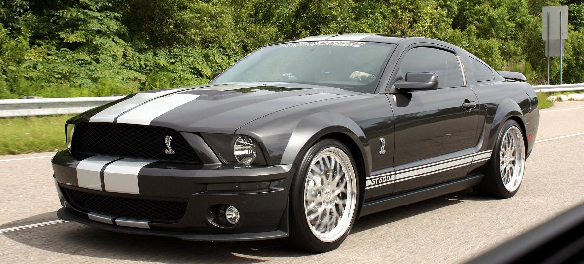

I have a set of Steeda Comp Series I ran on my GT500 for a few years. When I put them on, they didn't make a GT500 Specific spring. Though they where not designed for the additional weight of the car, they worked well and improved the nose dive and body roll. I'll be looking to see what others are doing but Steeda has well devloped and tested products.
http://www.steeda.com/store/steeda-c...d-mustang.html
The first photo is the Steeda's, next is with QA1's/14-200 on the front and the Steeda's rear, stock of coarse and last is the Steeda's.
