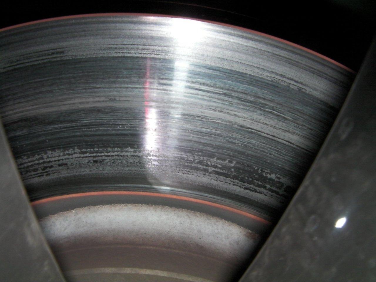

Here's a picture of what my front rotors look like both sides, all around:

Looks like pad transfer to me, which will shudder like crazy as it gets worse, even the steering wheel will shudder--yes, I've got experience.
Carbotech pads by chance??? Thats what I've been running. Sometimes the rotors stay clean, sometimes they look like yours. I buy the Carbotechs from the company, and have them pre-bed the pads. I'm guessing I'm not getting the rotors seasoned well.
But I've heard Carbotch are more touchy to bed than other brands. I'll give them a few more chances, then I'll move on if I can't figure them out.

You can clean them off.
Carbotech says use 80 grit emery cloth disc on an angle grinder.
Be careful to keep it moving so you don't gouge into the surface.
I might try my random orbit sander next time.
Another option is a 3M "clean and strip disc", search on Amazon for it.
Send your pic to Carbotech and ask them the solution. I've heard others say Carbotechs are the most touchy for proper bedding.

bad news, brought in the Boss to my closet Sears to turn the front rotors
Sears wil lnot turn them as they have micro cracks GRRRRR
....probably will be same msg at any shops

Front rotors are spent, too many stress cracks, cant be turned :-(
Boss has about 18k miles, about 8 track days, and still meat on the RP2 pads.
