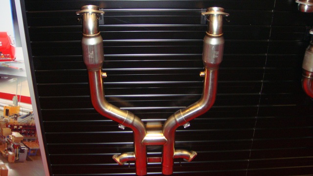

Of all the various exhaust system manufacturers, it seems that Kook's has been the most aggressive in offering various components for our consideration. In particular, Kook's has an H-Pipe that is structured to retain the Boss' unique side pipes. We really like this option as it allows owners to have some control over the quality and loudness of the exhaust - just as we do with the OEM system. This BOSS-unique H-Pipe is available both with and without CATs depending on what you want. Here are a few pics of their BOSS H-Pipe.
For those that may not care about retaining the side pipe - especially those that are after every last inch of weight savings, Kook's offers both an H-Pipe and an X-Pipe in a non-BOSS specific format. They will fit our BOSS 302's and the side pipes can be eliminated. Both of these X and H Pipes are also available with and without CATs.
Having chosen a mid-pipe, Kook's also now offers a full 3" CAT-back (from the mid, H or X Pipe back through the exhaust tips.) This CAT-back will work with any of the mid-pipes and even works for the OEM configuration. This CAT-back system includes fully polished mufflers and 4" polished exhaust tips.
Forward of the mid-pipe, Kook's offers some very nice full-stainless headers for our Coyote motor. The headers all have 3" collectors and are available in 1 5/8", 1 3/4, and 1 7/8" primary tubes. If you have - or plan to have NOS or forced induction, then you might consider the 1 7/8" headers. Otherwise, we would recommend the 1 3/4" primaries. Of all the headers that we saw at the show, the Kook's are hard to find fault with. The have very nice (thick!) flanges and there's a lot of hand finish work done within each of the primary tubes. Many other headers are not finished as well as the Kook's.
Cool Tech builds and maintains (3) 2012 Laguna Secas. We have ordered the complete Kook's exhaust system for each of them. We will be using the Kook's headers with 1 3/4" headers, the CAT'd BOSS-unique H-Pipe which retains the side pipes, and the CAT-back system with Kook's mufflers and tips. Please watch this forum as we will be reporting back on the weight differences compared to OEM as well as the perfomance gains measured on an objective (trusted) dyno.

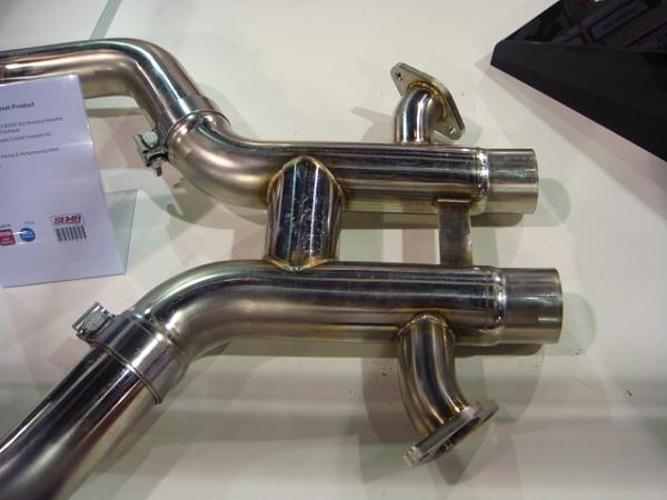

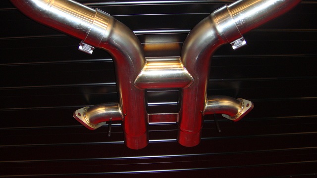

Interesting offering, Kendall. Right off the bat - I notice that Kooks' H-section utilizes a welded in section of tubing as well as a strip of stainless material between the two main exhaust pipes. While the welds look beautiful and the section appears to be very beefy, I'm wondering about any resonant side effects that'll arise due to the elimination of the factory style bellows.
With the quad pipes, you now have expansion/contraction in lateral planes whereas you didn't before (or at least not of the same magnitude). This leaves the factory rubber bushing to take up any and all changes in pipe length (as well as the welded in flex section on each quad). It is in fact, similar to how my own home brew "Quad H-section" ended up...
Some may notice certain harmonics from the system that they didn't have before because of it. I'd be interested to know why Kooks chose to go this route as opposed to using a factory "style" expansion pipe at the "H" juncture.
Secondly, the cats. I've seen a multitude of threads where the metallic substrate cats are failing and not long after installation either.
Those are Kooks cats (unsure as to whether Kooks manufactures them or farms them out). To be fair, my experience here resides more from the blown 5.4 community, and the additional horsepower undoubtedly compounds the issue as does how well the vehicle has been tuned and for what type of use. Is Kooks addressing this issue or considering using a larger, OE type ceramic substrate cat instead? Flow as well as a metallic unit may, they seem to be subject to catastrophic failure more so than lesser flowing units with a higher cell count. Can you elaborate here?
ON EDIT...PTROCKS hit it. I'd be interested in knowing why the crossover section wasn't designed to be parallel to the rest of the quad system as well...
