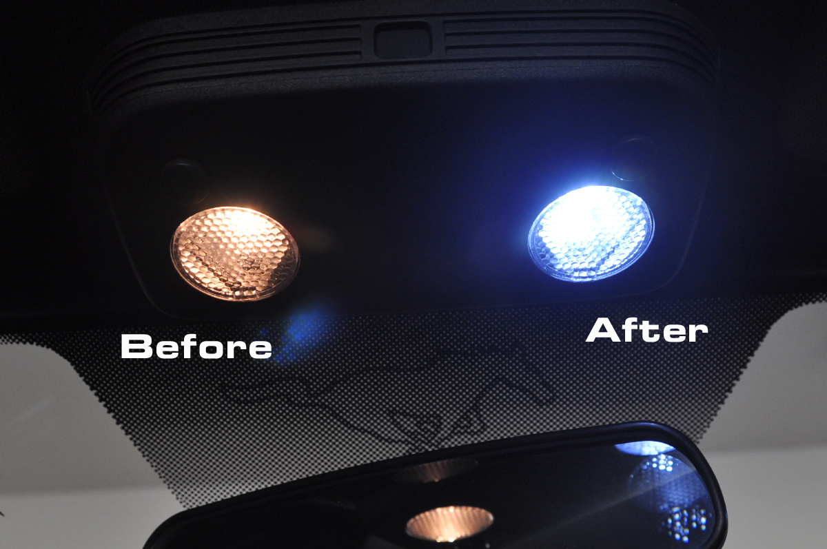

2. LED Lights
I replaced the map lights, trunk light, and license plate lights with LEDs from HIDguy.com. This made a huge improvement all around, especially with the interior lights. The first time I opened the door at night with the new lights, I thought I was being abducted by aliens. The intense white light looks modern and more appropriate for a brand new car, especially one which already has such nice instrument panel lighting. This mod is a must.

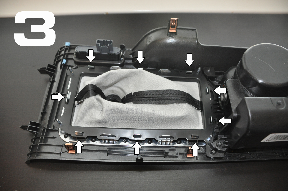

3. Remove the shift boot by unclipping the plastic mounting ring from the indicated clips.

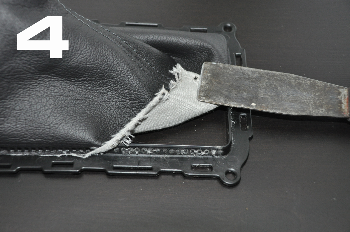

4. Once the shift boot has been removed from the center console trim, use a putty knife, gasket scraper, or flathead screwdriver to remove to separate the shift boot from the plastic mounting ring.
5. I used a hot glue gun to glue the new boots to the plastic mounting rings. Because hot glue guns are dangerous, I had a safety officer present.

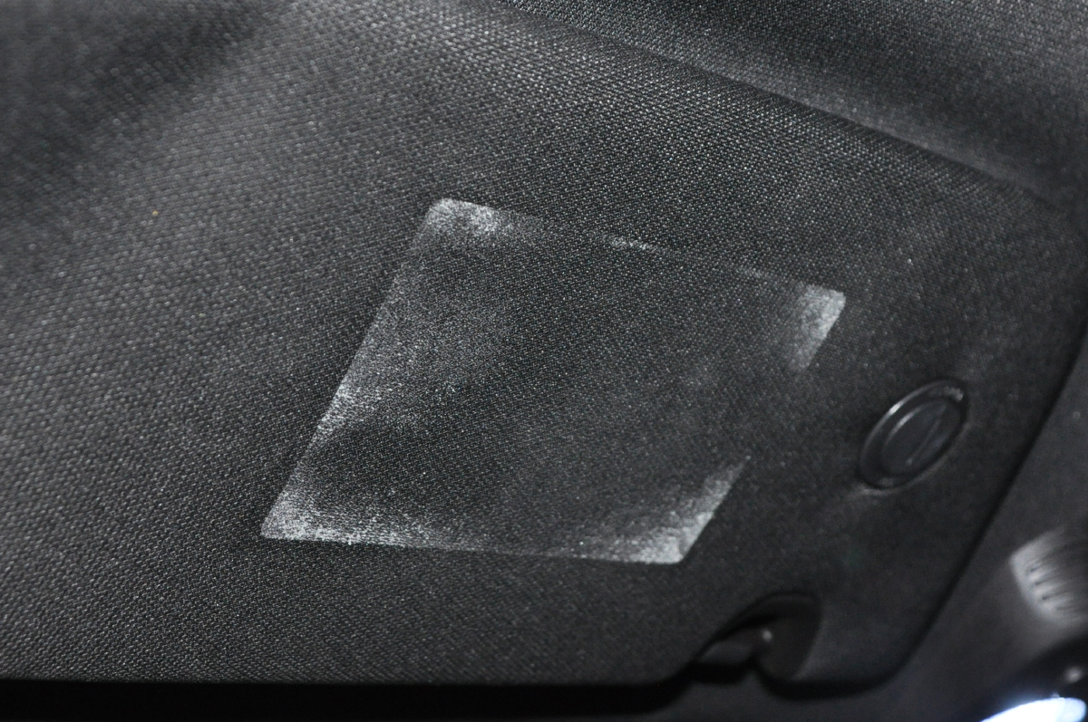

This is what is left after you peel away the sticker (which you can do by hand). On the one hand, there isn't much left and most of it is around the outside edges. On the other hand, the glue really gets into the fabric and is difficult to clean-off.
To remove the sticker, I found it easiest to just work one corner and then work down the side. Once the side is unstuck, you can work you hand behind the sticker and then pull it off. The glue is VERY strong and the sticker can tear. Not a big deal, just work slowly. After the sticker has been removed, I cleaned the residue with soap, water, and Goo-Gone. I tried to use as little Goo-Gone as possible, since it is oil-based and I didn't want to stain the fabric. I won't lie, this required a ton of elbow grease. Way more than I would have thought. So much, in fact, that I was worried that I was going to permanently stretch the fabric from my scrubbing. In the end, it was no problem and the fabric is pretty resilient.

Originally Posted by chief_charlie
Jimmy what is the secret for removing the airbag stickers? How do you do it?
I used a hair dryer to get mine nice and warm before starting to peel it off. You'll have some minor residue left over and I used goo gone like Jimmy although it didn't do much. I think the flash on Jimmy's camera exaggerates the residue. Although I have some residue I don't notice it when I'm inside the car unless I look for it.

Also, to be clear, the photo is from before I cleaned the residue from the airbag sticker. The hairdryer idea is a good one. Thanks!

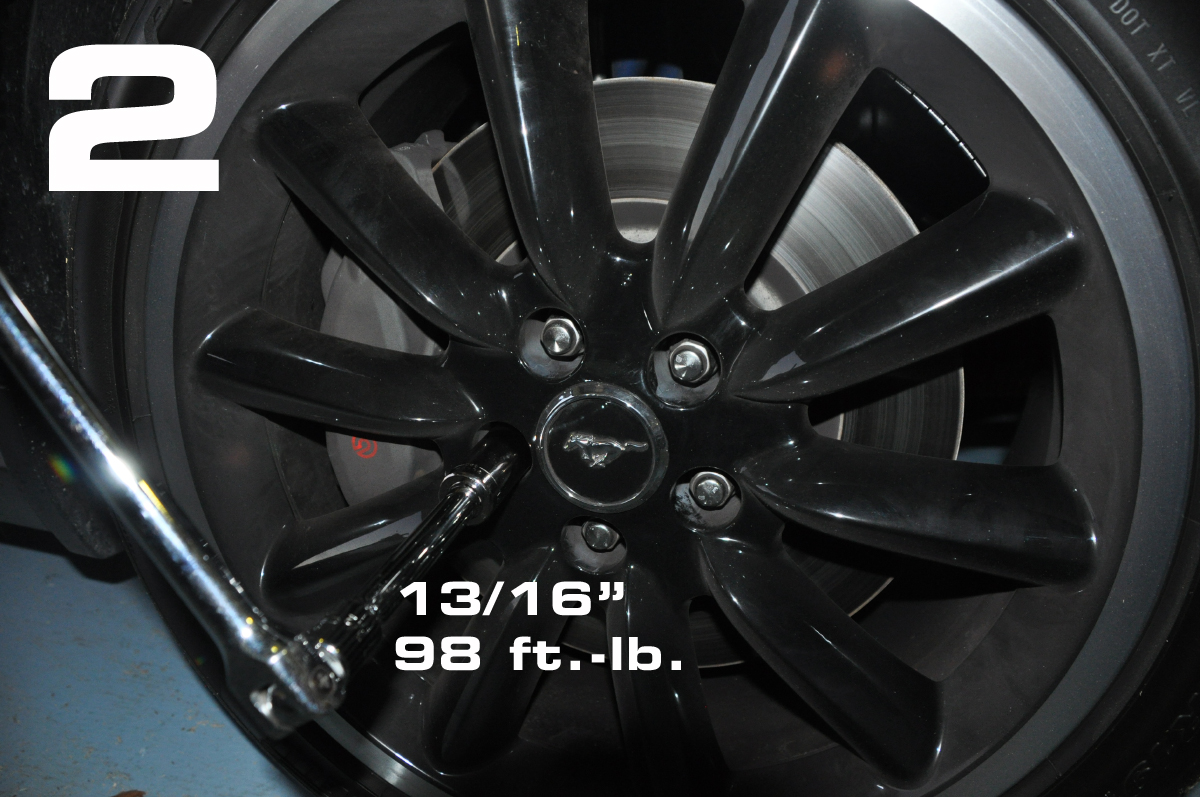

2. Remove the front wheel (13/16″ socket and breaker bar).

13. Cut inner fender liner to clear brake cooling hose. I followed a natural straight line that was in the liner, but it wasn’t quite enough and I had to make another cut to adequately clear the hose. This photo also gives a better view of my tie wrap point and how it holds the hose up off of the cut shark fin.
14. Reinstall inner fender liner.
15. Reinstall brake rotor.
16. Reinstall brake caliper. Apply blue Loctite and torque (2) 15 mm bolts to 85 ft.-lb.
17. Reinstall wheel. Torque (5) 13/16″ lug nuts to 98 ft.-lb.
18. Lower car and recheck all clearance points for interference and free-play.
