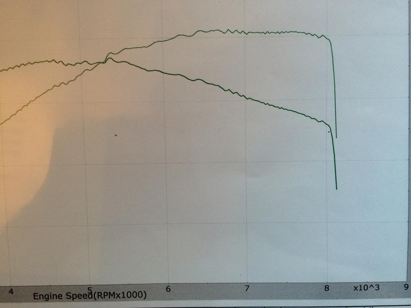

Well, here is a picture of my graph on the AED dyno after Shaun tuned it.

No joke the **** thing stays solid all the way to 8k

True, it continues making power past 7K but it stops increasing. I told Shaun I didn't plan on running it that high, to which he replied, "But at least you know you can." My car had about 2000 miles on it at that point. At the end of the session he said, "Well, your engine's broken in now."

Is it a secret of what your Boss made in horse power and TQ. you ask question here and everyone is happy to give you an honest answer and you leave us with no results. Just a graph on a peice of paper. How do I know thats even your Boss, or a boss at that.
Enjoy your results what ever they may be!

To whom is this directed?

405 baseline, 412 tuned on 91 octane with no mods. As you can see power doesn't fall off at all between 6900 and 8000 but it is not increasing. I have yet to see a Boss graph where power continued building to the redline. My only point was that if all you want to know is your baseline power 7K will tell you that. Running it to the redline is fine but the number will be the same. The OP asked if he should run it beyond 7600. Without a tune you'll hit the rev limiter before that so the question is moot.

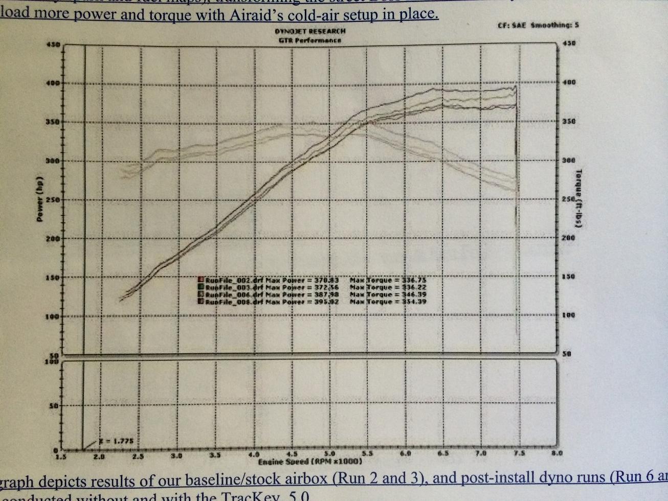

Here is another interesting test conducted by 5.0 Magazine. They compared the silver and red keys with the factory intake and the Airaid Parnelli Jones unit with the venturi tube inserted.
