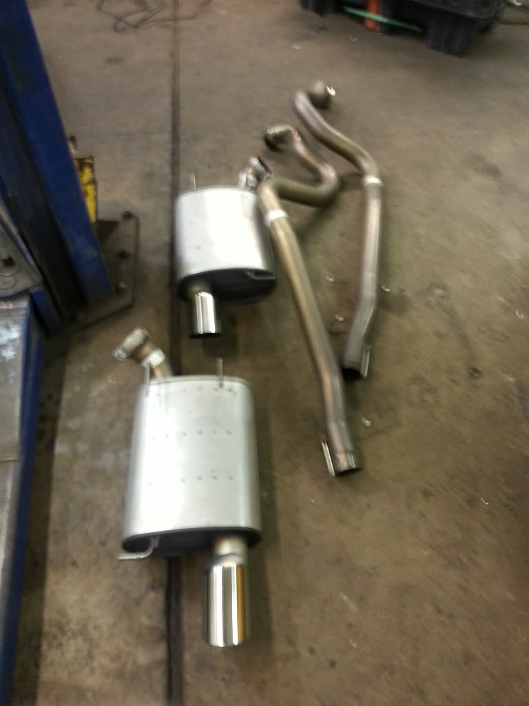

Shelby parts

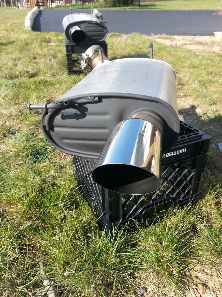

painted back of mufflers

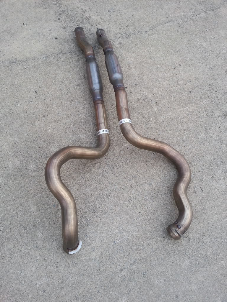

stock pipes
