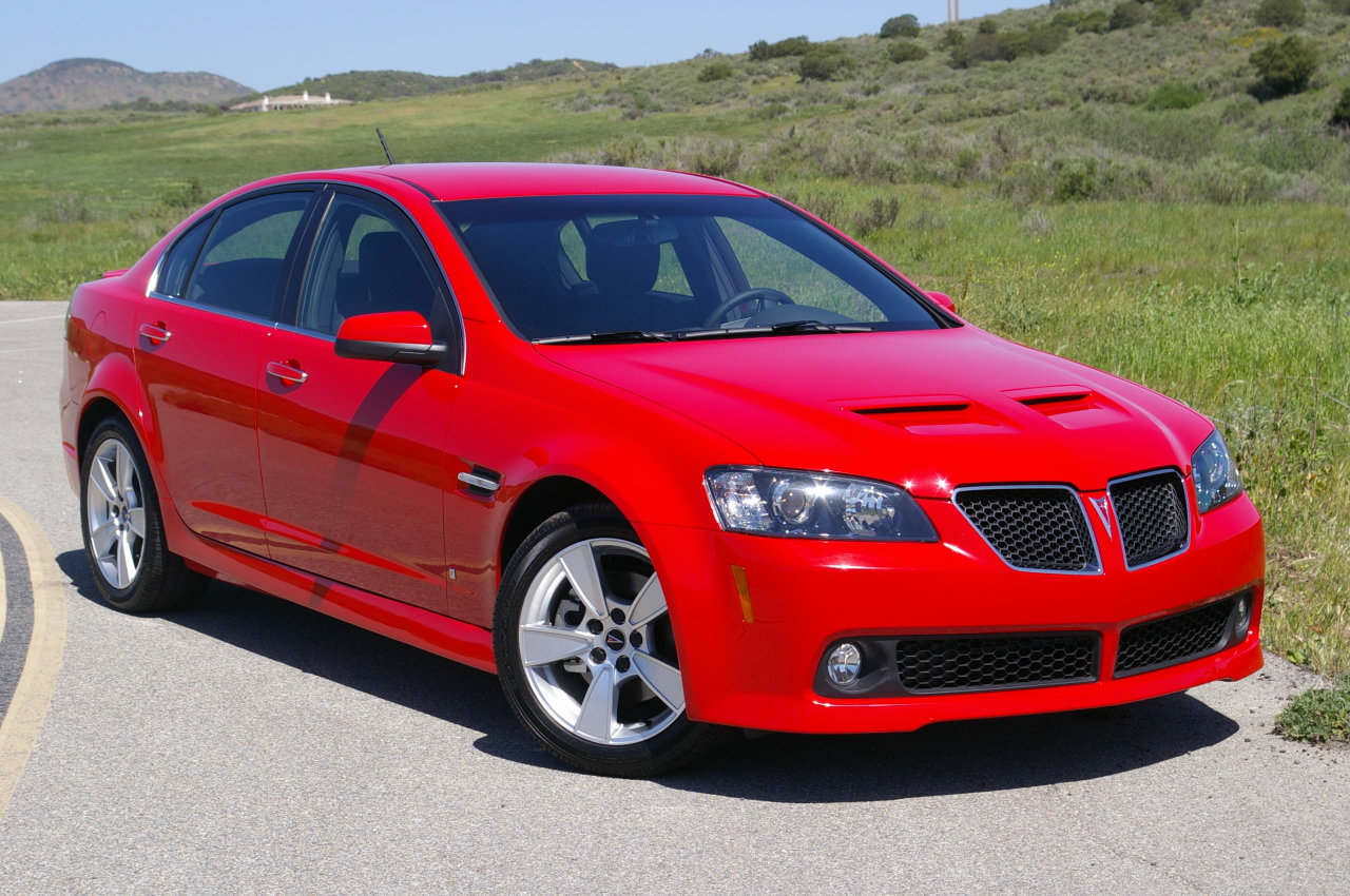

Yeah, I noticed rust on rear axle and front end where I had scraped frame against raised manhole cover (and dented engine's aluminum oil pan, no leaks or other damage visible) and at various other points on frame, brackets, etc. when Mustang was on lift for routine service.
Plan is to address these points with Rustoleum rust converter, rusty metal primer and black topcoat next time I have the car up in the air.
It's just me (being underwhelmed by local dealership) but for a small bit of rust like on the inside of a trunk lid, I would lightly grind the problem area to bare metal with a burr rasp on a Dreml tool, then use a small paint brush to apply primer and color-matched top coat. In cases where folks had entire panels replaced with new, I've noticed mismatched colors. Also, you might have to wait MONTHS for a newly-painted part.
Friend of mine had a rear door panel replaced on his Pontiac G-8GT because there were painting imperfections that only he noticed, could have been sanded, compounded and buffed out (which I offered to do). Instead, he took it to the dealership where he had to wait three weeks (they did give him a loaner) to have the panel repaired or replaced, don't know which.
Not only did the color not match, the replacement panel had really bad orange peel and the door did not fit right.
He wound up going to a local body shop to have the job corrected, paid for it out of his own pocket. Car looks good now. The G-8 is a pretty neat car, very comfy, goes like jet stink and deports itself well on back roads. I think they're still making it in Oz, though not under the Pontiac name.
JMHO, unless it's a high-dollar replacement item, I don't trust dealerships to repair or replace even oil and filter. Find a local shop where they let you hang out and watch work being done.
