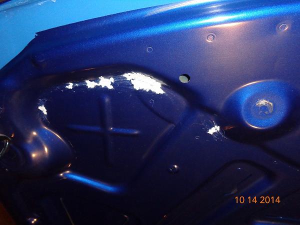

My problem is I want to keep the CS original so no aftermarket hood
I'm disappointed that the body shop wasn't even willing to warranty or guarantee the body repair at all.
At least it would be piece of mind if corrosion comes back and could be "loosely" equated to body work guarantee and workmanship.
They wouldn't hear it. I've never heard of a body shop who won't guarantee their work?
Further confirms that they are aware that the corrosion problem will return. Out of sight out of mind is not fixing the problem!

If the repair is done properly then what are the chances of the corrosion returning?
Anyone speak from experience?
From having experience working at a bodyshop, it will return but not for 5+ years depending on if it is just surface rust or not and if it properly removed and painted.
I wish you luck and hopefully the dealership fix it right

From having experience working at a bodyshop, it will return but not for 5+ years depending on if it is just surface rust or not and if it properly removed and painted. I wish you luck and hopefully the dealership fix it right
Thanks I would be happy with that.
I just can't believe how aggressive the hood cancer was since the first bubble popped up last month.
I have plenty of experience with aluminum corrosion through restoring and maintaining vintage WWII aircraft.
Whether or not the corrosion comes back is 100% dependent on how thoroughly the corrosion is abated and how well surface is cleaned and prepped. Media blasting with fine aluminum oxide or glass beads is a must. This is followed by an acid etch of the cleaned surface, a thorough wash with clean water and complete drying prior to paint.
From what I’ve read the type of the corrosion these panels are coming down with is dissimilar metal caused by steel transfer from the production dies. The bad part is there is no way to get into the folds/seam areas where the issue likely exists and is probably where it’s actually initiating. If the corrosion and/or contaminants are not removed 100%, the problem will be back. If it does come back, there are corrosion inhibitors available that will nearly stop its progress. As long as the bubbling stays on the underside of the hood it’s not quite so bad. If it creeps onto the money side, now it’s an eyesore. My guess is you drive your car all year so road salt is going to play a part in how fast the disease progresses. Keep it clean, keep it treated with inhibitor and keep it as dry as possible.
It’s disappointing but it’s not the end of the world either. I’ve had corrosion (Rust) in the hood and door folds on my old ’86 F-150 and ’03 Taurus for many years. Yeah, it’s getting worse but very slowly…it’s all in how effective your chemotherapy regimen is. I know it’s probably not what you wanted to hear but it’s what I’ve found over the years.
John
I agree... the problem is under the fold- but i still dont think its iron contamination thing as ford was saying, still think its simply the sharp edge of the top panel cutting/breaking thru the paint at the very edge of the crimp... look what i found under the insulation on the wifes 20k 07 mustang- the paint under the hood is not clearcoated/very thin/the insulation chaffed right thru it and bubbles galore hidden underneath, all full of powdery white corrosion
still think if ford just woulda used a panel adhesive/seam sealer to seal the sharp edge, the hem issue would go away- but once it starts, doubtful. the insulation i'll 'plastidip' the topside so its rubbery where it touches the paint... love the cars, but really frustrated at Ford/AAI...they have KNOWN about these hood issues a decade now, still putting out less than chinese quality paintjobs

Took the car in and they are repairing the hood. I.e. Just sandblasting and painting the corroded spots.
Sadly, I know this is just a temporary fix. I'm very disappointed that the dealership wouldn't even hear me out about replacing the hood.
