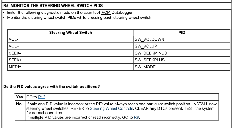

Findings from the test

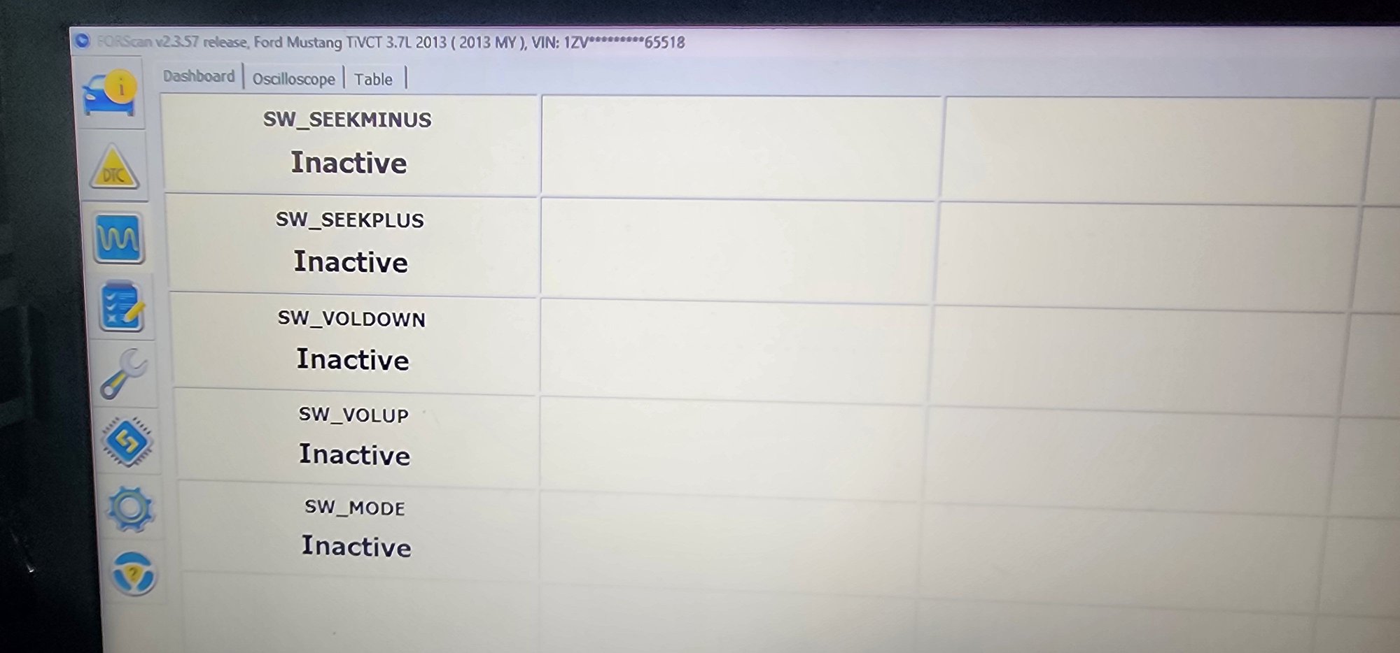

Well I was able to follow the diagnostic as far as looking at the individual PIDs from the switches on the right side of the steering wheel and I found something that's a bit over my head.
The switches show "INACTIVE", but everything else in the vehicle audio related seems to be fine, as well as all the switches on the left side of the wheel including cruise control and heads up display controls.
Here are a couple screenshots of the manual and my findings.
Live data of the audio PIDs.
There was no change to the "INACTIVE" when the buttons were pressed. The data was running when that screenshot was taken, and the radio was on.
Anyone have any ideas? I'm doubting a clock spring would cause only one side of the wheel to go out. The switches don't physically feel the best but all of them are reading the same.
Any additional help would be appreciated.

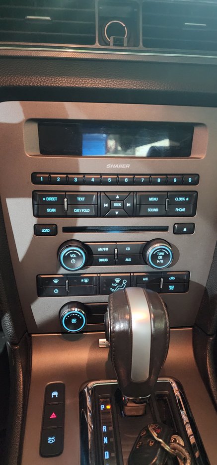

Radio plugs
All connections at the rear of the radio module seem to be as they should. Everything was plugged in and all the wires and connectors look as they should.

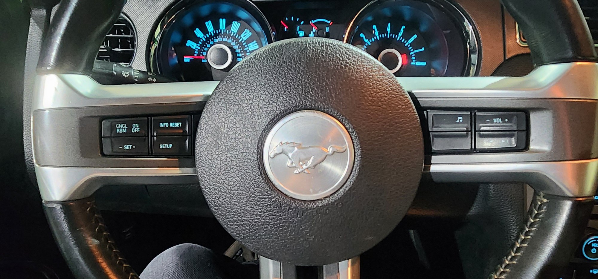

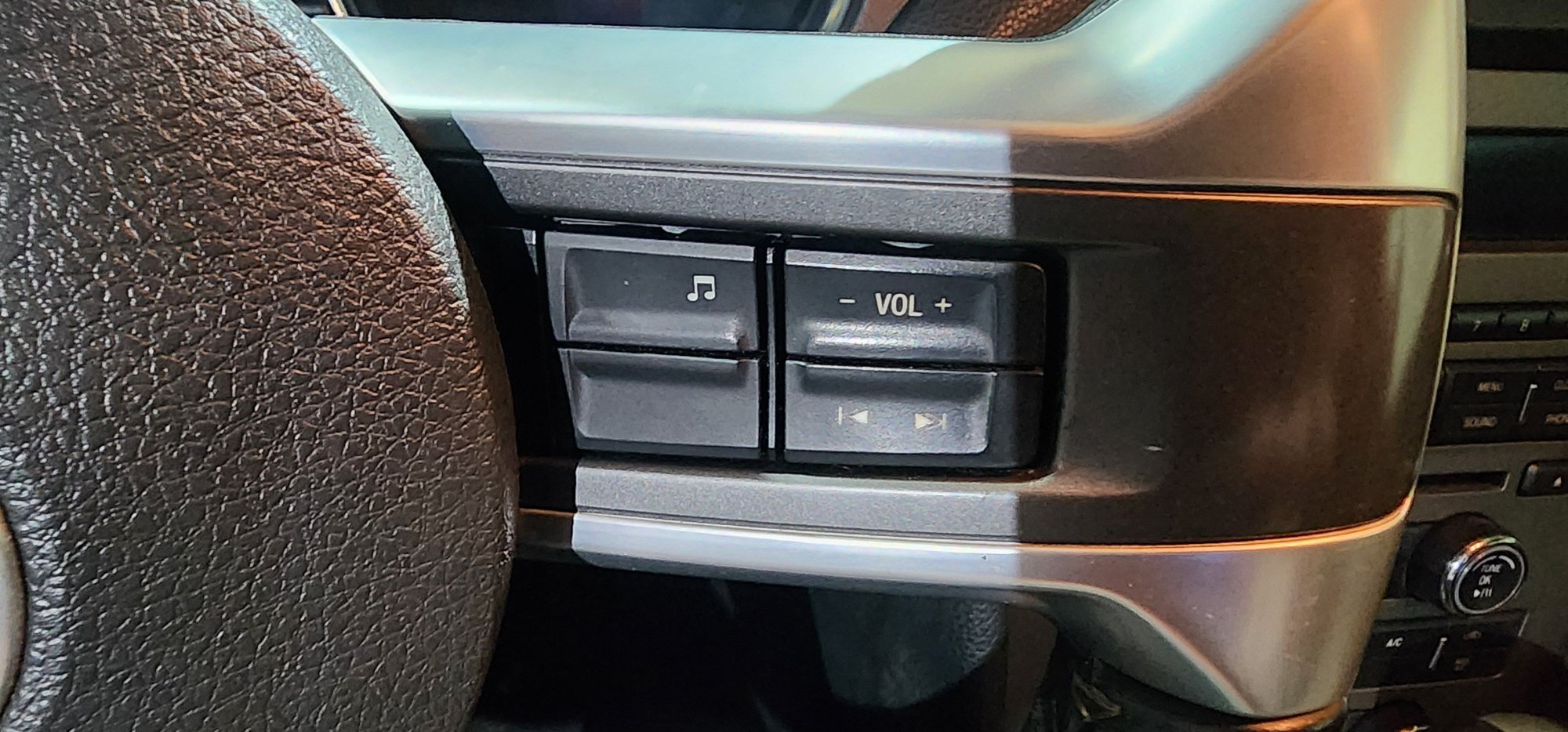

Photos
You might be onto something. This may not be the original wheel.
Here are some photos:

Hmm, Well Yours Does Not Have The Note Figure. Could Be on the Right Track or Newer Service part Switch May Have Omitted it. Will Dig a Bit More. I Thought Somewhere You Said Switch Had Phone Button. I Guess it was Just Radio Had Phone Button. The Note Button is Solid? It Does Not Actually Push in????
KC
Old Feb 1, 2025 | 07:48 PM
Firefighter46's Avatar
The Trouble Shooter!
Joined: January 29, 2025
Posts: 33
From: Roscommon, MI
Yes, just radio has phone button and when I push it nothing happens, but then again it's a non-Sync system.
The one part you included is different from mine in that it does not have the note symbol or the mode button. I'm wondering if that's what should be in place of mine. Maybe it's wired differently.
This interior was reassembled and I'm not sure that all the parts used to put the interior back together were from this vehicle originally.

My note or mode button does push in and is a functional button, it just doesn't work or do anything.
