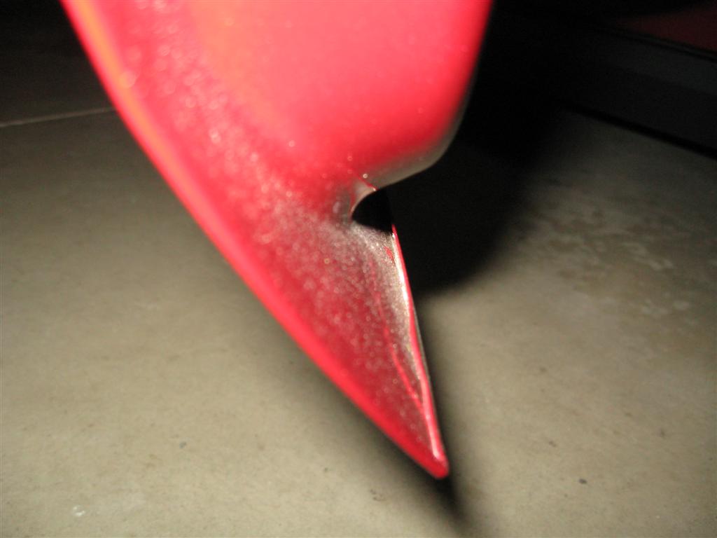

When I look at the bottom of my doors instead of seeing a flat seam where the outer door skin wraps the bottom edge and is normally pinch welded, I see a large V lip that is already collecting dirt (see attached). Is this normal on the 2010 and 2011?
I checked an 08 and an 09 at the dealer this afternoon and they have the normal flat pinch weld. My doors have the flat pinch weld on the sides it is just the bottom edge. It sure looks like it would trap dirt, moisture and salt brine here in MI and soon become a problem.

I too noticed this at the first wash, as my '09 VW CC has sealed seams all the way around the door as does my wife's Passat wagon. This seemed very strange and at first I thought the guy on the line was on break when the car went by.

I have found out that there was a design change in the 2010 Model Year which incorporated a open bottom hem on the bottom door edge on several of Ford's vehicle lines including the Mustang. The purpose of the open hem is to prevent moisture from being trapped in the hem thus causing corrosion concerns. The Paint Department installs a glue stick in the bottom door to bond the outer panel to the inner panel securing the door dimensionally.

LMAO at some of the responses here. It is an "open hem" design that Ford has been using for some time now. If you look at other Ford products you will see a similar non-crimped lower hem flange. It is actually for an improvement in corrosion protection. The open design allows the e-coat and paint to get better coverage in an area that is notorious for corrosion. Plus, like another poster mentioned, it allows for more air exposure to evaporate any water that does get in there. Each of our doors has a built-in tip to it when you open it, any trapped water will flow out of the low point and not collect.
