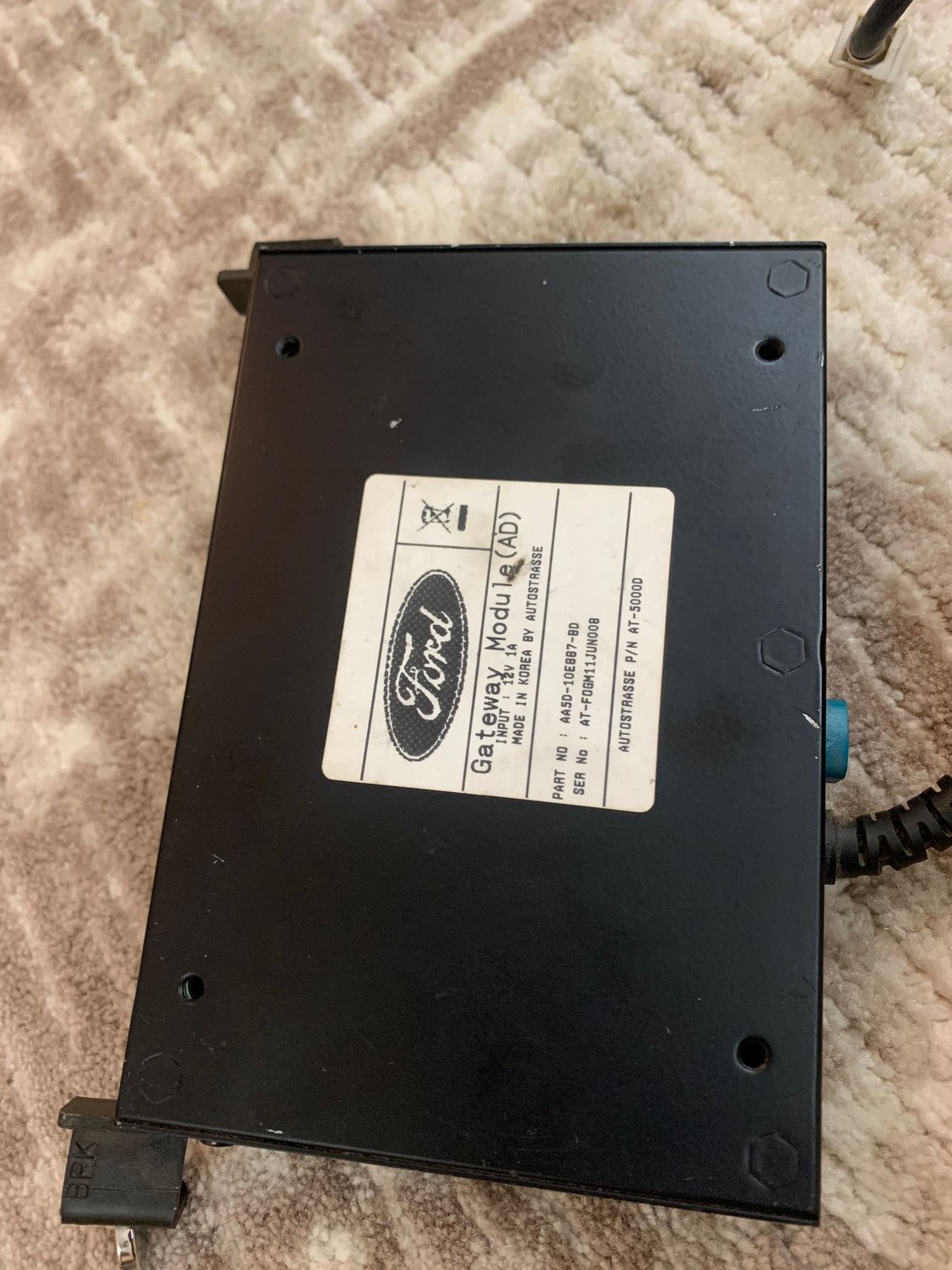

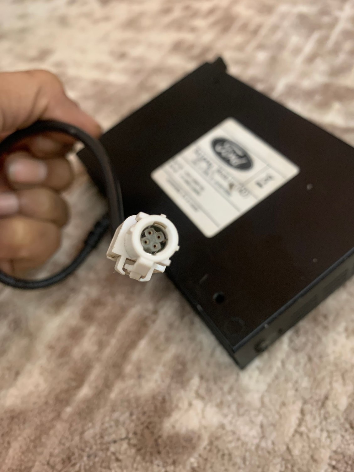

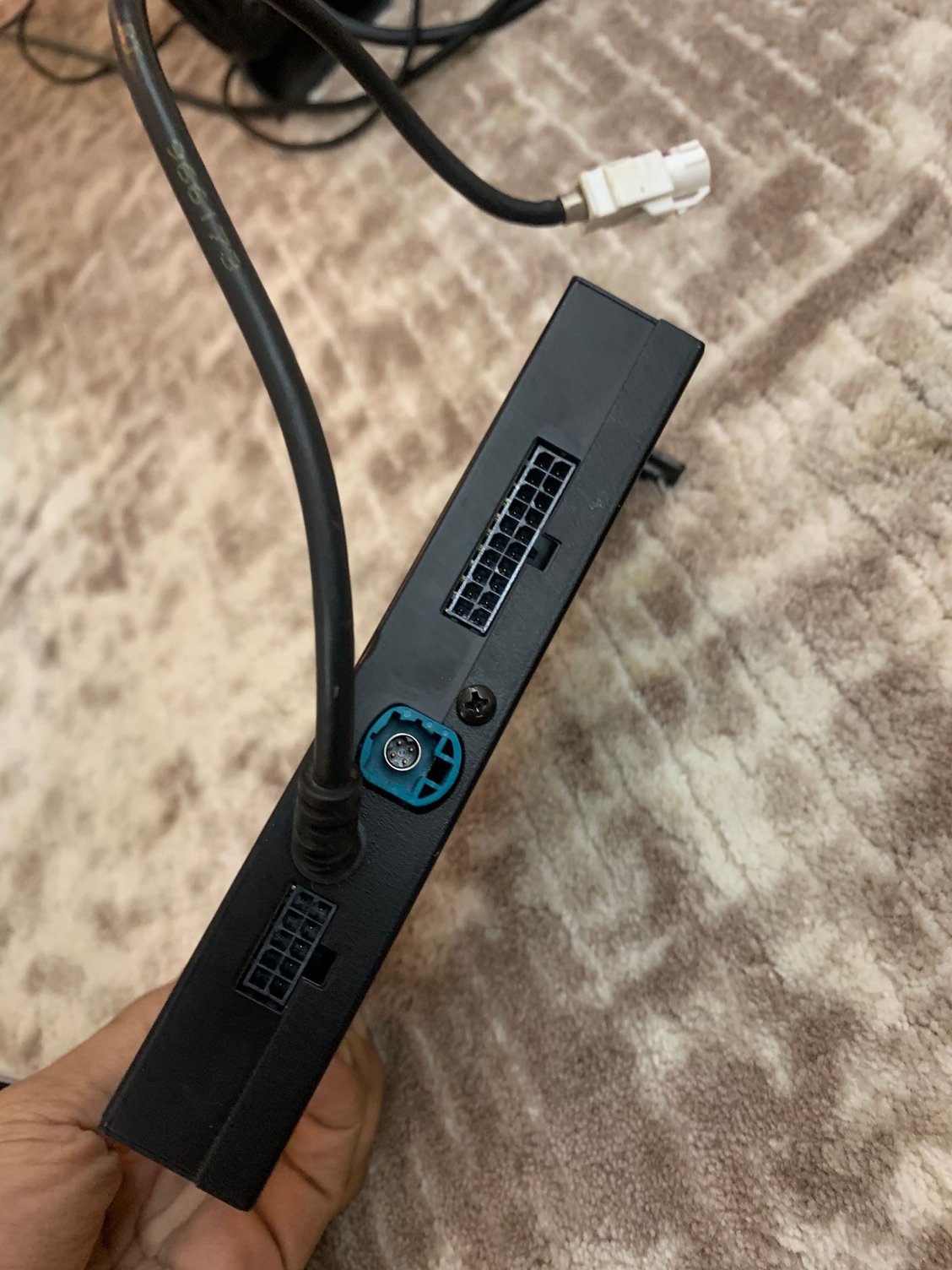

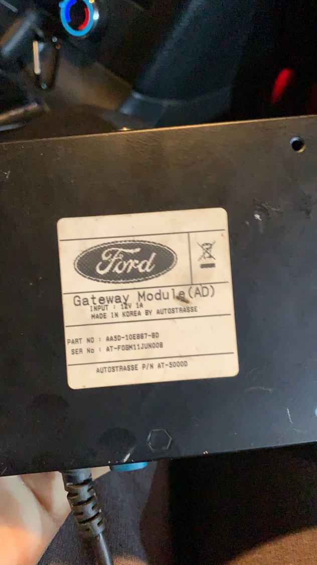

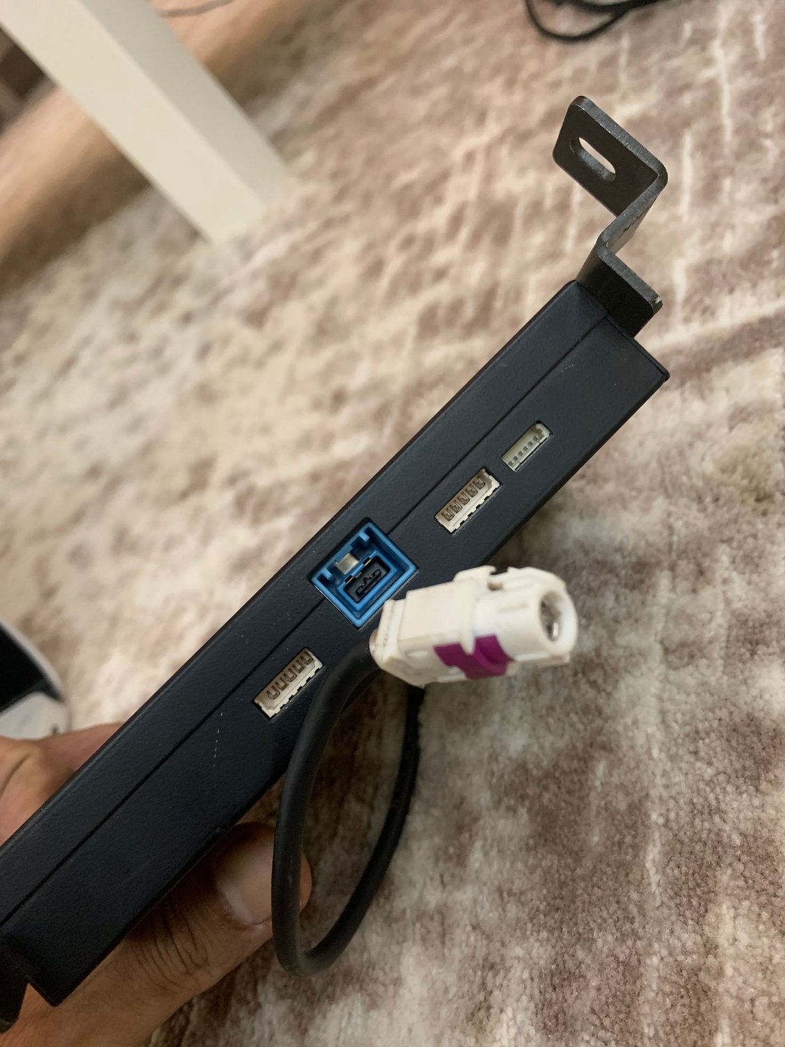

I’ve been going through all my stuff and found this little guy i’ll post some pictures I want know where I supposed to connect it and is it related to this mess ??
it says Gateway Modu
le

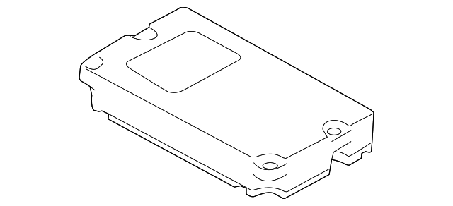

Might be the control module for SYNC? Only thing I could find that looked a little bit like it
https://dz310nzuyimx0.cloudfront.net...fdef303f73.png

That does not look like the sync module. I don't know what it is. I typed in teh part number, but nothing came up on the internet.
Call a Ford dealer and give them the part number. See what they say.
Hey David
Thanks man but it’s not sync module.. is it equipped with our middle east Mustangs that’s supposed to be connected with the screen for The GPS that’s has our maps programmed ..
not important
no it’s a module for GPS programming.. it’s nothing important..
