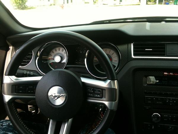

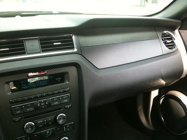

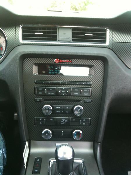

My dash..Vinyl wrapped.
Found another thread on here that had it. I got tired of looking at the fake brushed aluminum.
Scotch print 1080 Carbon Fiber Vinyl

what carbon fiber pattern is it? looks amazing! you gonna do around the shifter?

Called Scotchprint 1080. I got a 60" x 24" roll off amazon. Its not just an "image" of Carbon Fiber. There's actual texture to it.
3M Scotchprint 1080 Carbon Fiber Vinyl Flex Wrap Black CF12 60"x24" : Amazon.com : Automotive 3M Scotchprint 1080 Carbon Fiber Vinyl Flex Wrap Black CF12 60"x24" : Amazon.com : Automotive
Not sure about shifter yet. I have to redo the stereo panel.

Use a blower dryer for the "odd" spots you had issues with, it'll lay alot nicer with some heat.

Already did that, corners just under display started coming up. Yes I used a dryer.

Before you tear the whole thing off get a 3m primer pen and use it on the areas that are lifting. You can get it on ebay for a couple bucks. It really makes complex curves stick well. I did the 3M Di-noc on my dash with the primer and had no lifting. Looks great by the way.

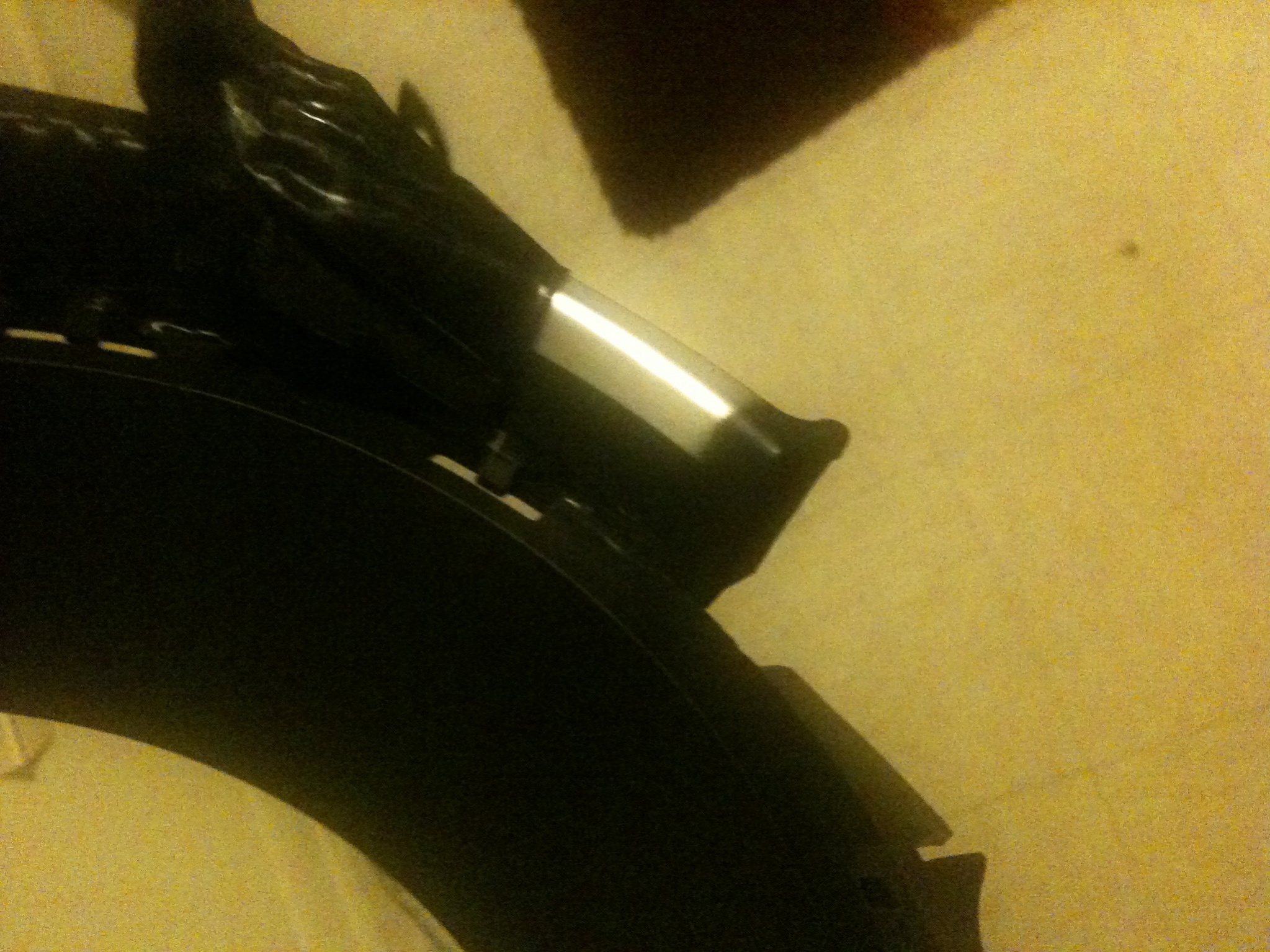

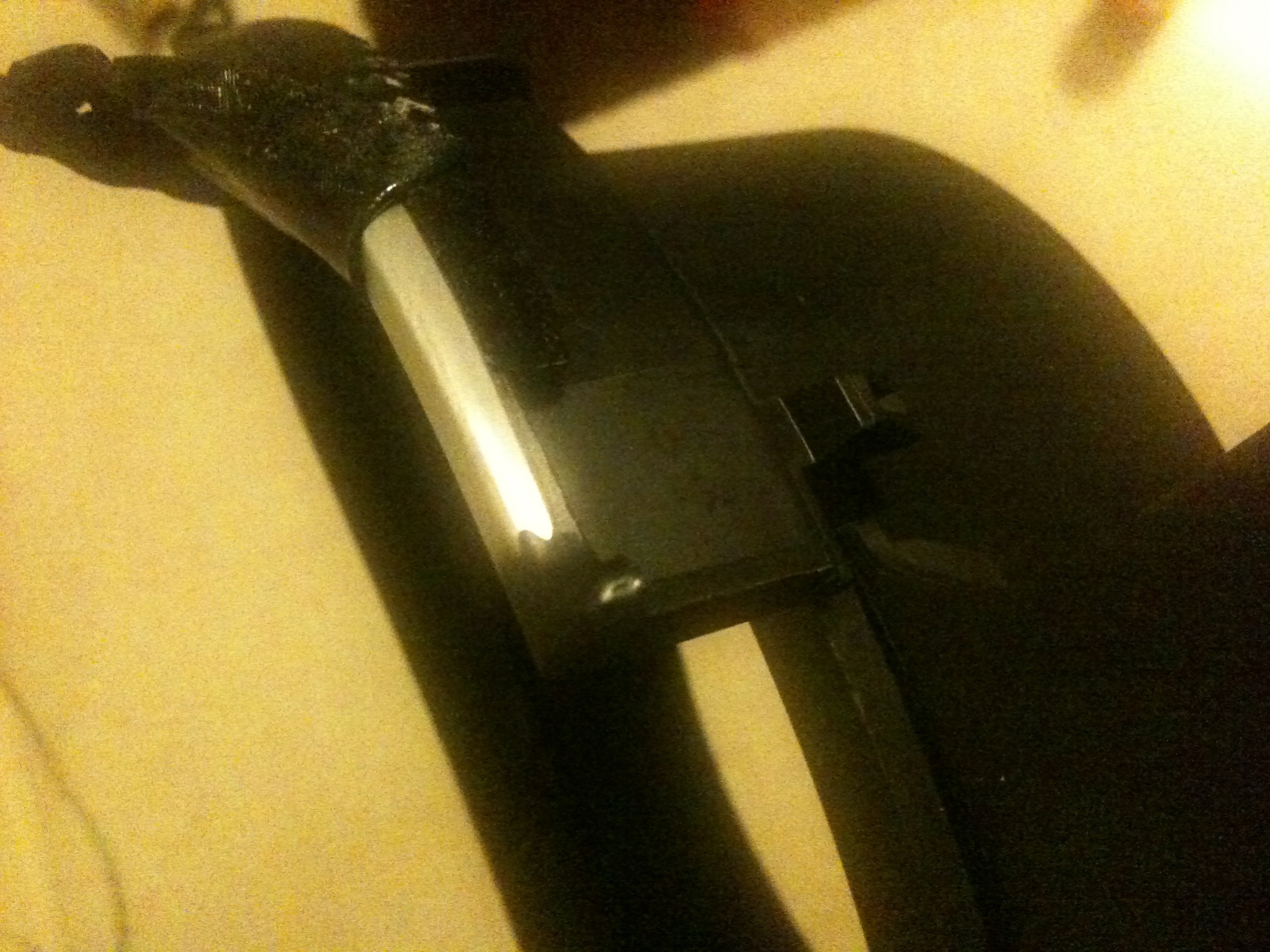

My observation.. its ABS Plastic.
Originally Posted by SwissGT
No, it is indeed real aluminum. It's cool to the touch. Plastic can't do that.
It even says so on Ford's website (not that that makes it true, mind you ).
Good work, though
Originally Posted by brembo12
The net was not bad some 10 years ago....now a bunch of useless information etc.
yes, it is aluminum...REAL....fact is you covered it with some fake plastic
to hell with auto forums...
To hell with what the guy who actually removed and touched the panels says.. Must think the Chrome Bezels around the A/C Registers are real metal too huh?
They are the same panels in the 300A, 400A and 401A interiors just painted different colors. You guys really think they would give the 400A people REAL Aluminum Panels yet the 401A guys plastic coated dash panels for more money?
Have any one of you 3 actually removed and looked at them and not gone by a brochure?
This is the bottom corner of the instrument panel
Oh look, the ****s painted on..

Was this from the look of the back side?
No, I don't think the chrome is real metal. And I am just engaging in a conversation, not questioning your integrity. That is why I asked for the photos, since I don't plan to remove the panels in my car and would not mind seeing what's on the back side.
Since the order guides, reviews, and media release all took great pains to speak of the availability of "real" aluminum trim, I would expect those to be as such. The other dash colors (like the GT500 and Boss 302) I have not observed closely enough to make a comment on what forms the material. I have seen that referred to as "dark aluminum". And as there are other elements that make up the interior styling for the 401A versions, it would seemingly account for the cost differential.
As mentioned above, I have not removed them. To the touch, they feel like aluminum pieces. If it is merely a matter of marketing speak that identifies something that is a plastic form with a thin "coating" of aluminum-type material, then there is a bit of sleight-of-hand there.
I can't tell exactly what the part is in relation to what you are describing. If the perspective was a little further back, I would like be able to see what you are describing better.
