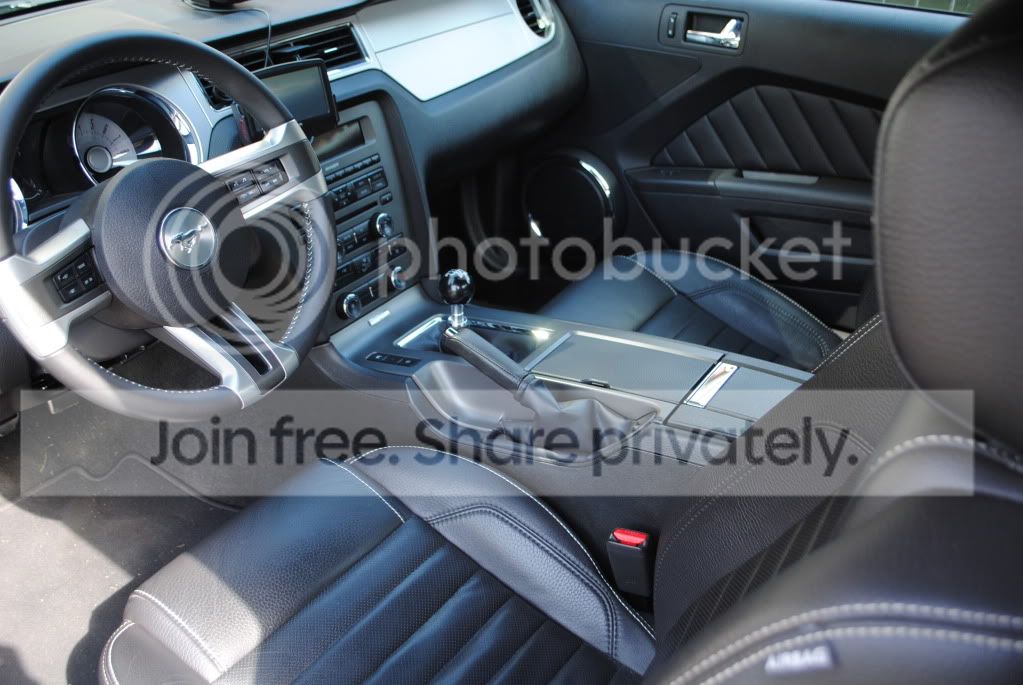

Not that there was anything wrong with the old one....but this looks better
Old
New - Black Boss shift **** and boot

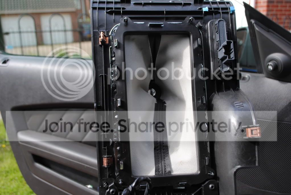

A word of caution to anyone thinking of this simple mod - you must buy a new boot to match the Boss shifter.
Installation is easy
Remove console - it just lifts out.
Release all elctrical connectors - they are shape and colour coded.
Its necessary to completely lift the console clear to get at the shift boot clips under the chrome trim surround.
The clips are pretty tight but work from one end to the other and they surrender.
Clip on new boot
replace console and screw on new shift ****. 30 mins tops.
