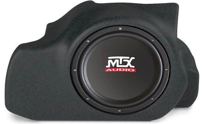

That said, they're not *bad*, and if it were lower/harder hitting bass I'd pretty quickly just get a box or two in the trunk with 12s or something back there and be done with it, let them door subs ride or just disconnect them. You can tap directly from the speakers in the back as again the signals are straight full audio signals, no cutoffs in the head unit. All your bass will belong to us... or the amps anyway.
Catch a ride on those signals, send it to the amps, and Bob's your auntie, the car will go Boom.
