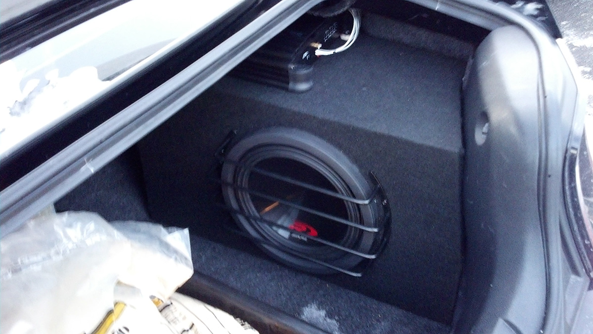

Hey guys, I just wanted to post a build that I just wrapped up and I gotta say, for the amount of money I spent, it sounds incredible. I've been hugely into car audio since I started driving and have always leaned towards focal/JL/image dynamics and other high-end gear with full interior pulls for sound deadening/re-wiring but with this car, I didn't want to dump a ton into audio since I'm routing so much money into the performance side of things so I decided to turn it into a challenge for myself. I wanted to spend less than $500.
I opted to keep the deck because from a functionality standpoint, it covers me, and I suspected that the muddy distortion was coming from the stock speakers and not because of poor processing on the deck itself.
It was a challenge to find great sounding speakers when only working with 15 to 20 rms. I've seen a lot of folks throwing in infinity, jl, alpine, etc. component speakers while leaving the stock deck in place and that is a disaster waiting to happen. It's far worse to under-power a speaker than to over-power it. I cringe when I see stuff like "I upgraded my speakers but now I have to crank the volume higher to reach the same levels as before". If your running the stock deck with high-end speakers google up clipping. Anyhow I had a chance to hear these $50 kickers in best-buy and they sounded great. I found them at walmart for wicked cheap so I grabbed 2 pairs. I've been a fan of alpine type-r subs for mid-level builds and at $139 they are hard to beat. I'm usually not a fan of crutchfield at all since they are notoriously over-priced but I happened to find a nicely matching amp (w/ load is @ 2ohm) also by alpine for $129. This particular amp has speaker level inputs so no need for a line-out converter, I just tapped the signals going to the newly mounted rear speakers. I also picked up a wiring kit which blew my budget BUT then I decided that wiring didn't count : o ).
I usually build my own boxes but I've heard good things about zenclosures and decided to give them a shot. I couldn't have been happier, just make sure to provide the exact cutout dimension you need for your specific sub to ensure a perfect fit. I opted for black because I felt like black would be better than "close to matching" charcoal.
The whole build took a little less than a day, it was slow due to the weather around here plus I like to take my time.
Build list:
2 pairs of Kicker CS68 - $116 (Walmart)
Kenwood Alpine MRP-M500 - $129 (Crutchfield)
Alpine Alpine SWR-10D4 - $139 (Sonic Electronix)
Zenclosures 10” trunk enclosure - $115 (zenclosures.com)
EFX 8-awg wiring kit - $49 (Crutchfield)
Anyhow, for those looking to upgrade without spending a lot, the above worked quite nicely for me. Here is a pic of the zenclosure with the alpine amp mounted on top. I go to track events so I wanted this setup to be easily removed on track days. Also, the amp's end-caps are off so I can tweak things over the next few days, otherwise you'd see zero wires.

I've got the base radio as well. The only extra items would be wire taps for the door & rear deck speaker installs, 4 crimp connectors for the auxiliary speaker input on the amp, some thick speaker wire (8 to 10-gauge) to run from the speaker to the amp and then some thin (18 to 22-gauge) to run from your rear speakers into your aux input on the amp. All of that can be had for $15 at your local home depot. Don't buy a roll of thick speaker wire, they sell it by the foot in the electrical section, you only need 6' or so.
Here is the guide I used for wiring the amp itself. Of particular interest is his use of the antennae for a 12v remote feed for the amp, just tap that blue wire and your good to go.
Also, for the rear speakers, use an 8mm (I think it's 8mm, double-check) socket with a ratchet. This will allow you to take out the speakers without removing half of the rear interior of the car! Lastly, these speaker adapters use the factory adapters so you can just plug the new ones in without having to tap the wires and such.
If you think it will help, I can scribble down somewhat of a wiring diagram, just let me know.
This amp paired with this sub hits very very very hard.
-m
