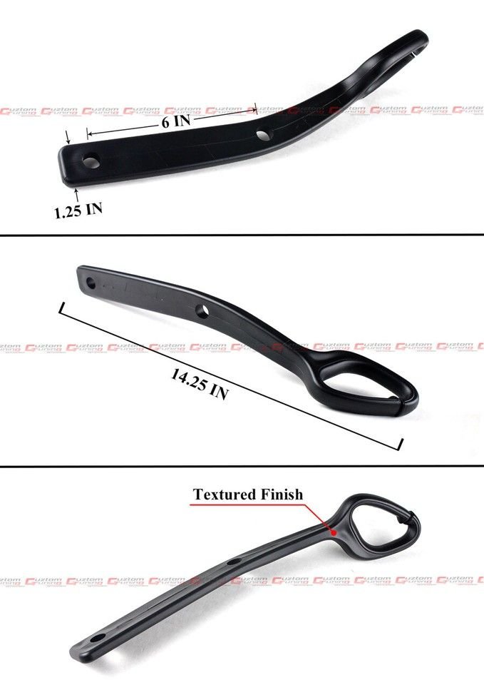

Hey all, I just want to report that the 2015-2022 Mustang Ecoboost seatbelt guides will fit the 2010 (and probably many more years, if not all of them). Which as you know, the 2010 did not come with them. Not sure but I think they were introduced in 2015. I took a chance and ordered a pair from the newer ecoboost model because I got tired of wrestling to find the seatbelt all the time. I figured if they didn’t fit, I would try to plug and redrill the holes, but I did not have to do anything. They are a direct drop in fit.
I will try to take pictures this weekend as it is dark here now. But it was just a matter of removing the headrest, installing the guides on the headrest rails and putting them back on, simple 2 minute job. Now I can just grab the seatbelt easily and go instead of groping around trying to find the seatbelt.
Hope this helps someone
edit: this photo is the actual guides I used, I took it from the original ebay listing

So these go on the seat head rest? My 2013 has pseudo guides that are attached to the B-pillar and turn accordingly. But nothing attached to the seat. If you can, I'd like to see them in your car

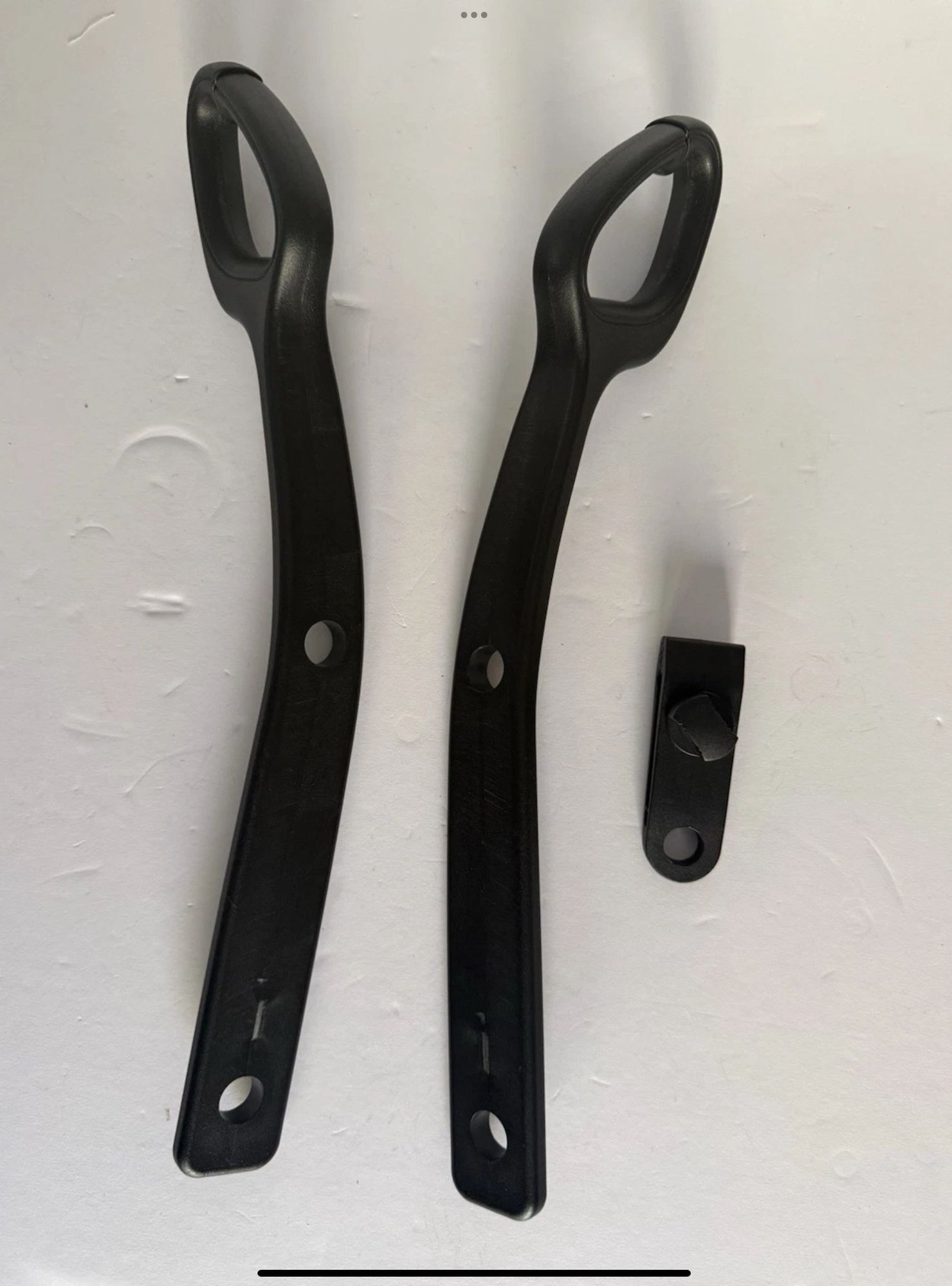

I won’t be home until Friday evening but Test Member 1 just posted pics above and that is exactly what mine looks like. They attach to the headrest

Anyone know the hole spacing? Maybe they'd fit earlier cars?
