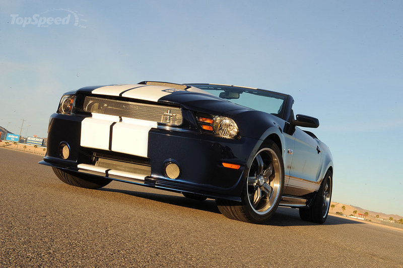

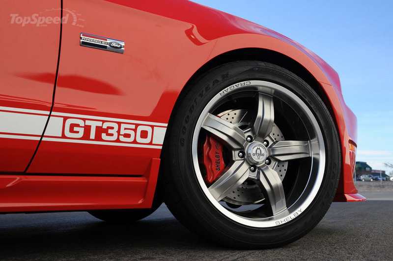

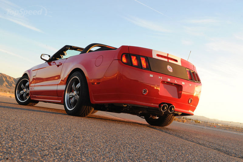

I got the 265 wide/square tire thought from seeing the 2011 & 2012 Shelby GT350. Their OE fitment is: 265/40/19 on 9.5 Cragar wheels having + 30mm offset. I think it’s doable on my '14 GT, but we will see. In the meantime, here’s a few pics for you:
