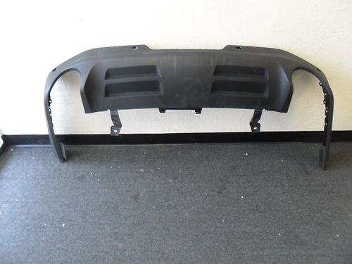

Has anyone tackled installing their reverse sensors into a Roush rear valence on a 2012? I've seen the write up elsewhere on doing it to a GT500 valence. The Roush valence seems to not have a fully flat area like where they'd sit on the stock valence. I'd have to look at it in person when it arrives this week to see if I can mount them flush in a similar to stock location. Anyone have any suggestions or info as to where you think they'd fit on this thing or where you'd try and put them? I got it because I found it on sale along with the square tips and I like the square tips and I'd rather have them then buy the round replacement tips for 65 bucks a piece. I've survived with every other car without reverse sensors but they're a nice feature to have and I'd like to keep them.
Any suggestions as to where you might try and put them? That crease just down from the upper edge I don't think is flat in there. To me it's either on that very upper edge, the top face of the crease which seems angled downward though. The other thought I had would be lower on the diffuser in those vertical pieces, or in the flat areas between them inboard of the exhaust openings. I guess in reality I could put them wherever I want but I want them to function as close to stock as possible.

Now that I really look at the stock valence, the area were they're mounted is slightly angled downward and the mounting collars position them so they point straight back. Maybe this can work....

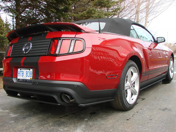

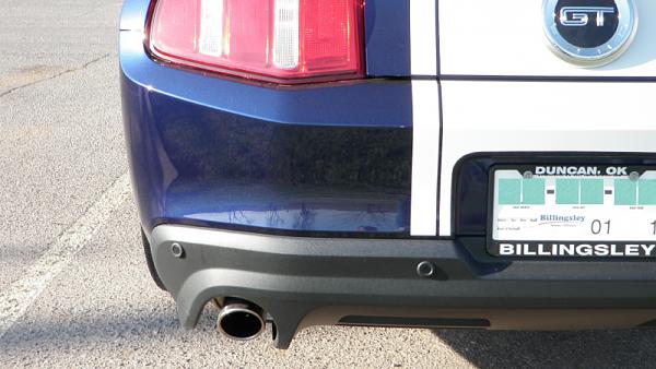

Here's what I could find with rear sensors...mostly Gt. maybe you can use for reference.

I would think the best spots for the roush valence would be on the areas where the lil fin meets the body of the piece. Four spots right there

Gonna be tough install. You also need to make sure you have enough room behind the area to fit the sensor and wiring harness.
I guess you could possibly spread all 4 of them beneath the license place area. But not to close to the vertical pieces or teh sensors may detect them.
I don't really see anyway of mounted them on the corners to get corner warnings like the factory setup.
