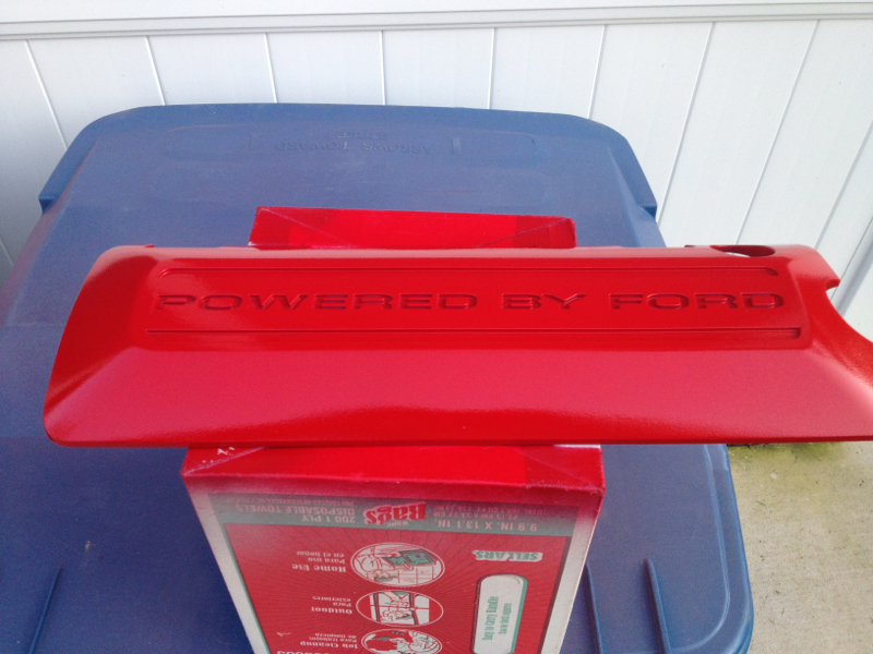

The reason why I'm worried about the clear is because I painted my coil covers today and I didn't realize how much work it is to get the clear coat to look good. I spent a lot of time on it, and it's still not anywhere near as glossy as I would like ( see pic). From what I've researched, matte clear is a little easier because you typically don't wet sand it. Let me know if you've got any pointers!

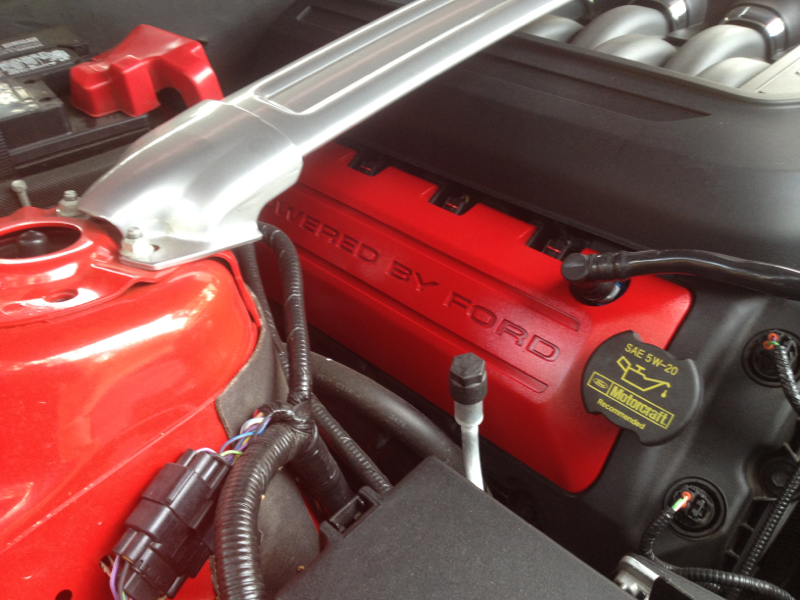

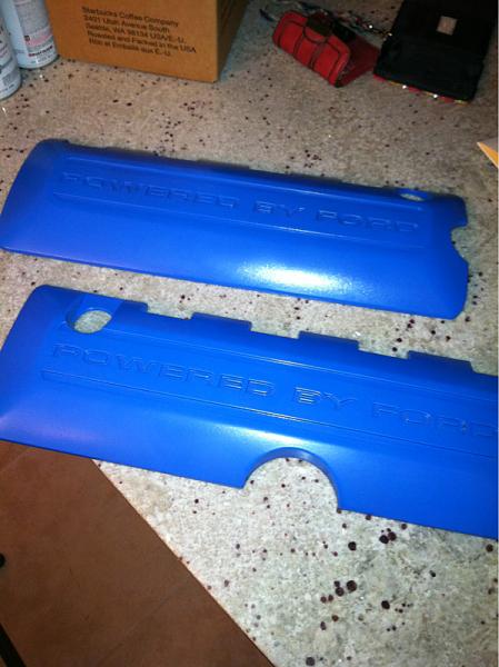

The super shiny gloss on thr coil covers wouldn't stay great looking anyway under the hood with the heat. I wouldn't go with heavy coats. Too much chance for runs. Go with 3-4 light coats of color and clear. And the coil covers are textured so harder to get a glossy shine.

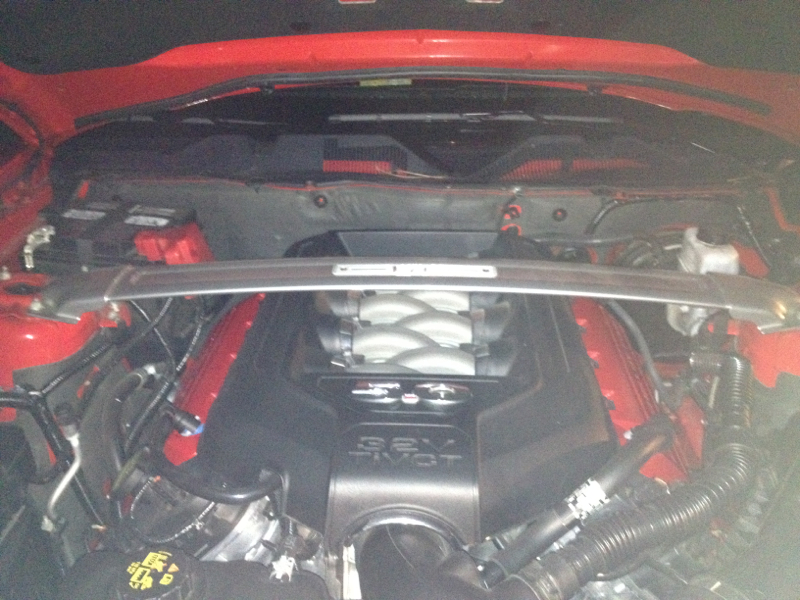

Looks good. Was dark when I popped mine back on. Need to get some pics in the light

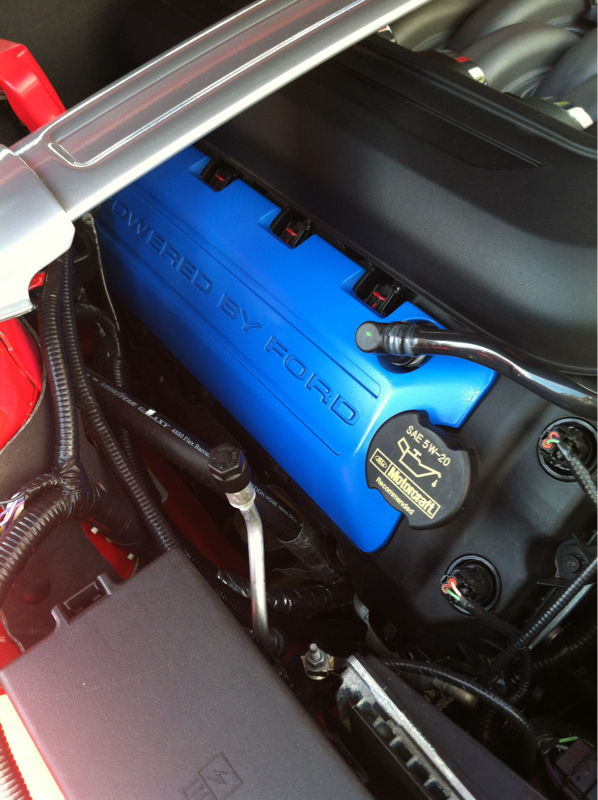

Better pics. In direct sunlight closer than it looks in this pic. I used Duplicolor Cardinal Red.
