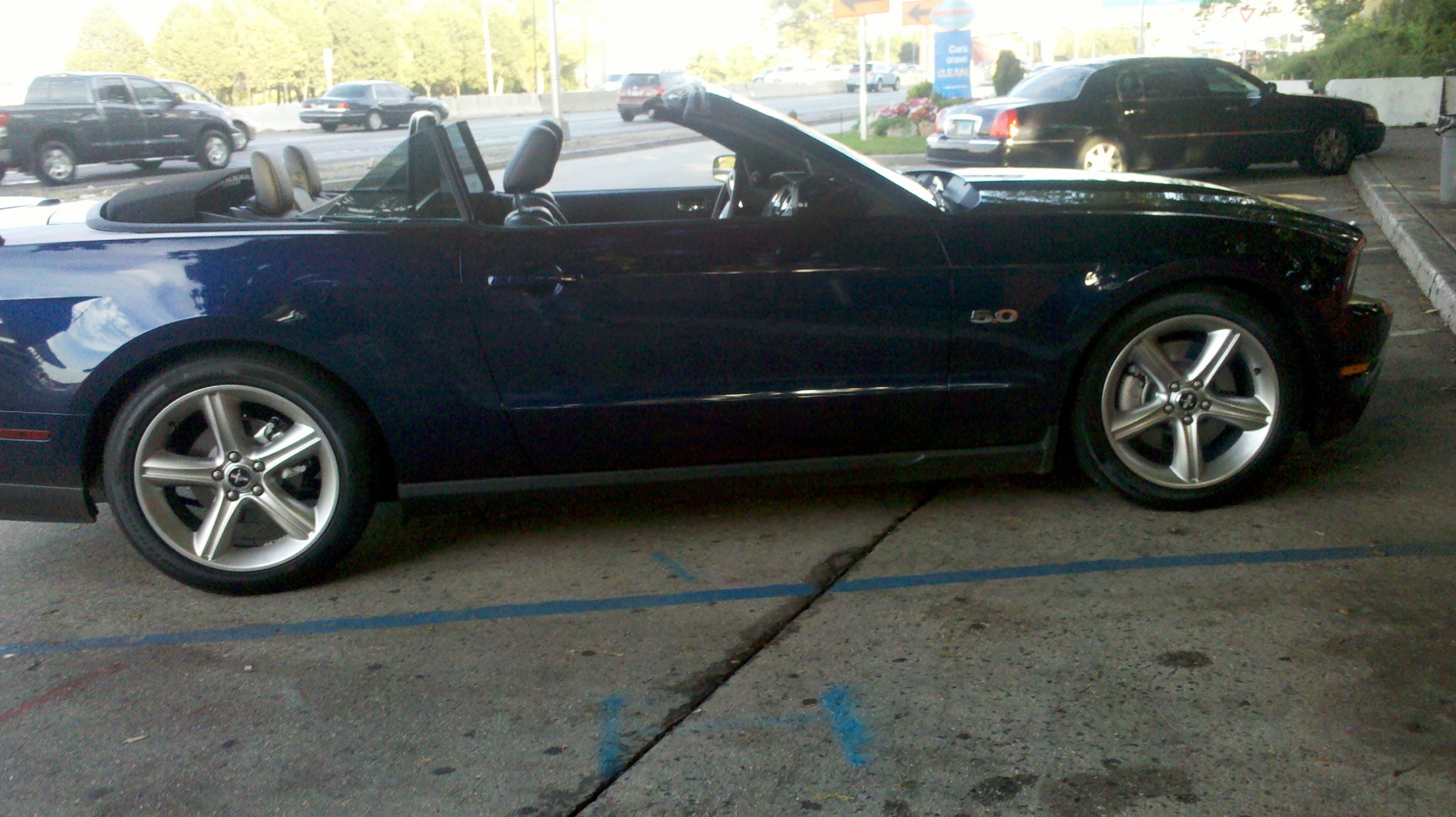

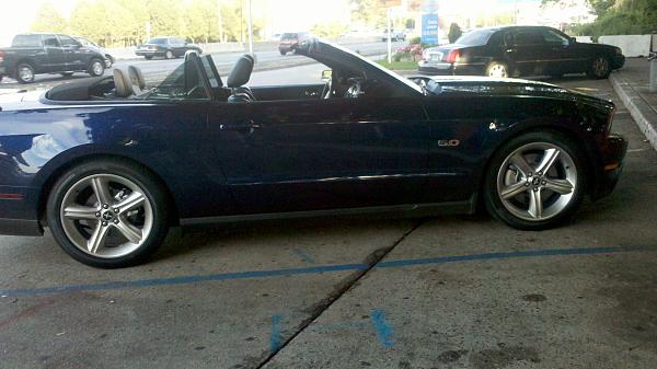

Originally Posted by shotzy
Mine is a vert which is completely different suspension or at least rides like one. But the 1 inch lower FRPP handling totally changed the whole car. The ride is great and in the corners
I actually scraped the stock ride because it had so much bounce( again it is a vert so yours might be different). I would have to go real slow out of my driveway. Now I leave it like all the other cars I have owned with no issues at all.
Very interesting indeed. Do you have any pics?
Old Aug 17, 2010 | 08:59 AM
shotzy's Avatar
Joined: August 4, 2006
Posts: 383
Here you go. Not very good I know
Attached Thumbnails Lowering and Ride quality-0731101517.jpg   Lowering and Ride quality-0731101517a.jpg

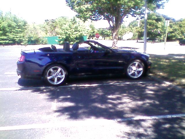

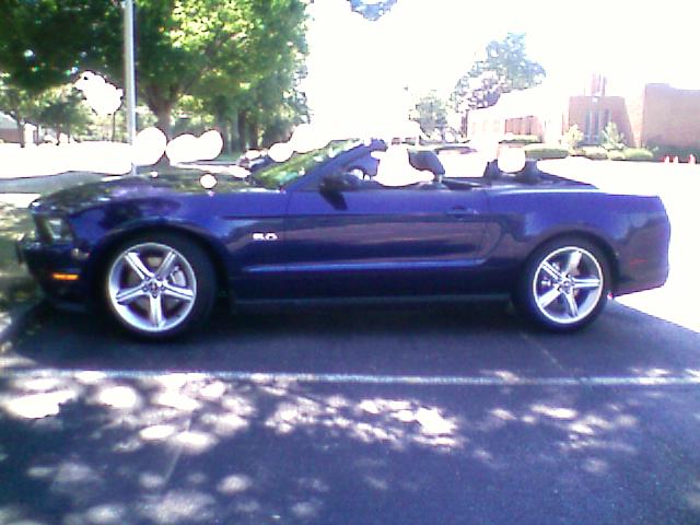

Well I finally got some better pictures.
Well I guess only a little better....lol
Attached Thumbnails Lowering and Ride quality-2010-08-17_18-17-27_801.jpg   Lowering and Ride quality-2010-08-17_18-17-47_802.jpg
