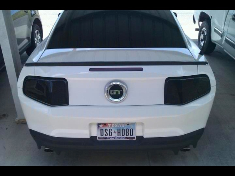

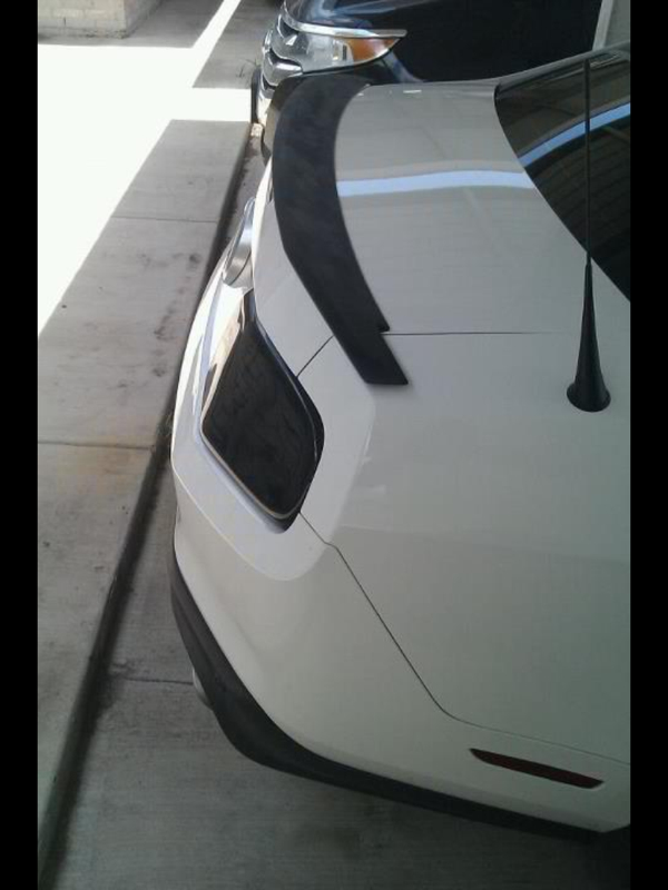

I ve been wanting to plastidip my spoiler for a few weeks now and I finally decided to do it. I ve never plastidipped before and it came out kinda ****ty. From far it looks fine but up close you see the ****tyness. I think i ll redo it later and do lighter coats. I love the look it gives it though!
Anyone have any plasti dipping tips?
Thanks in advance
Looks pretty good here!
Not soo much here :/

Did you strip the wax from the spoiler before spraying it?

I actually had just had it washed
That could be your problem. Preparation is the key to a good paint job. Prior to refinishing, after you remove the current plasti-dip, clean the entire surface with Mineral Spirits or plain alcohol. Do this twice, using clean, lint free cloths. The car wash most likely left a residue of detergent or wax on the spoiler. Hope this is helpful.

Thanks, hopefully i can redo it again tmw. I ll keep the you all posted

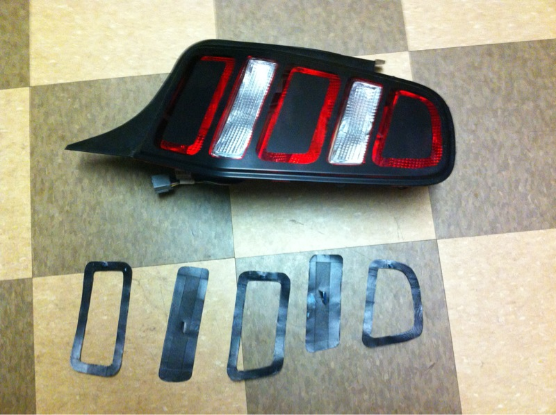

Attached Thumbnails First Time Plastdipping.....kinda ****ty-image-3709304520.jpg

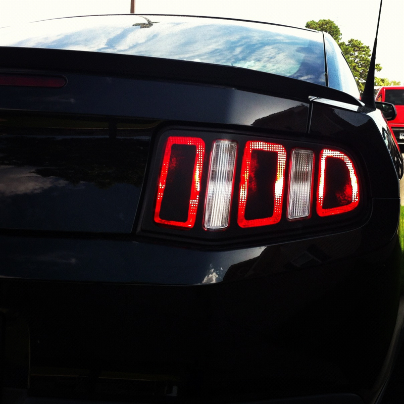

I have a thread about it...
'13 style tails plasti-dip on '12
Night pics coming soon!
Attached Thumbnails First Time Plastdipping.....kinda ****ty-image-231123448.jpg   First Time Plastdipping.....kinda ****ty-image-1265015298.jpg
