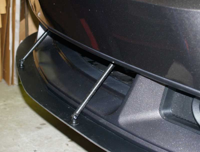

Sintra is the stuff to use. It is PVC plastic but in a foam. the sides are smoothish like a matt finish. 1/4" Sintra weighs less than 1/8" ABS and it is stiffer too. It works like wood. Come in black so you can just sand the edges smooth and seal with some clear if you're inclined doesn't need it.
Did you make your own splitter? Got any pictures/write-ups of your process?
I'm wondering if I have to reinforce the front fascia where the splitter will be attached with backing plates. If so, I was thinking of using 1/16-inch aluminum.

Posts: 864
I used tee nuts on top of the valance and flat head bolts on the bottom. I also ran the splitter all the way back to the radiator support eliminating all the other plastic under the front. I ran this for about a year then went a much bigger carbon fiber splitter. I don't have any process pictures of that first splitter.
Wow, well done!
