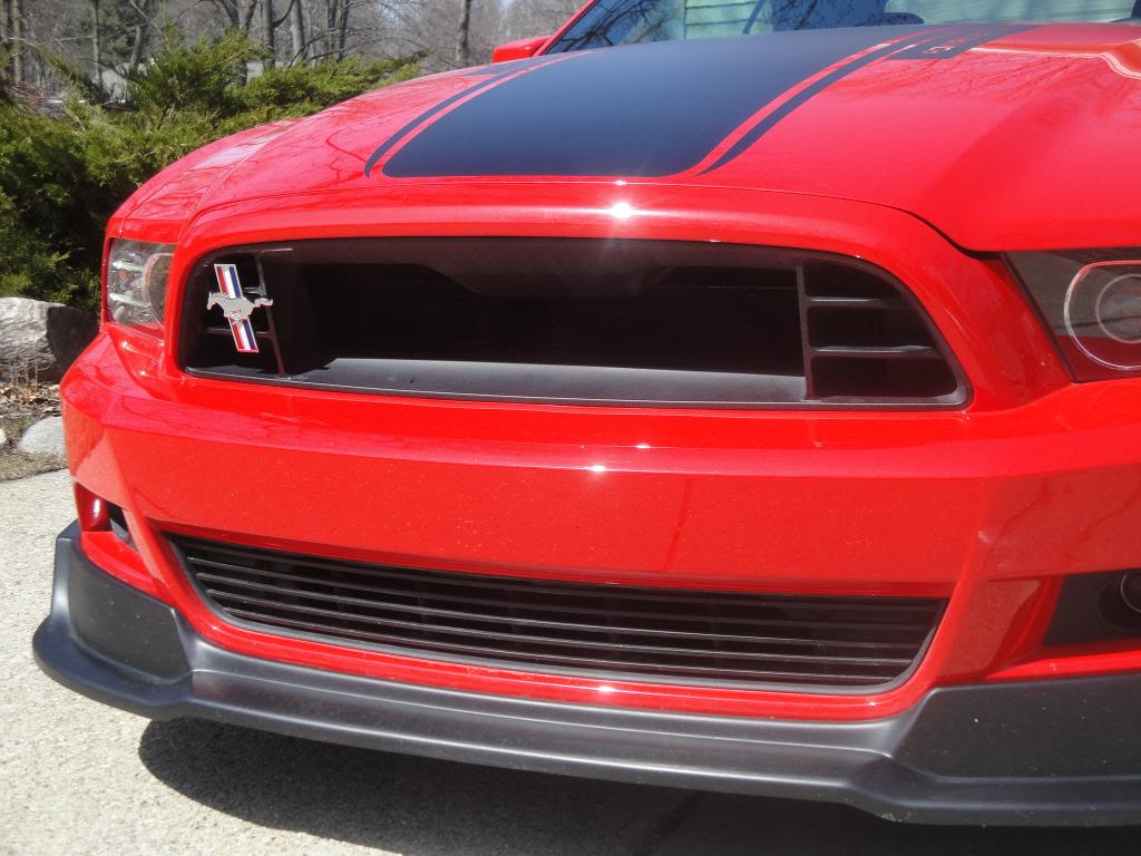

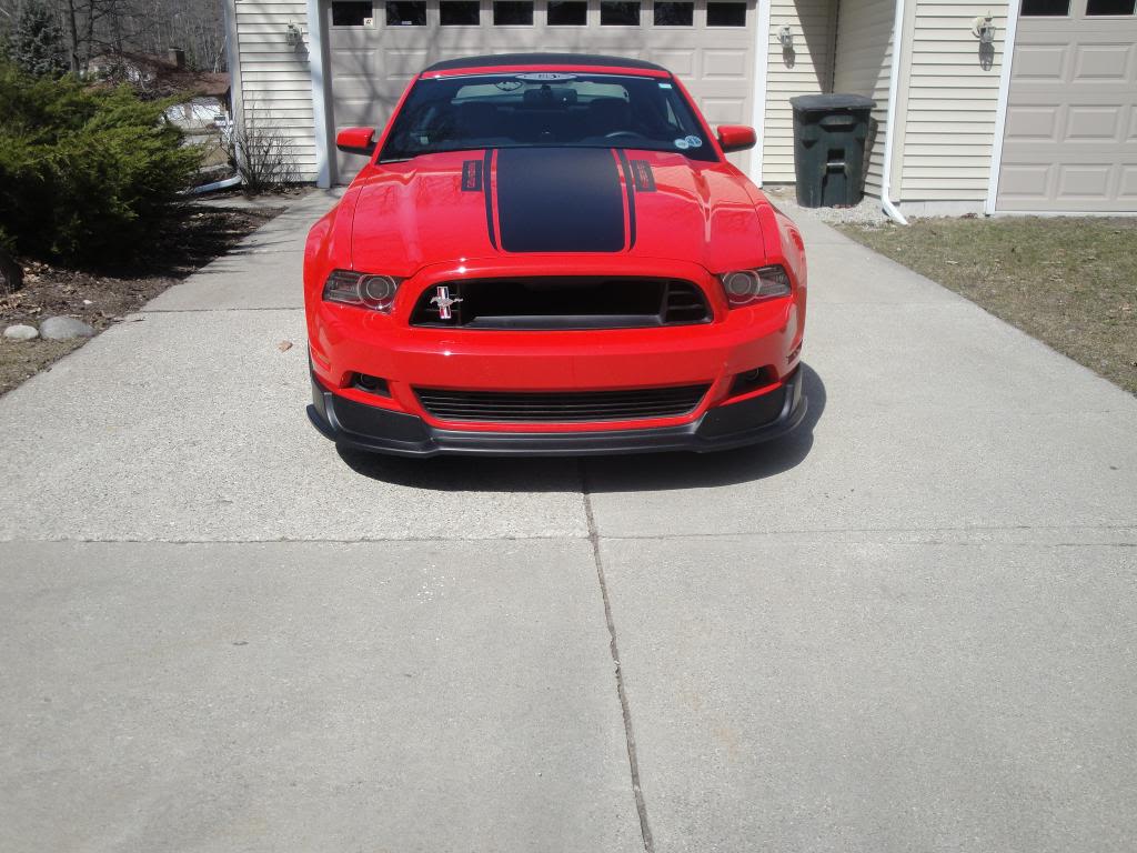

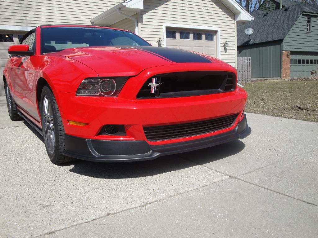

You have to cut the center support, I don't recall any outer support pieces being cut out though.
The grille emblem is something you have to do yourself. Just a small angle bracket held on with 2 sided 3M tape and get your own tri-bar. Use 2 sided tape again to hold it on the bracket. If the tri-bar has pins on it just cut them off and sand it smooth. I used the side tri-bar, but it is a little big and am replacing it with the side tri-bar from a 1998 (some kid broke the tail off my emblem so I needed to replace it).

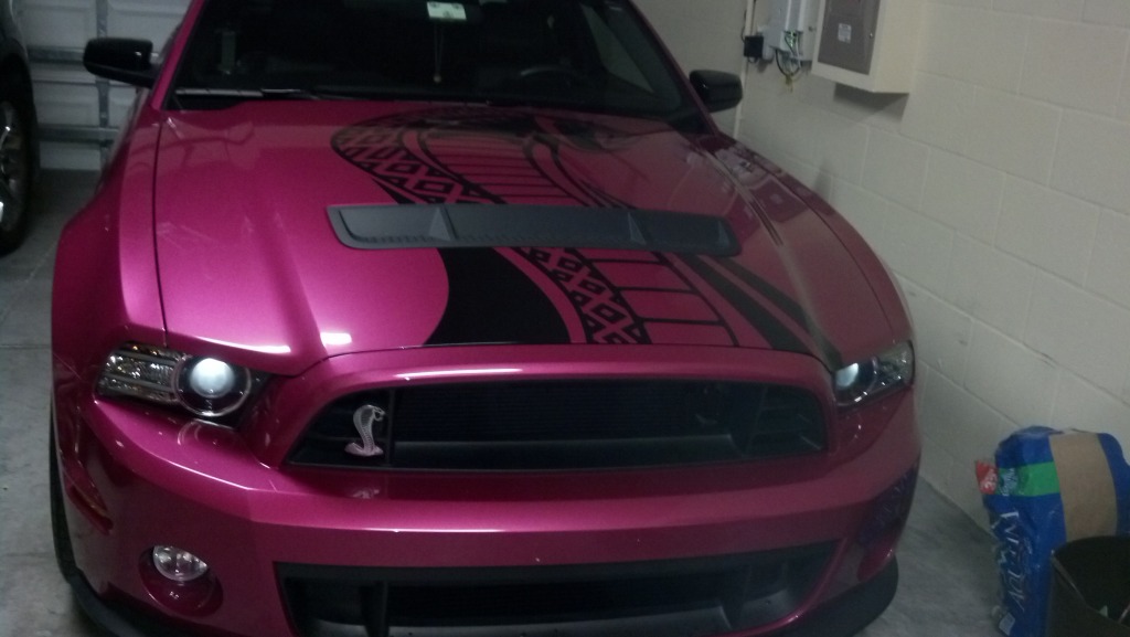

I have that same one on mine!!

Yep! Is that a pink shelby?!?
I love a bad *** fast as hell pink car
Old Jul 22, 2013 | 10:16 PM
MyStang2010GB's Avatar
Posts: 2,586
From: Lithia, FL
It's not really pink, not really purple... its somewhere in between

It is the MCA lower but I sprayed ut with plasti dip because black (like the CS) looks better. I've been looking for a CS lower to swap though

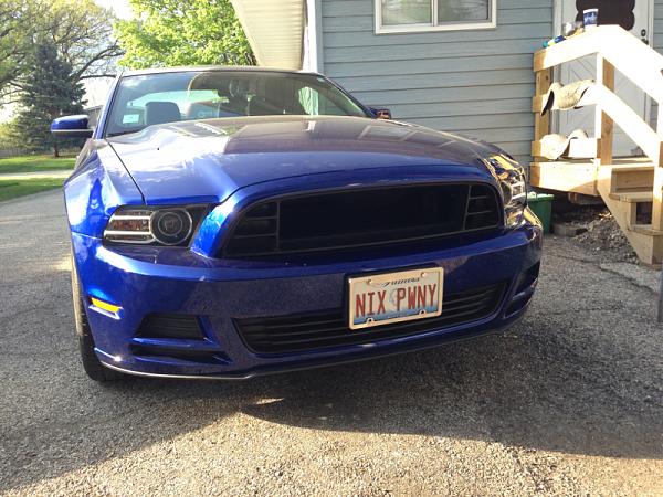

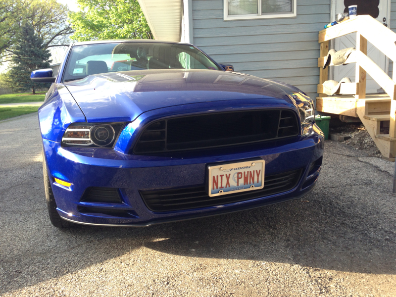

I had to cut out the fog supports and the center. Painted the cooler black as well. And mine is the Roush lower. As for emblem find one you like from any of the companies and stick it on there.
Anybody know where or if you can get the red GT emblem that CDC originally showed it with? I wanted it but couldn't find it on their site anywhere.

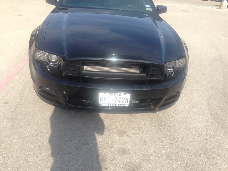

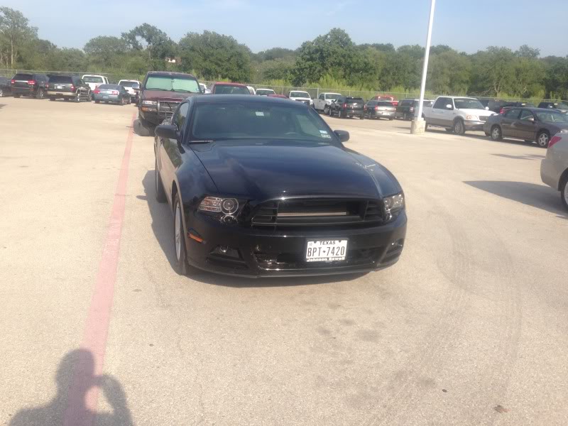

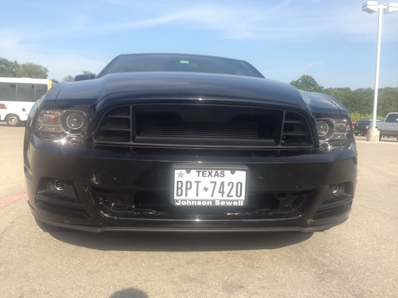

Grill is done! I had to remove the outer brackets which appear to support the GT foglights - I also had to remove the center bracket, I'm not sure what that one does
