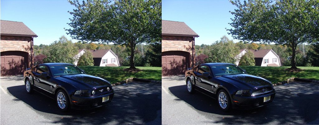

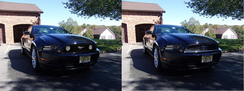

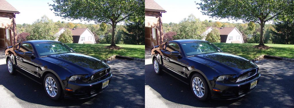

I photoshoped my car with my GT grille on it. Can't decide if it's worth it or not.

I would black it out with the roush grille.

looks like you have the pony package. shouldnt the grille that comes with that be a little different to begin with? I also have a pong package 2013 and was debating the same thing. You can buy 13' GT grilles on ebay from roush for like $300.

Yes, I changed it to the performance package grille. I felt the pony package grille took away from the contour of the grille opening. But I now have the option to upgrade to the GT grille, so that's what I'm doing.

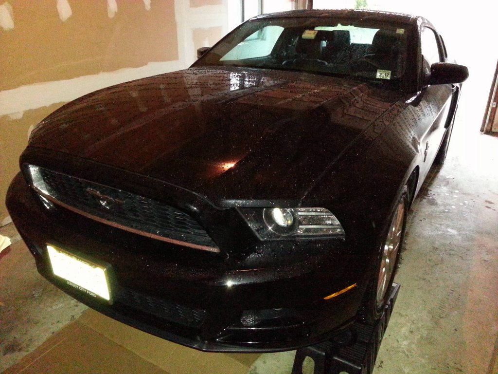

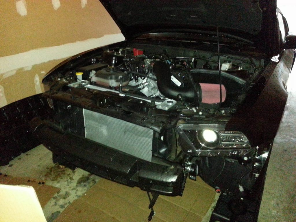

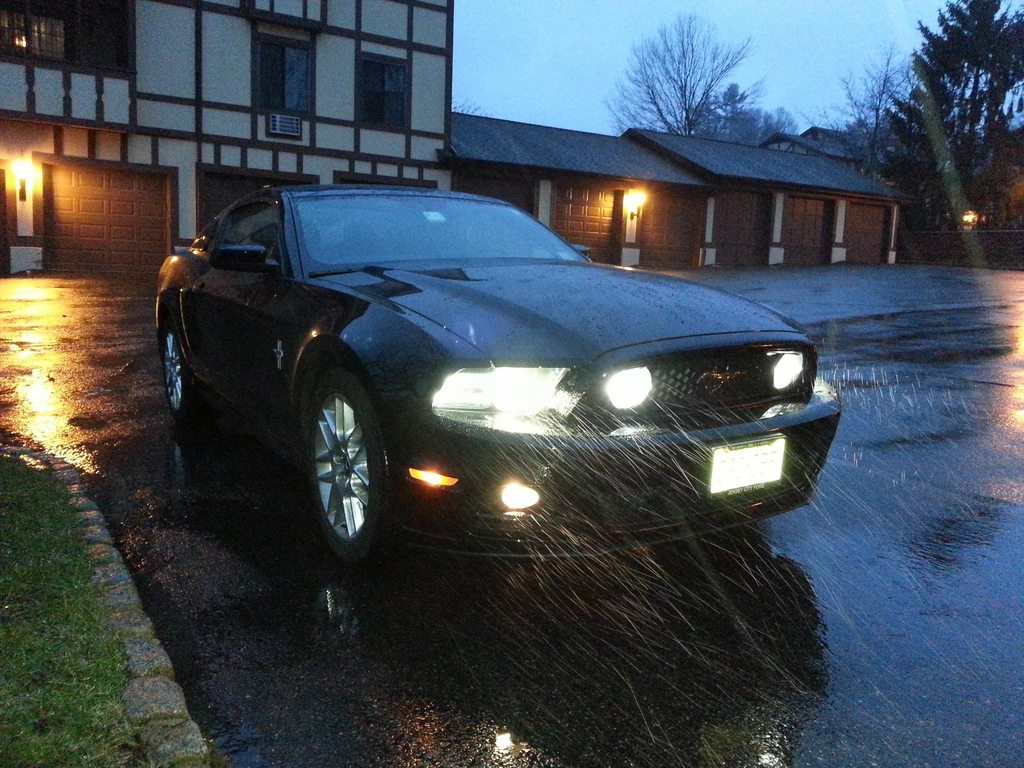

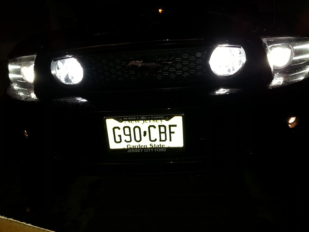

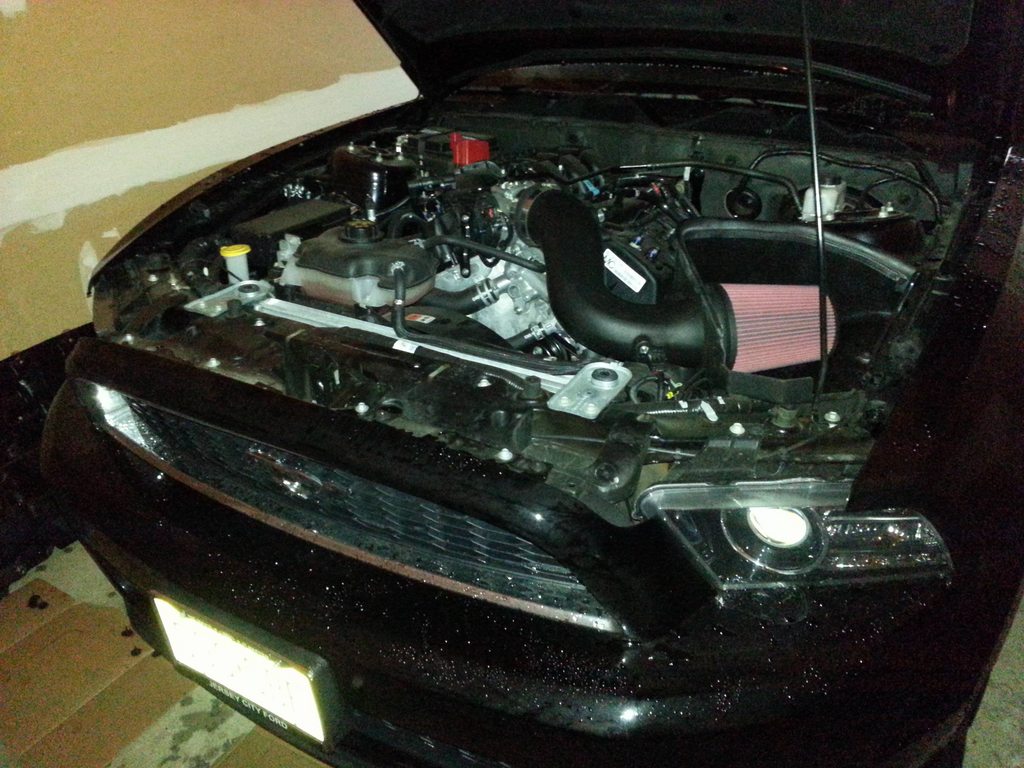

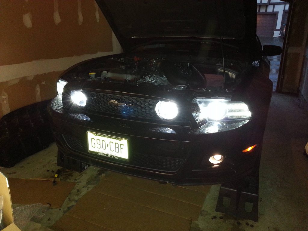

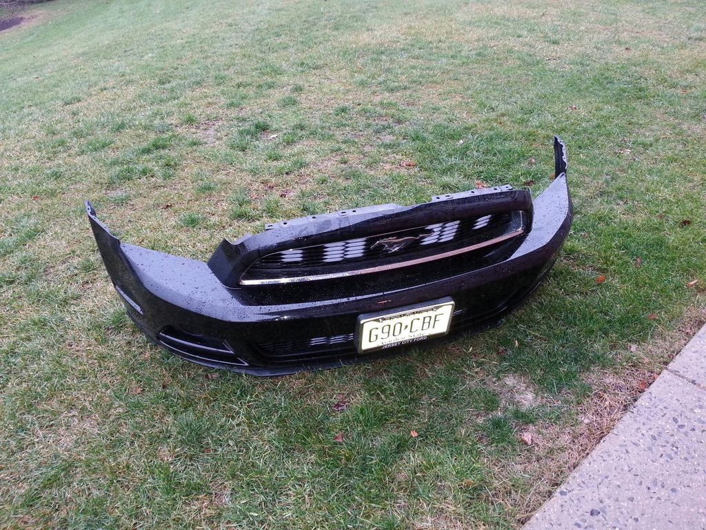

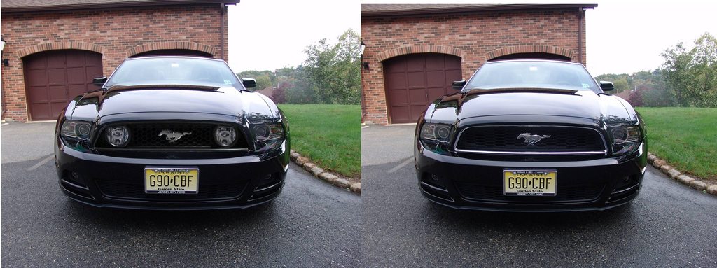

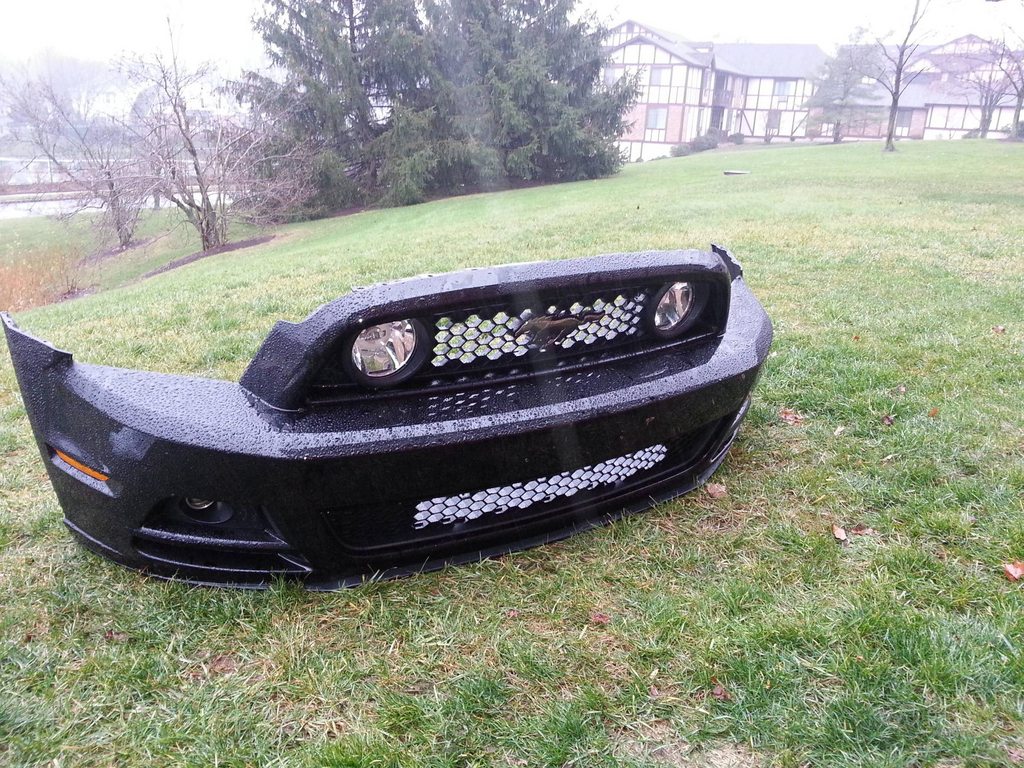

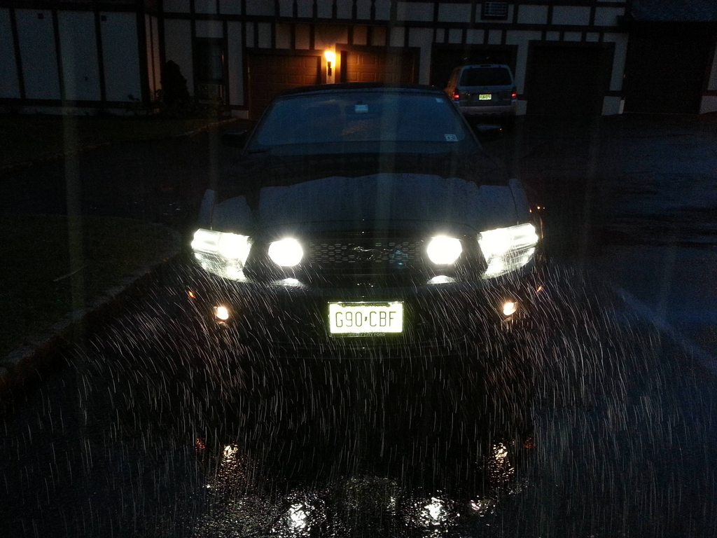

I installed my GT Grille today. It took 3 hours, but it was well worth it!!

Curious as to why you needed to photoshop it to imagine what it would look like. Doesn't it just look like a GT?

Very nice. What harnesses did you need to make all of the lights work together? I want to do that but change the original fogs to 3000k yellow HID's.
Again, VERY nice car you have.

Looks good

Looks great! I also am wondering about the install considering you retained the stock fog lamps. Is it still plug in play, or did you have to splice into it so both the GT and stock fog lamps would work?

After researching this more V6 owners with fogs can get the starkey adapter harness and tap into it to power both sets of lights. Since I am converting my lowers to HID anyway, I am going to use a tap from the starkey harness to the trigger for a relay that will power the HID's. You can also get an H11 harness and tap into starkey harness to power the GT and stock fogs.

Do you have any pictures that aren't in the rain?
EDIT: oh....looks like you sold this one for a GT?
