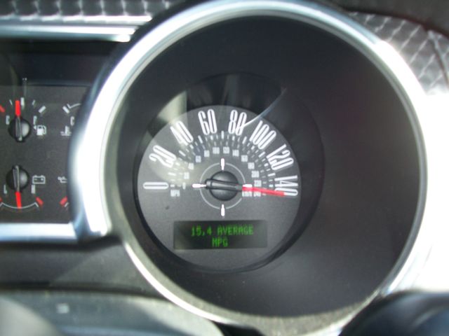

No - its not. But it is speed limited 30mph higher so at least there is factory engineering behind it's increased ability. Rather than "I read that the only reason the V6 is limited is because of the drive shaft!".
Attached Thumbnails Aluminum Driveshaft - How important is it?-bullitt-150mph.jpg
